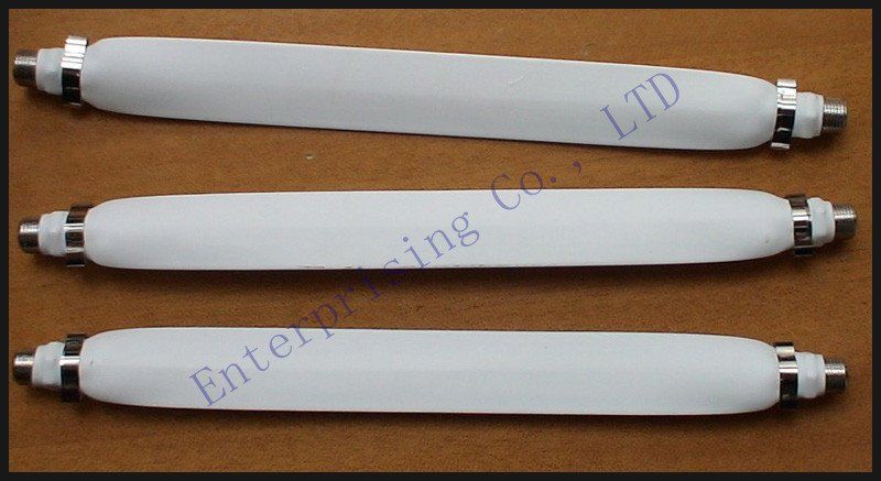

Don't forget about me here I use flat wires in my windows since i live in apartment but not those. I think got flat wires through Davey Wallace those work really well for what I need they are a thicker wire better for doors and windows. Here is a link I have some loss in winter not much it works with all my switches.
Amazon product ASIN B005F0QILU

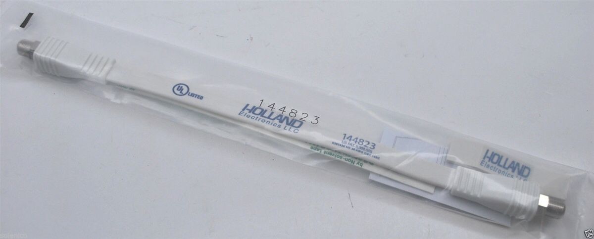

I like and have used the holland 3Ghz model #144823
