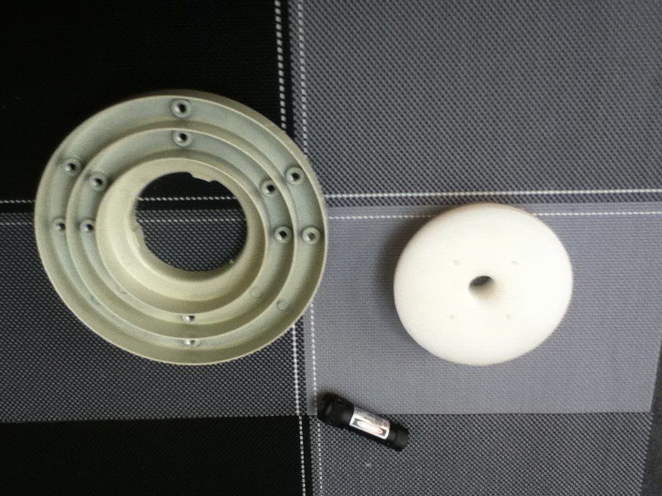

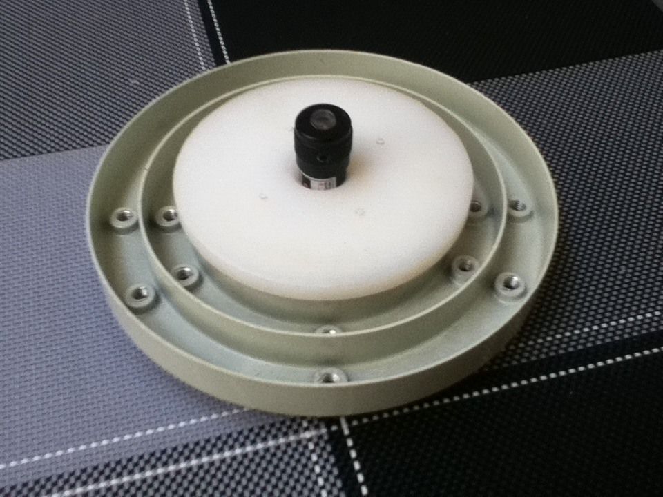

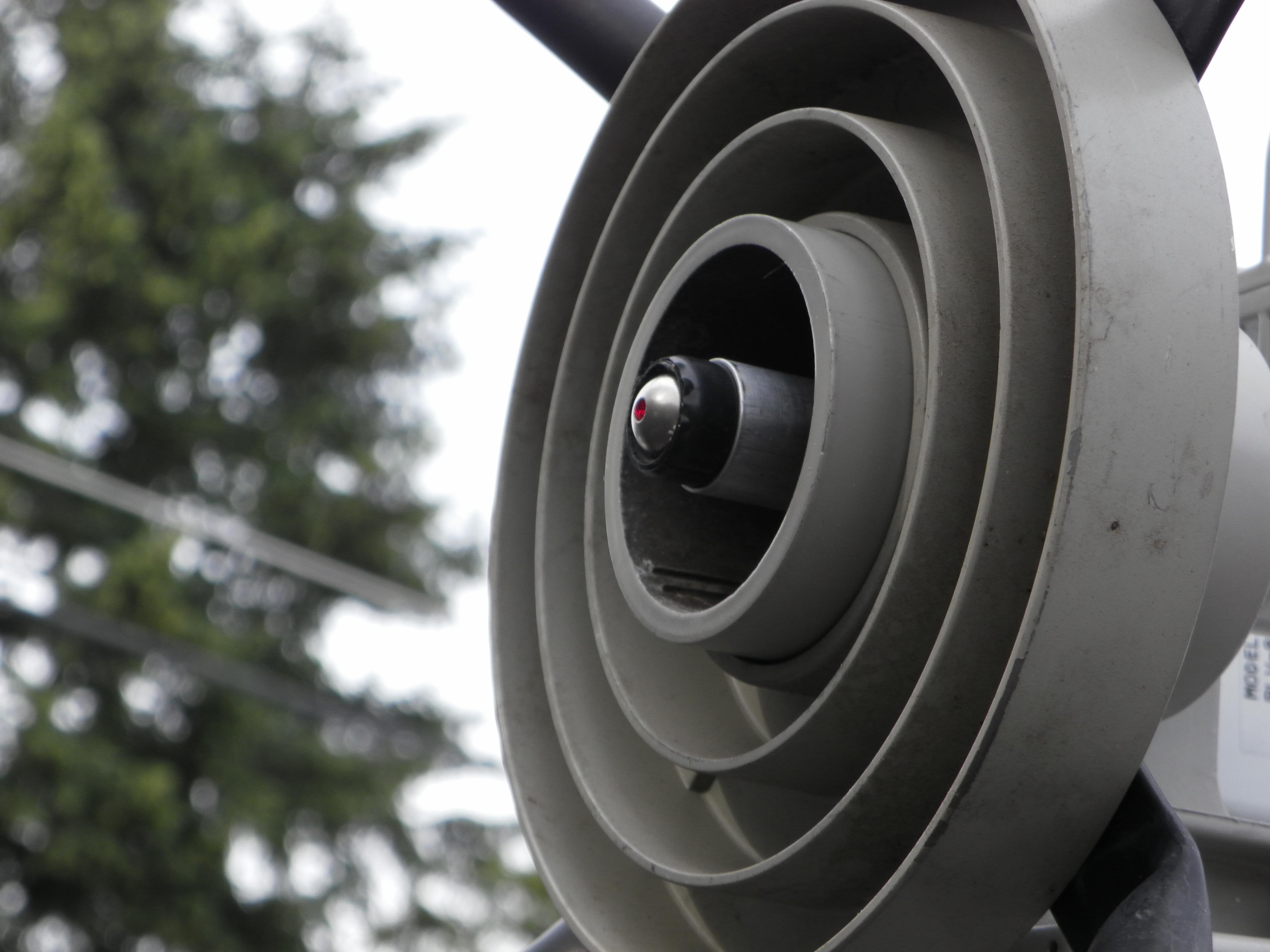

I made a gadget to help align the scalar ring on my BUD. It uses an el cheapo laser gunsight and a piece of plastic machined to fit inside the scalar ring.

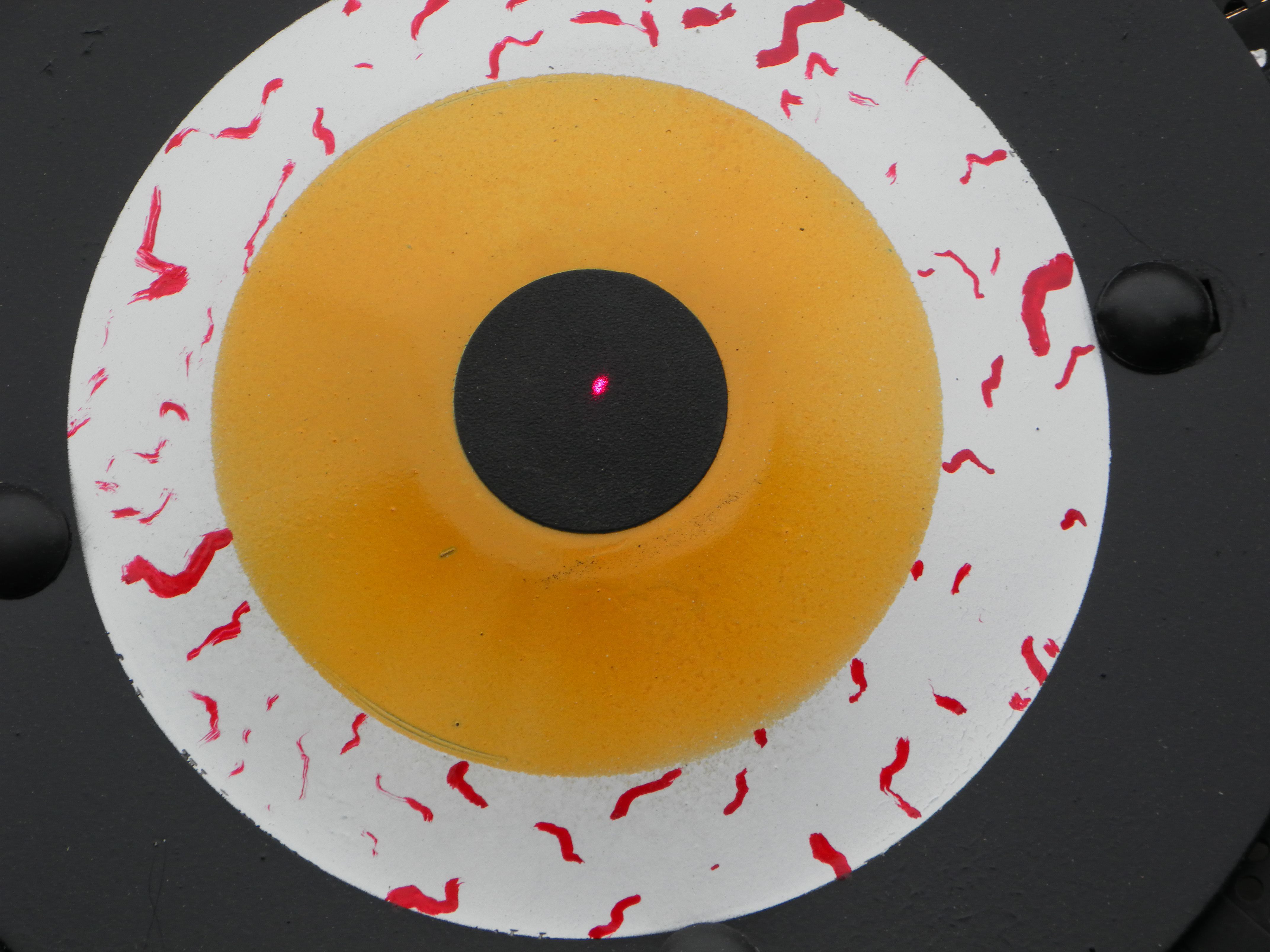

I was off by about 6 inches, making the laser dot just outside the round center plate of the dish. It's about 1 1/2" away from the center now and I am getting signal levels of around 83% on my Openbox S10 on G19. This forum has been a huge help to me during the BUD search/buy/dismantle/drag home/refurbish/install/align process.

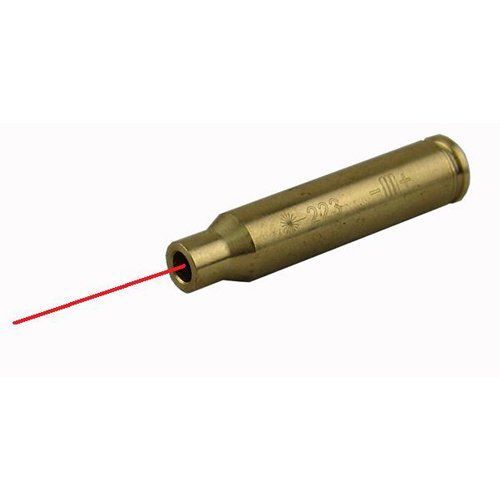

Was thinking about getting this one,
Should be easy enough to build a holder to get it square and centered. Good enough for rifle bores, good enough for me.

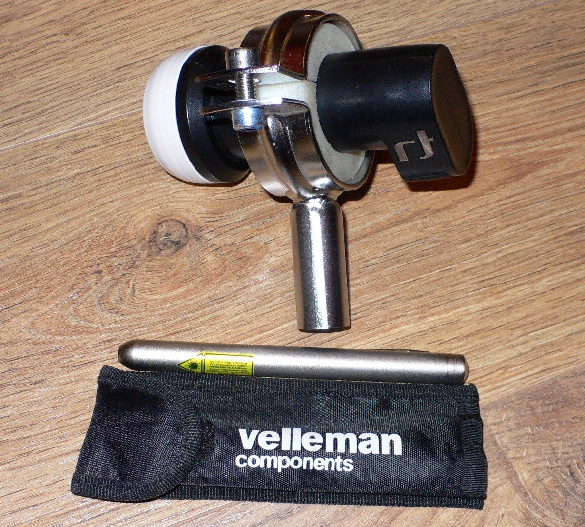

I've been thinking about such a tool as well. I have more or less professional lazer-pointer (at least it coasted much more than rest of them), it has long round body. I would like to make some kind of adapters with inner diameter to tight fit pointer and outer diameter 40mm for Ku-band LNB or 60 (or whatever) for C-band LNB. I have plastic adapters for Ku-band LNB to be fitted in C-band holder. When pointing, better to turn pointer several times and watch how light moving.
That bore sight will be tapered like the chamber of the rifle it's designed to fit in so that may not be a good idea either. :confused: If you can get a straight casing bore sighter like a .444 Marlin or a .45-70 Government round then that might work but the one in the picture is for a tapered chamber rifle.
Damn, I knew I might be outted by a real firearms enthusiast. I shall keep this in mind sir !

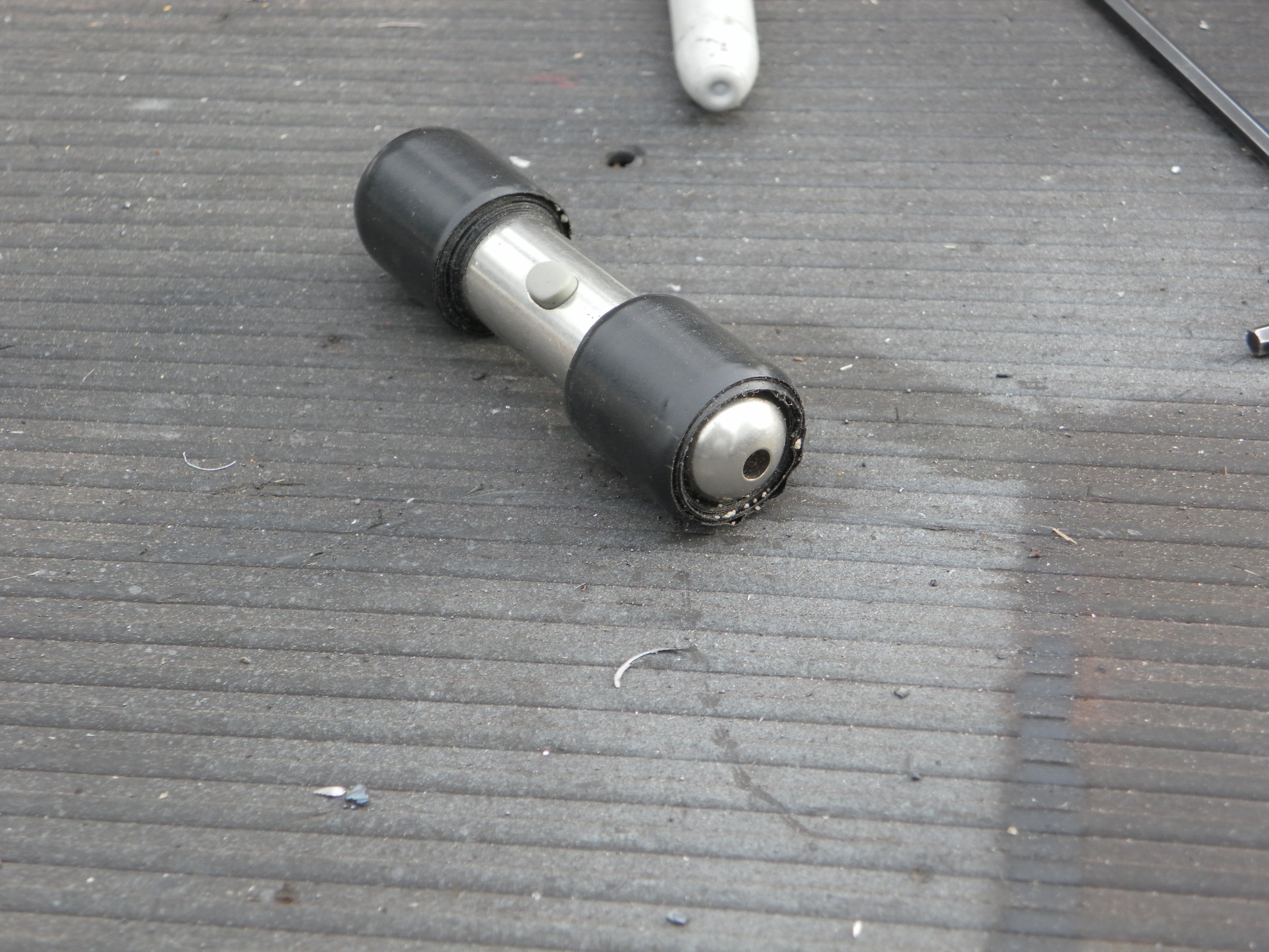

Great idea, think I'll try this. I have a laser that I pulled out of an old spectrograph that is very accurate and not tapered and looks like it may even be the same diameter as the bore in my scalar. Might be what I mess around with this weekend, thanks for posting this, SignalHill.
