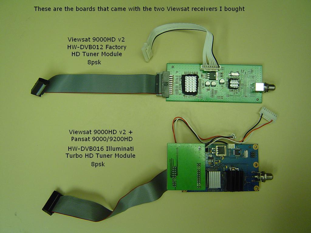

The turbo board is only for DVB-S turbo QPSK (I've read this but haven't confirmed this) and turbo 8PSK.
Factory tuner #1 is DVB-S2 capable but requires hackware to lock a signal and even then won't work with a signal that on another receiver would have the pilot on. This tuner will not lock DVB-S turbo coded FECs.
The factory tuner #2 is DVB-S QPSK only.

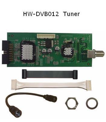

Found some info...
I found some info and photos of the two types of tuner modules used in this Viewsat 9000HD. One receiver I bought had the factory tuner, the other had the Turbo module. Both were described as 8psk modules but I had no idea of the difference. I thought that both were one of the same kind but after searching and finding this info I realized that I had the factory module all along in one of my receivers. I attached pics of the modules illustrated online and a pic of my two modules which I removed from my stb's. My guess must be correct to think that the receiver is crippled without the factory module. From what the descriptions say, it looks like the receiver (without a add-on module) is only capable of MPEG2 and with either module is capable of MPEG4. These are my conclusions and if I'm wrong please let me know.
Here are the specs of each module:
Ref: Factory_Module
Viewsat 9000HD 8PSK Module HW-DVB012 (Factory Tuner)
•Model:HW-DVB012
Name:Viewsat 9000HD 8PSK Module
•The 8psk is the Sub-Board Adapter/8psk Module HD Upgrade Kit. Made in Korea.
•Included is the Q Board, Ribbon Cable, Power Cable and 7 inch RG6 coax cable.
For an upgrade HD Experience, this unit is a must.

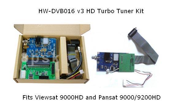

Ref: Illuminati_Turbo_Board
Viewsat 9000HD 8PSK Module HW-DVB016 (Illuminati Turbo Tuner)
Model:HW-DVB016
Name:V3 8PSK MODULE FOR VIEWSAT 9000HD PANSAT 9200HD 9000 HD
Features:
The ILLUMINATI Board Version 3
Works for both the Viewsat 9000HD AND Pansat 9200HD!!!!All units undergo quality control to ensure they are working prior to shipping. Package includes:
Brand New Test ILLUMINATI Board V.3 - Tuner board
2 Ribbon Cables
2 Power Cables - 1 for 9000HD and 1 for 9200HD
1 Interface adapter for 9000HD
1 Foam Piece
1 Coax Cable
EDIT: I will be reinstalling the factory module to test the scanning functions, will report later.
