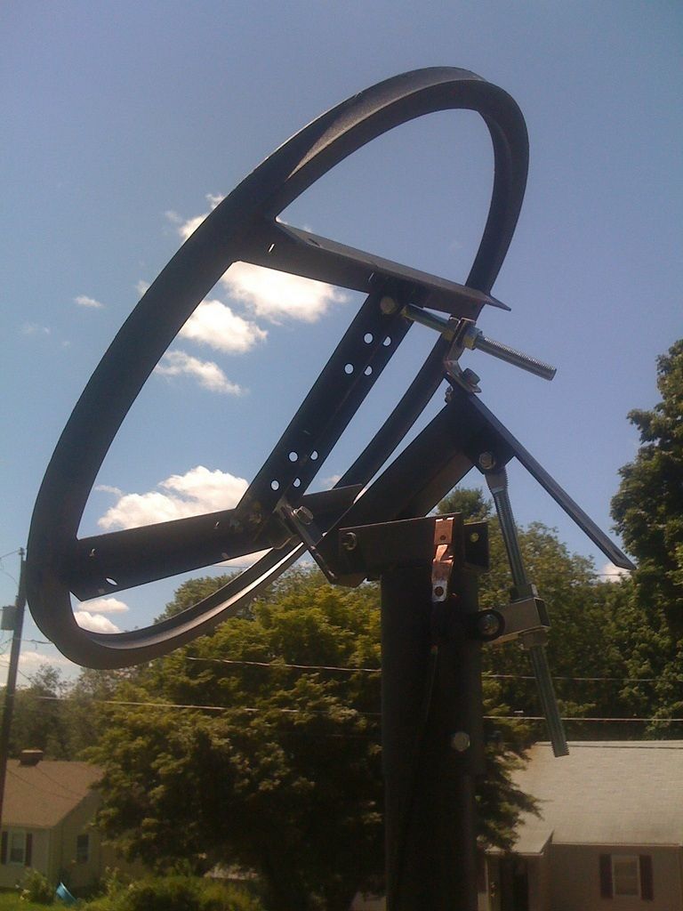

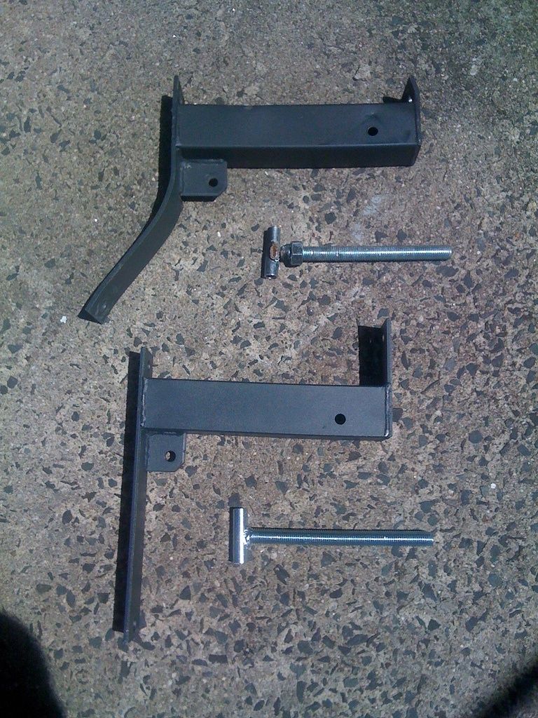

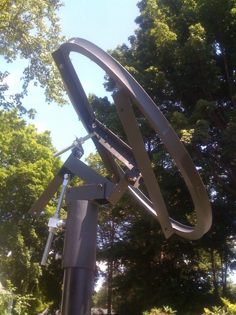

So yesterday we were able to swap out the parts to bad with the new. Photos are below of the broken parts, with the new parts.
We then got the dish on the ground and restrung it to make sure all was good, and indeed all was good.
We then got it back up on the pole and on the advice of a friend restrung it again while on the pole and again all looked good.
I did notice that on the edges where we lifted up from was bent just slightly, the inside of the dish was not bent just the outside lip. When it was hanging it made the dish look like it was out of wack when the inside of the dish was fine.
I worked for awhile to bend the lip back into place so it looked more normal again, it wasnt bent bad at all but just the slight kink in it mad it look bad.

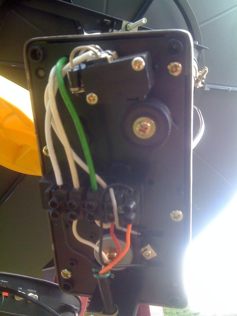

After we got the Dish up we didn't get to aim it as we had other places to be, but I did set the hardware limits on the actuator so that this will not happen again.
Me and my father are getting really good about putting together and putting up C Band dishes. :D
Tonight we will aim it and I will also finish adjusting the actuator accordingly to properly set its limits.
I know you guys love photos.
Photo 1 is the broken parts with the new parts
Photos 2 & 3 are looking at the mount from different directions
Photo 4 is the actuator motor with the hardware limits set.

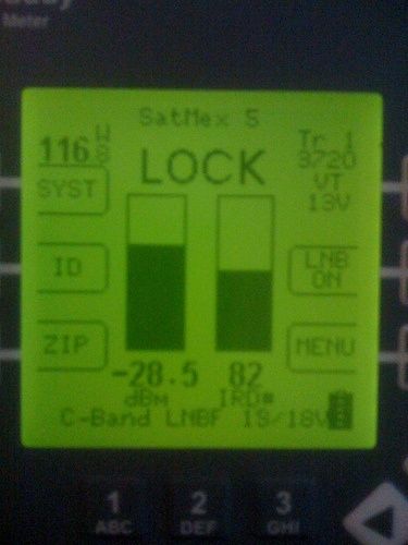

Worked on my Dish and had a friend come over with his spectrum analyzer (Thanks Gary Diamond!) we quickly peaked my Dish and had it tracking the arc on his SA.
After that he had me plug the LNB cable into my Superbuddy and figure out what satellite we were on. We were hitting SatMex5 at 116.8. With that my friend left.

I plugged the meter in to the cable that I plugged the AZBOX into and locked onto SatMex 5.
I moved the Dish around trying to get signal from other satelites I could tell I was hitting other satellites as my DBm was down around 19 but was unable to lock on satellites. So I took the meter and the GBOX outside to the dish.
Again I was able to quickly lock on to Satmex 5. I then moved the dish till my sat beeper beeped and my dBm was low on the sat buddy. I then tried something new and pressed the up button on the satbuddy to try cycleing through transponders. I then locked in a few more birds.
I came in the house and tried the AZBOX again and nothing...
Then got out the old trusty Fortec Mercury II receiver, hooked it up and set it for Satmex 5 and had signal...
So once I had signal I did a power scan of the satellite...
Well what is reporting on the SuperBuddy to be Satmex 5 is actually Galaxy 17 c at 91 degrees!

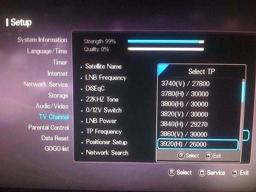

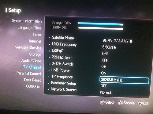

Plugged the AZbox in and am not getting anything...
Strenth is 99% but quality is 0%.
LNB Frequency is set to 5150...
Going to try reflashing the firmware now...

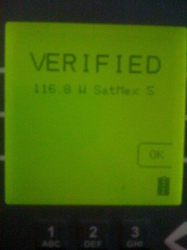

Here are pics of the SuperBuddy telling me I am locked on to SatMex 5 which in reality I am locked on Galaxy 17 C.
I think my AZBOX died. Not getting anything... this is after updating the firmware and doing a factory reset. :(
The signal bar is moving between 80 and 100 depending what transponder its on, however always getting 0% quality.

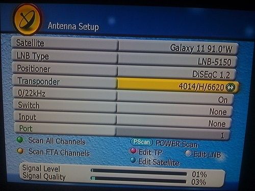

I did a factory reset of the Fortec Box (I wanted to clear the lists of motor positions and channel charts) and now I am get 0% on both Quality and Signal on C Band
I hook it back up to the SuperBuddy and am told I am on SatMex 5 with a strong 80 signal quality.
I hooked up my other FTA dish which is KU and am able to see signal from that.
I also hooked up that dish to the AZ box and that is also seeing ku signal.
Only thing left is the LNB itself, but why was it picking up signal before the factory reset but not after. (And the SuperBuddy is still seeing the signal as well)
On both receivers not seeing any C Band now. But again hook it up to the Superbuddy and have an 80 signal on the same transponder.
I dont get it.
