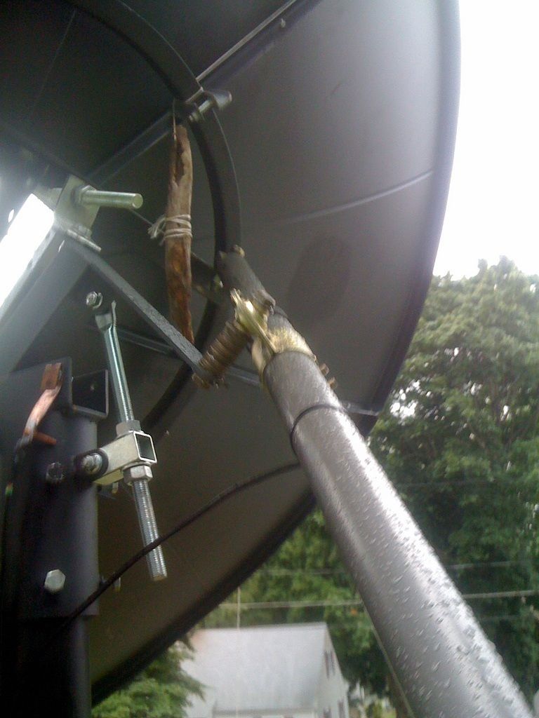

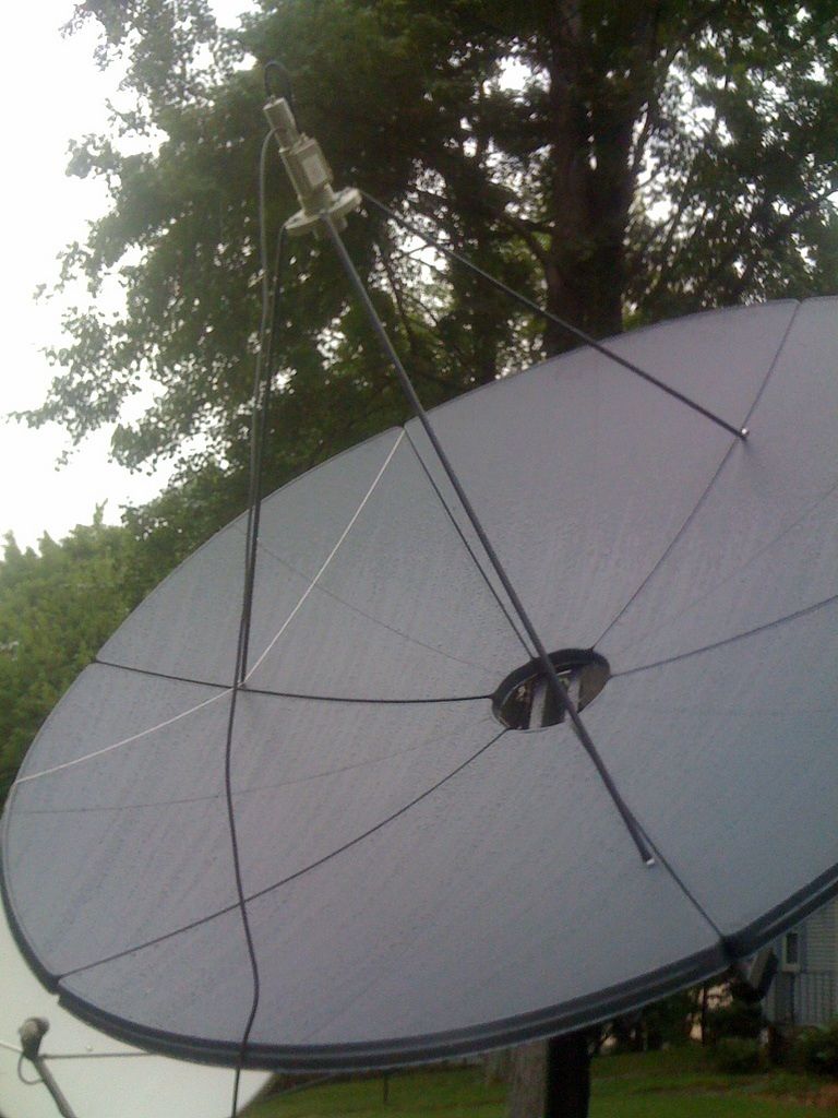

Here are pictures of the dish as of this morning.
Notice the actuator arm that Gary fixed. :)

Why is port 1 shown in image 3 if no switch is enabled?
What is odd is in the pic of the super buddy it says "TP 1 3720 V" 13 volts
3720 on G17 which is CW is 3720 H polarity
you sure the LNB isnt off by 90 degrees???
Its possible.
The 0 on the back of the LNB is pointed to 9 o'clock. See my pics from this morning which shows how the LNB is in there.

I noticed when hoooking my LNB up to my cband dish that i had to set it 90 degrees other than what the manual said. I have one of the WSI's, and had the arrow pointing up.. For some reason it was doing what scotts is doing. Thus a twist 90 degrees fixed things. My arrow now points to the left at 9.
Its possible.

I think Iceberg might have nailed it... (Just thinking about it... at work still so havent tried it yet)
But it makes sense why the SuperBuddy was IDing it as Satmex5 as that transponder was correct for Satmex 5 with the polarities REVERSED.
This would also be why I was able to tune into the satellite on the fortec but not the AZBOX. On the fortec it had SatMex5 and a bunch of transponders. On the AZBOX I punched in the transponder and SR stuff from by using TheList and double checking things on Lyngsat.
After I factory reset the Fortec box, I tried retuning it in on the Galaxy 17 satellite, NOT the SatMex 5 satellite. I am now sure if I would have tuned into the SatMex satellite again on the Fortec box I would have gotten the signal!
It could also explain why I was only getting half the transponders on G17 as one of the other members pointed out.
Good catch Iceberg, THANK YOU! I was pulling my hair out last night!

Scott, glad you found the problem, before Iceburg said the polarity problem, I was going to say the same thing since when I installed my new LNBF, I had the same problem, I installed it 90 degrees off and could not get quality, but had plenty of signal.

my GeoSatPro C2 are like that....all are set at 9:00 for 0 skew
you just lucked out on having a transponder that is the same frequency but opposite polarity on a different satellite

just turn it 90 degrees and see what happens. Also it looks like the LNB is pushed in pretty far towards the dish. If that gives you maximum signal then great. But I know my 621 was almost flush with the rings or maybe 3/4" towards the dish in.
