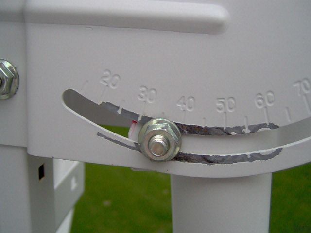

Another question. When I go to set my elevation at 44 degrees do I just loosen the screws and tilt the dish until the stabilizer plate is in line with the 44 degree mark on it? Or does the signal come in at a higher elevation into the dish which would mean I'd have to set the numerical value on the dish holder to something lower like 20 or so?

no. If your elevation is 44 that is what the dish is set at.
Make sure to use the edge (where the elevation red line is). Match it up with the elevation
see attached picture...This is my fixed dish at G10. Elevation is 29 1/2 or so :)

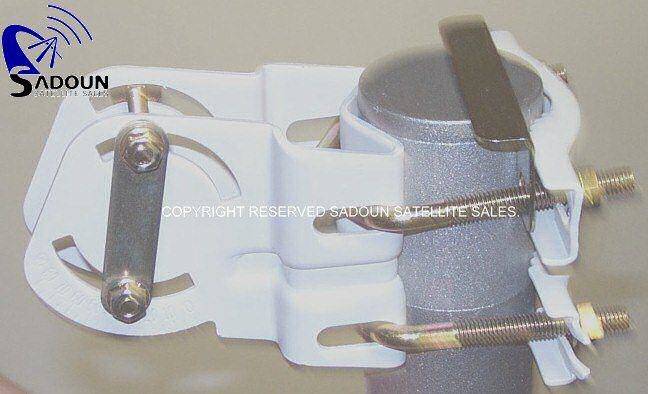

I seem to have a different kind of mount. I've attached a pic from the website. Do I use that bronze colored stabilizer plate to align at the right elevation? And also do I align with the front of the bronze thing (the side closer to the dish) or the back (the side closer to the pole)?

Mr Tony
Nov 17, 2003
443
179
Mankato, MN
oh I noticed you have the UNiversal mount...then you like the centre of the bolt up to the elevation markings
(I always understood it as if there was no "edge" then use the centre of the bolt
