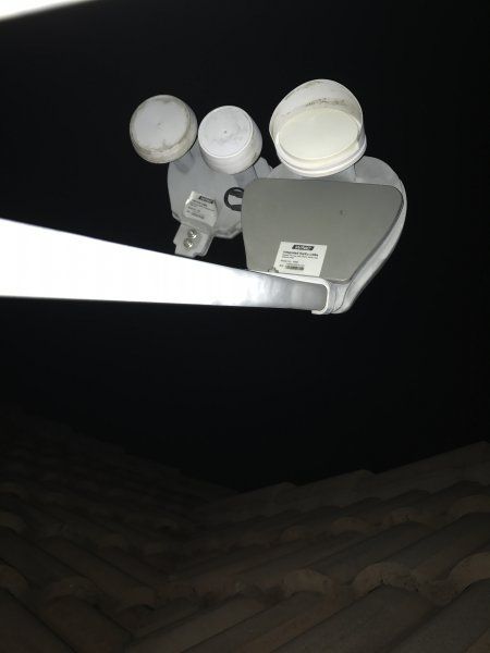

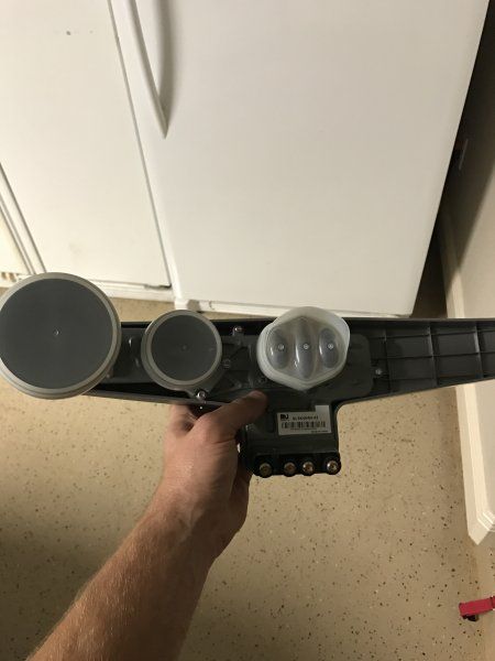

ok another problem-- I wanted a temp fix before I decided to go the 4K rout and I just wanted to switch up my LNB to get things working again.... so I bought the following..
I tried to replace my LNB
But when I rebooted the first HDDVR it and it went to the communicating with satellite it was at 0% and a 771 popped up?
I put the old one back on and it is working for most stations, but still getting a 771 occasionally on some channels?
did I get the wrong LNB???

You don't have the correct dish for that 5LNB unit. You have the old style AU9 ( sidecar) dish. Don't know if you can still get LNB's for those dishes. AT&T will install a new slimline dish with an LNB unit with SWM built into it. It will support 13 tuners, or up to 21 with the correct receiver configuration. No one is sure , yet what that means. If your dish is locaed where AT&T can reach it without leaving a ladder, they generally can replace your dish with no problem. Your old style dish raises questions about the mounting being able to support a modern dish or having to be replaced. If your current dish is not easily accessible from a ladder (meaning the tech does not have to get off the ladder) then moving the dish to a new location, possibley mounted on a pole in the yard, is the next best option.
Oh the classic sidecar dish. You need an upgrade my friend. That dish hasn't been installed in nearly 10 years, I know why the tech didn't want to go up there now. He didn't want to replace that dish
Now I know what you were asking about! :) I didn't see the pictures you posted. Sorry about that Brad. Like b52pooh and Hutch1814 said, the dish has to be replaced, it's quite old. You definitely need to have Directv come out to do this work.
