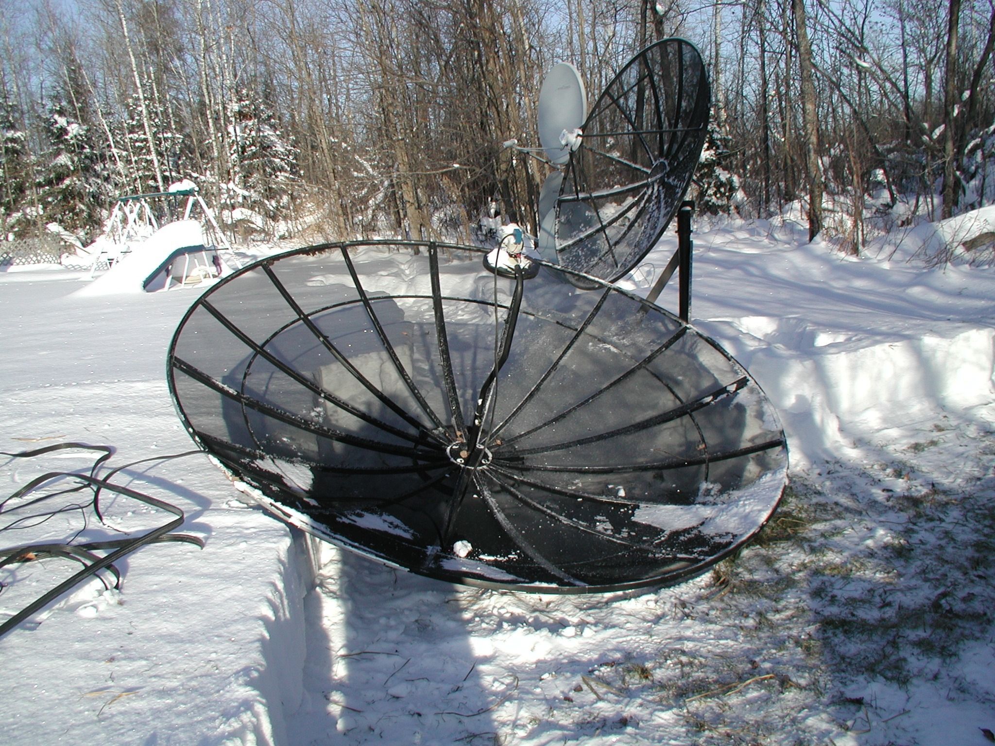

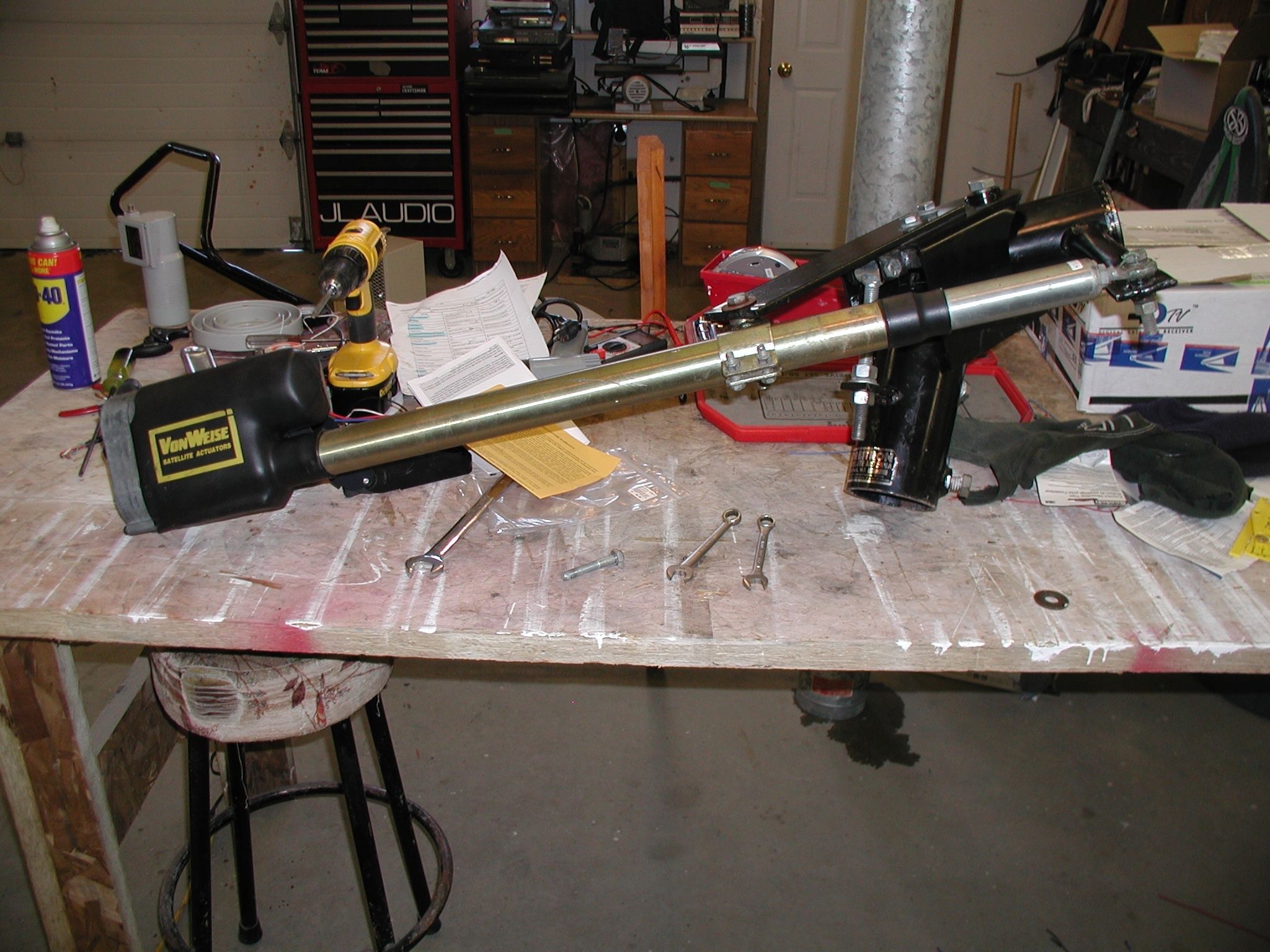

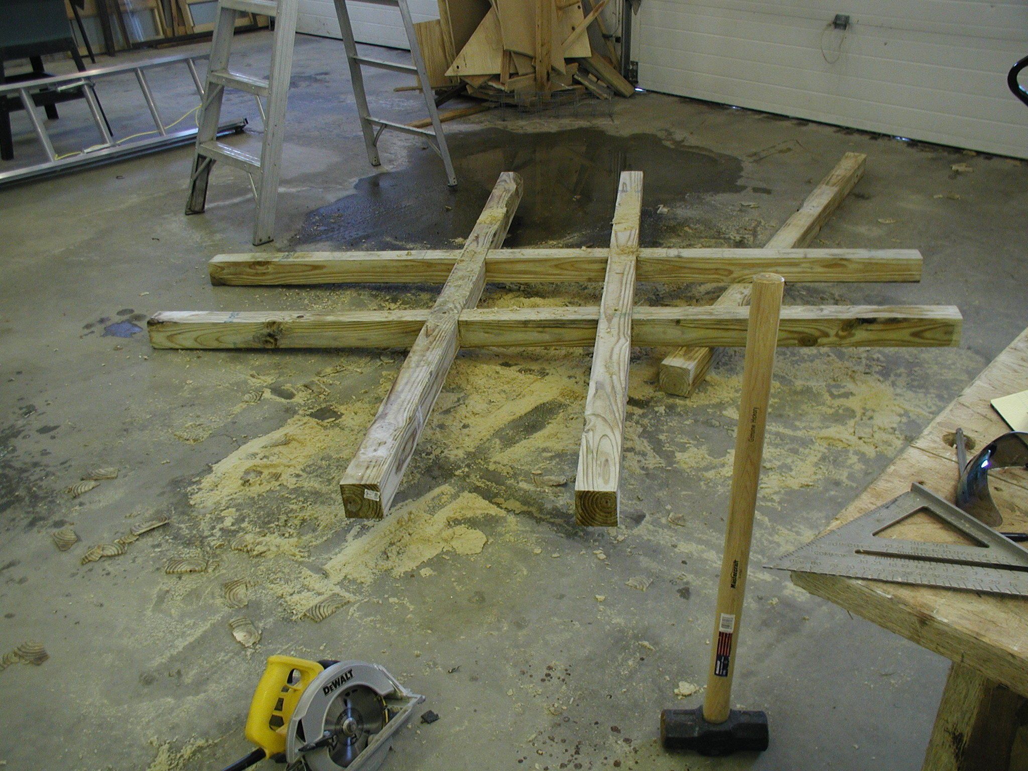

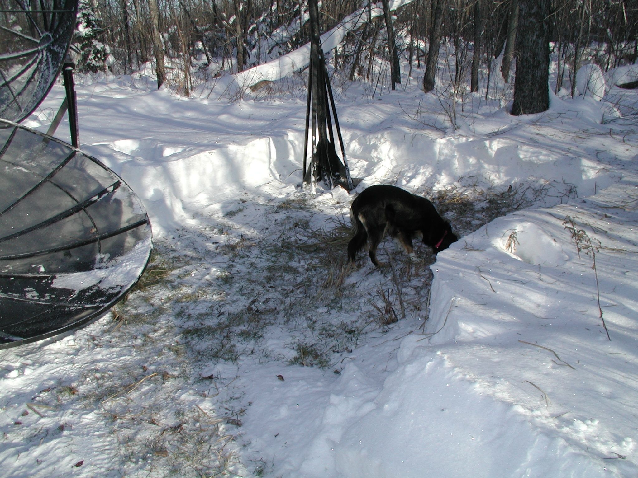

Here's a few from today. Pretty self explanatory.
I'll get some more if I'm home during daylight hours of the finished mount with the dish on it.

It seems to have worked pretty well, it's 4 4x4x8 posts criss crossed......actually I have a picture of that, just have to get it from the camera.
Don't think I have any of the post mounted to it but I can't be sure.

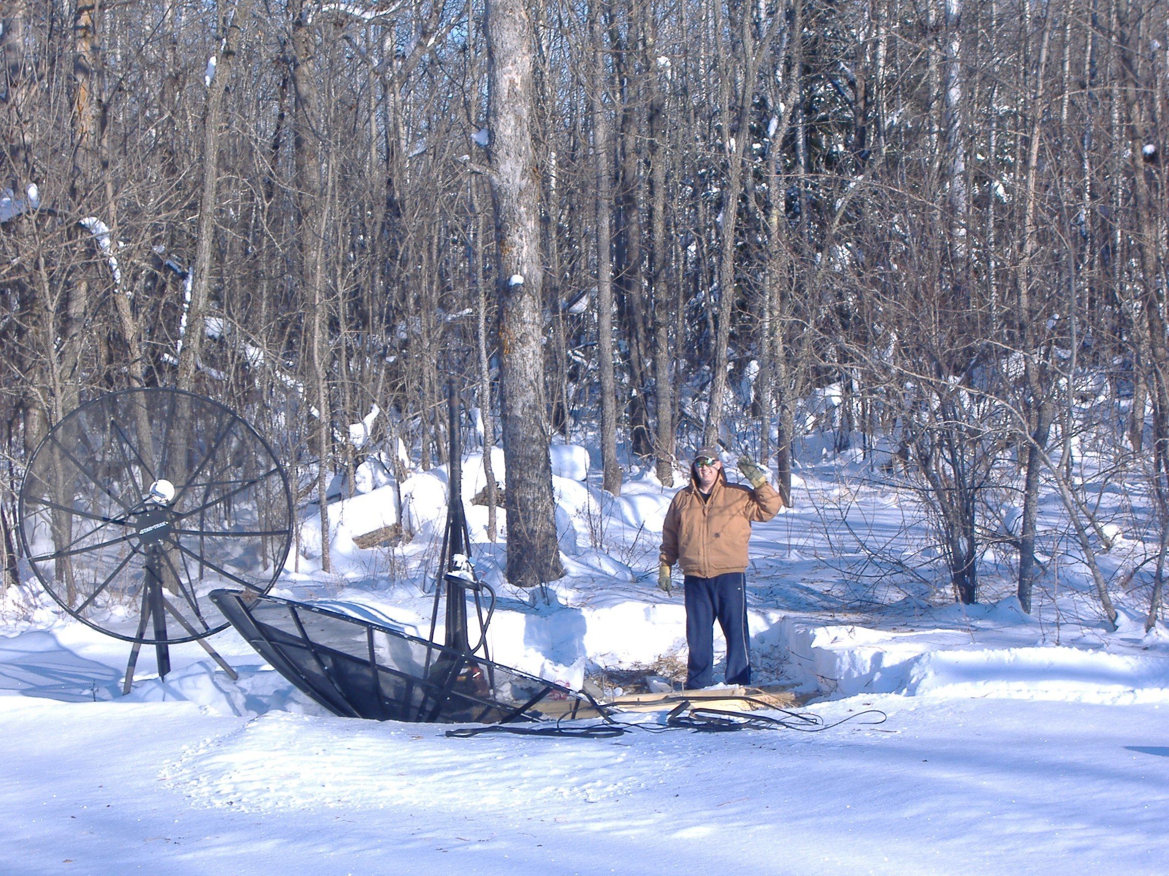

Here's one of the pics she took while I was working on it. It doesn't show the mount so I'll have to get some at a later time.

And what's more, it prompted me to install the motorized 10' dish I've been sitting on.........so FTA will be that much sweeter as a result. Planning to put a C/Ku feed on it but that might just have to wait 'till spring.

I may pick up some actuator cable today and perhaps hook that up this evening........it'll be much easier to do that than keep running back and forth from the house to the dish.......especially with the temps we're supposed to get tonight........-31F........that's a definite BRRRRRR............
Actuator lock up?
Anyone know how to lube this?
