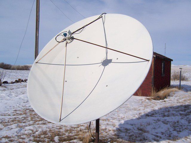

I have a prosat 118 mover. It's working fine.
8' solid spun al dish can't find maker marks
Anyone know how to take the mover apart for lubrication?
Perhaps you would be kind enough to start another thread, with a few pictures of that dish.
Maybe the guys could identify it... or at least come up with some possibilities.

The dish is a 8' spun aluminum solid parabola. Painted white and has 4
mounting arms. The scalar horn is fairly high above the dish.

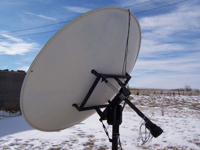

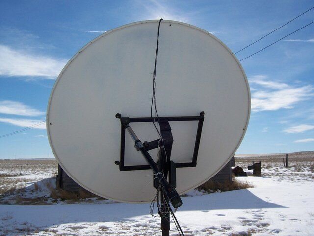

mini-100_1009.JPGOk let me give this a try.
Hopefully this works.
Good looking dish! You can take the motor off, undo that bolt that holds the tube into the motor , twist it little then and just pull, it will slide right out. Then you can see what holds it in. I have one with no grease fitting either, usually I just run the motor until its fully extended, move the rubber sleeve out a little and just wipe some grease on the outer tube. That prob doesn't help the actual screw much though. I try to keep one spare around just in case they break down.
