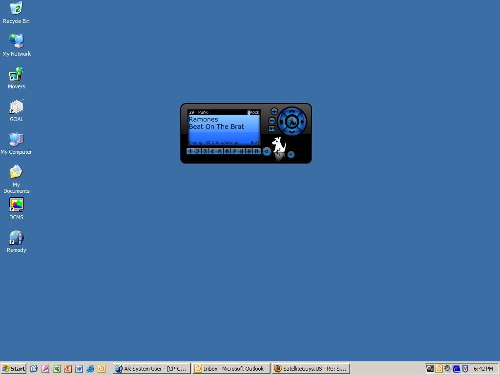

Have you updated to the latest versions of both items? I am running Sirius via Yahoo Widget right now and every day. Hope this helps.
Yahoo Widgets v4.05.184
Sirius Tuner Widget v2.1.5 (do not use other company releases)
Found here: Welcome to neoscrib.com

No luck. Still getting login failed.
(with the versions you cite above, 2.1.5 of the Sirius widget, and 4.05.184 of the engine).
