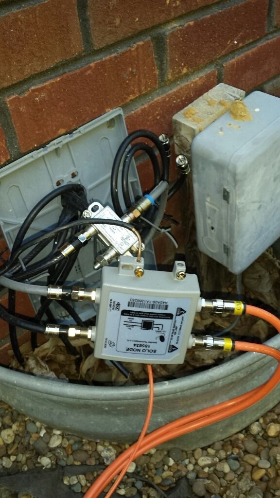

My connections ( you can't see the splitter for the joeys under the house but it's there, the tap seems to have a capped end for what I can figure is a third joey.)

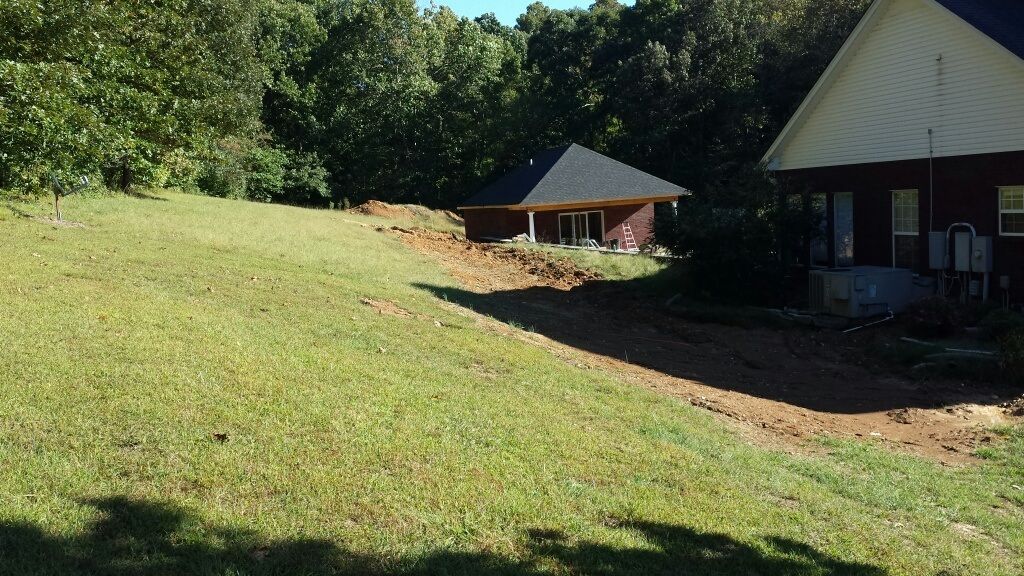

Here is the pic from the side of the house to to the pool house + satellite etc.

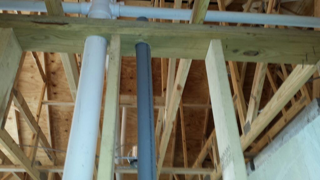

a Pic of the coduit coming into the pool house (2'' and it will share ethernet cable)
Running coax and ethernet together isn't recommended but in most cases interference is minimal. I can't recommend running it next to live phone line though.
As far as a benefit of the splitter before or after on paper it shouldn't make a differences though going 180ft you node may have some issues seeing the joeys due to db gain. I would try the splitter close to the joeys first but if it fails then run that second line. If this is an issues where you only have one chance then running two may save you some issues.
Also as a side not. Until you add that third joey. Remove the tap. Again for long cable runs eliminating any cable or connections anywhere in the system can help
If it is going to cost you the same then I would strongly consider the rg11 cable simply because it is such a long run.. Though one note of caution if you ever have issues most satellite techs don't have the equipment to work with rg11. Solid copper rg6 may be a better option. The benefit's of less db gain may be worth it though
Sent from my Nexus 7 using Tapatalk 4
I did say earlier, joeys up to 300ft away from hopper. We have been gettimg reports of issues with joeys over 200ft away, but it all depends on the amount of resistance from distance and extra parts in the lines. Problem is that you won't know until it's installed because the hopper is the only thing that can test the quality of the Moca connection to the joeys.
