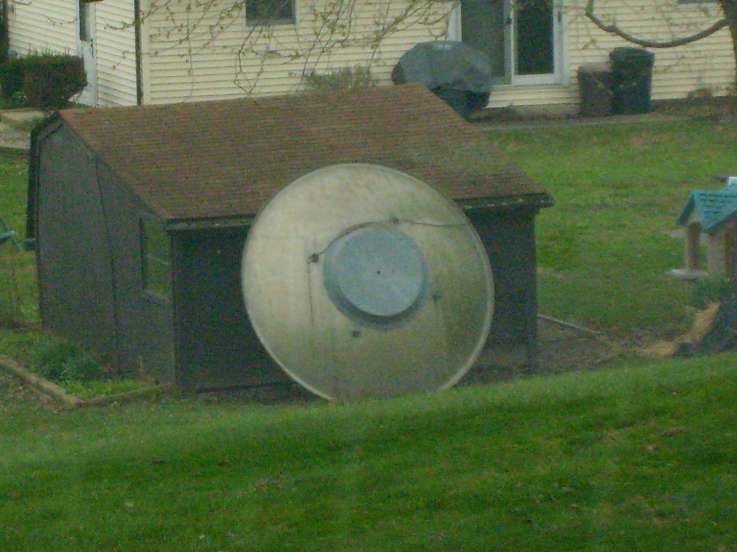

3rd dish find from last week is mine! Anole, looks like the spun aluminum one is mine as well! I just came back from town and bumped into the guy that owns this dish! He said that it was mine if I wanted it. He told me that it had a hand crank :eek:, but he said that everything for it is in the garage right down to the receiver, LNB arms and all the trimmings! I guess if it could be hand cranked it does have some kind of polar mount on it. Wonder if it can be outfitted with a Actuator of some sort?
It was too dark to go down and look at it though so I will get a good look at it soon with pictures! He said it was his dad's old system and it has been propped on the old out shed for a number of years! Great find! I have been looking at this possible grab for the last year or so, never could find anyone home when I did stop to ask. Fate I would say since Saturday I posted the pictures of it and tonight I run into the guy! The guy said that they been wanting to get rid of it for years.
Then he just gives the thing away! The dude has no idea how big it is and is illiterate with satellite stuff. I will take time out of my day in the morning to see the goodies that is with it and a tape measure for sure! Will keep you guys posted! :up

On your next post, get us some pix of the accessories.
Perhaps you can find a name plate on it.
Also, throw a tape across the dish so we know the actual size.
You might give it the string test.
Just to make sure standing up all those years didn't deform it.
Looks like a winner to me. :D

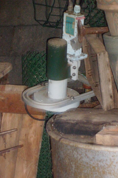

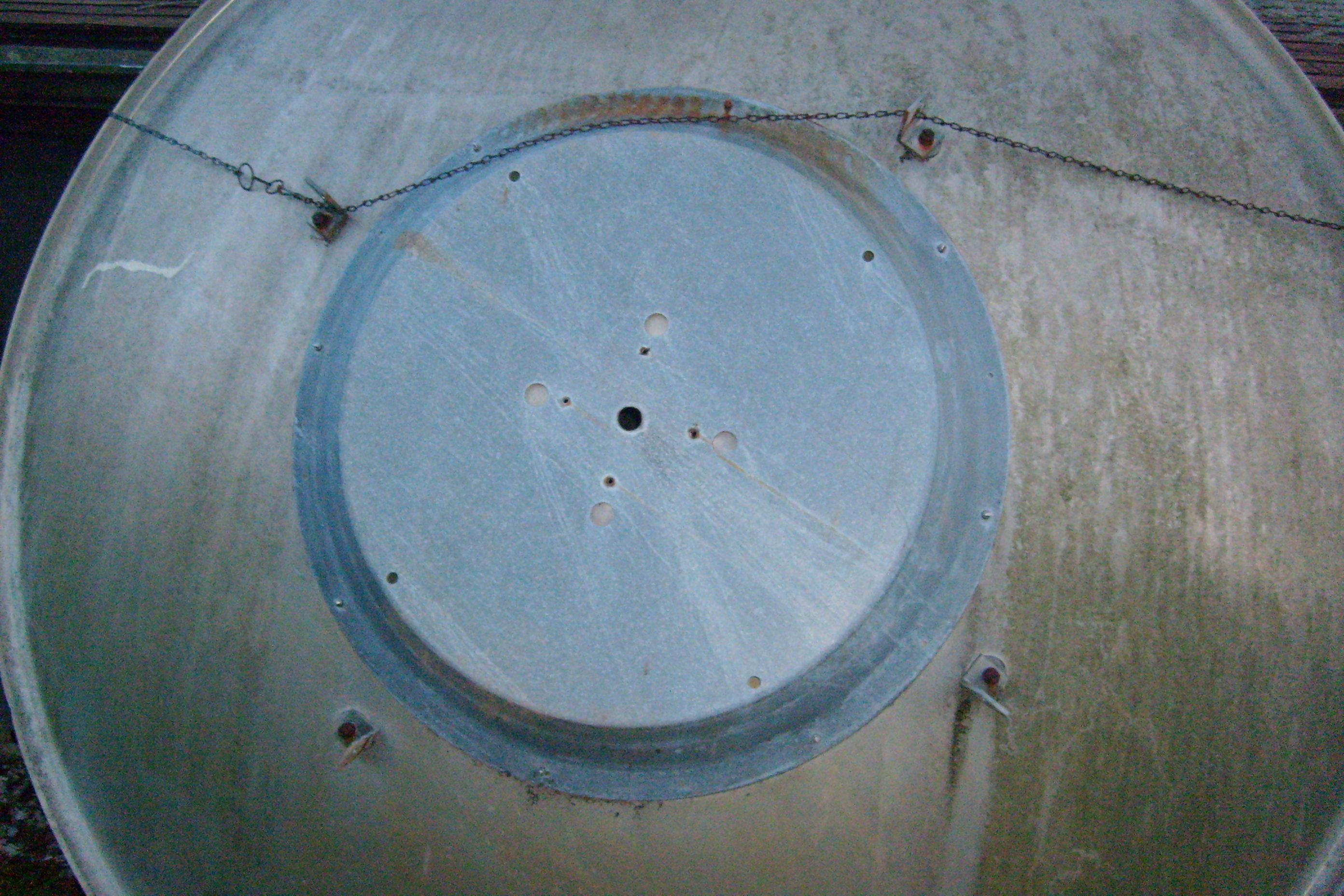

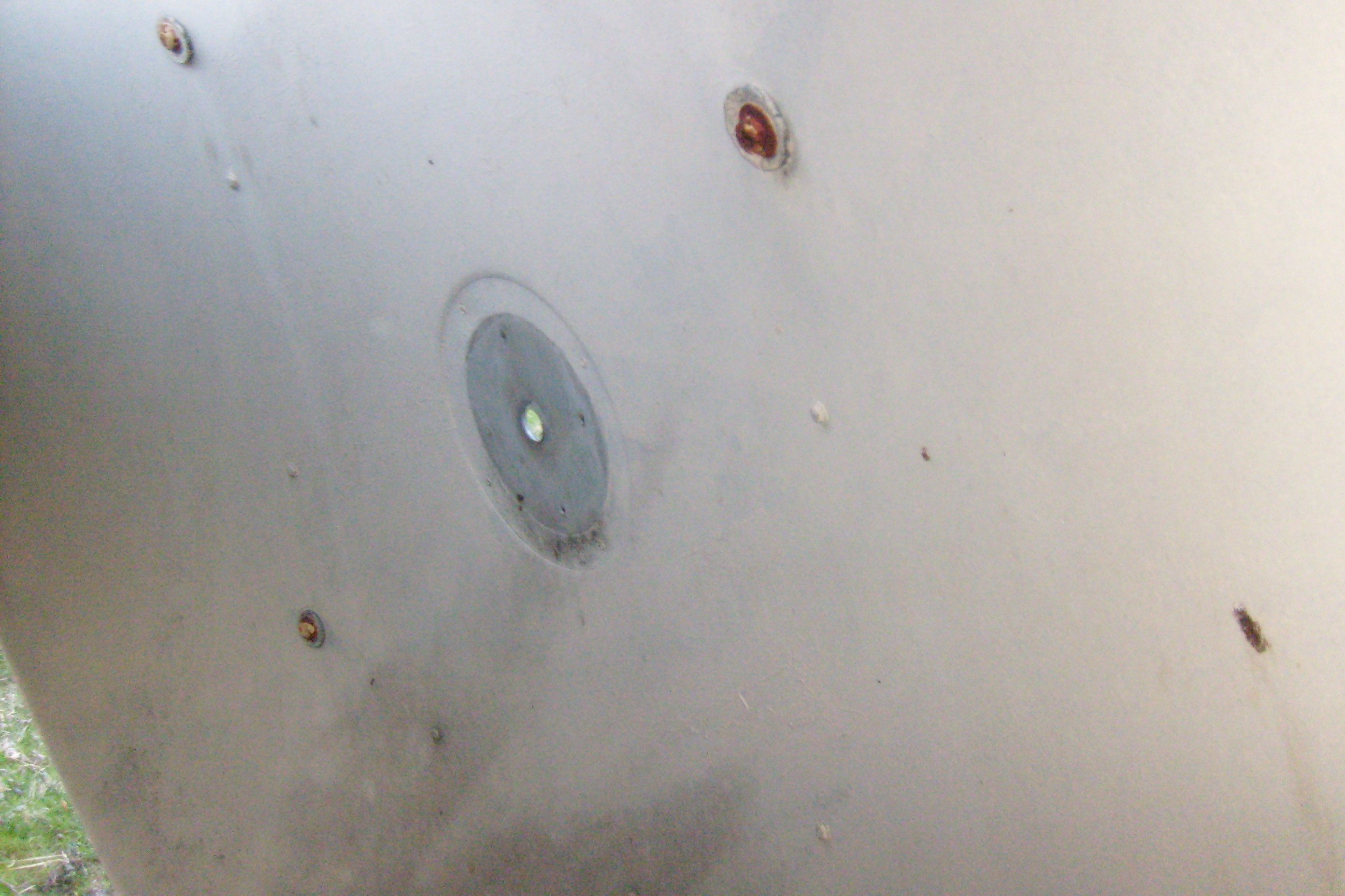

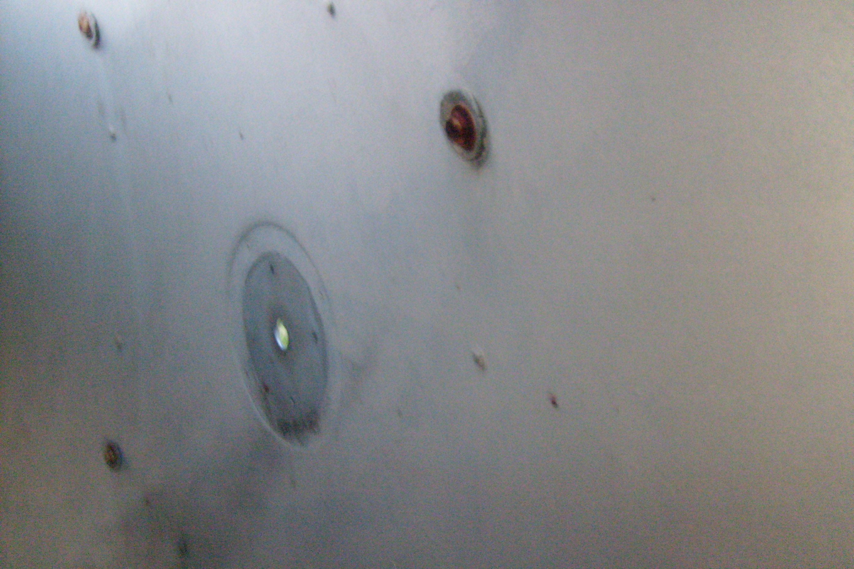

Went down tonight to see this dish for information but nobody was home. Took a tape measure with me and it is a 7 ½ inch diameter! The dish looks to be in great shape, was painted white though. No name found anyplace or nameplate could be found. Part of the mount was beside of the dish as you can see in the pictures. Part of this outbuilding was open where you can look in and found the old LNB or LNA. I will head down again sometime this week for another look! Keep you posted!!

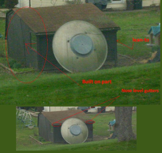

You might want to recheck your last post and correct the dish size.
But if it's 7½ feet diameter, then that building it's up against must be a kid's play house! :rolleyes:
Also, it looks like a button-hook feed.
The extra holes in the center of the dish support that thought, as does the feedhorn assembly.
The four marks on the back of the dish, which we thought were the LNB support struts, are actually for the mount.

We measured it right, it is only 7 ½ footer. That building is small, not quite a kid's size building but smaller than mine and I got lofts in mine! When we stood up by it the gutters were about nose height on that side that the dish is leaning up against. I am 5 foot 9 but so about right plus the tape does not lie. That side is a meg shift lean-to. The picture shows where I MS Painted the actual building and where it starts.

Buttonhook feed is a single shaft sticking out from the middle of the dish, with the feedhorn mounted to it.
I might be wrong, but the holes drilled in the very center of the dish suggest that is what it came with.

I thought that was a 10 or 12 footer lol, that little building really fooled me. But still I think it
would be a good project dish, restore and explore!

turbo, does look larger, only measured a little over 71/2 foot. Had been painted as you can see in the pictures so that will come off. I think I will get the 10 footer up and going first though for my first bud project! I think the possibilities on that one first will be the easiest one for a first bud install by me. :)

The LNA pictured is actually an LNC...it's a Dexcel that had a single conversion downconverter built into the LNA. It's of no use with today's equipment. The feedhorn appears to be a Chaparral Polorotor II which had a small DC motor controlling the probe.
DING DING DING! "Tell him what he has won Johnny"!
It is a Chaparral Polorotor II AC! Nothing get's by you guys! One reason I love this site! Very knowledgeable Members! :up
