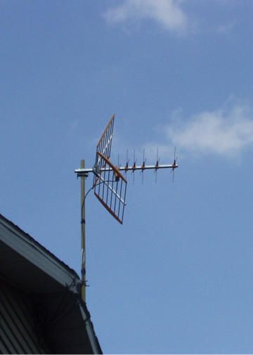

I think I have an 8 bay (CM 4228 not HD version or similar ) that I mostly pick up channel 31 with from our RV.
25419 elevation ~460' maybe add 30-40' if remounted on pole atop shelter. Lots of trees.
I thought I bought it from Solid Signal but I guess not. Darned if I remember.
I'm wondering if this Telves antenna might be any better, with a rotor and an added 30+ feet.
Today we get 31 (rf44) well and 60 (rf12) reasonably well but 25 (rf26) poorly if at all.

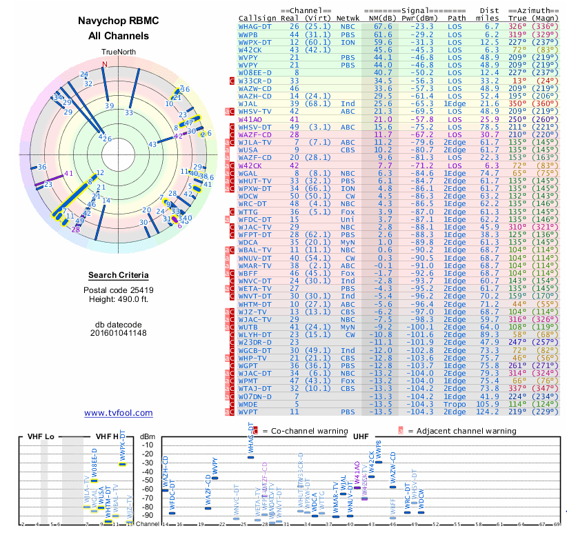

TV Fool shortly. But as I read it, I should just be happy with what we've got. We enjoy 31 MPT anyway.
Or would a different antenna and a few more feet make a difference?
http://www.tvfool.com/?option=com_wrapper&Itemid=29&q=id=5134dedbb6bec0
BTW, I think Its a CM 3020 on my home. Can't quite pick up 31, though.

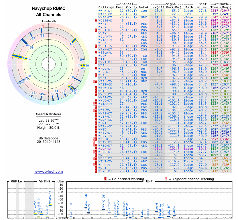

you meed to redo it 30 feet...it takes elevation into play already
also lat/longitude or exact addy lakes a huge difference

But odd that 31 isn't listed as best. Mounted on shed wall. Must check heading.
if you have to deal with hills/mountains Trip (the guy who runs rabbitears) says sometimes the TVfool may read wrong due to knife edge difracting (I think thats what its called) where the tvfool may say one thing but it comes in good.

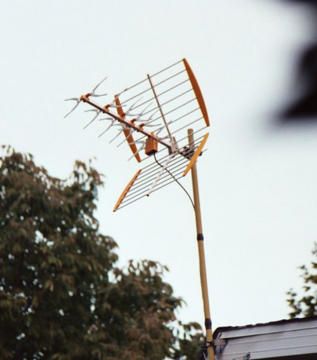

I HATE the Televes VHF combo antenna! The VHF on it is honestly better on the HDB91X than on the Televes antenna! I was hoping to replace my HDB91X with the Televes combo unit and get channel 11 out of Raleigh. That was a no go. Since channel 13 is so strong here, I even trapped channel 13 with a DC passive notch filter, just in case the amp was causing 13 to override 11, nope.
I wrote a review to put on their website, but Solid Signal chose not to post it. I even tried pointing it at Greensboro, since their signal is stronger than Raleigh's. Well, the "smart" antenna that makes sure that some stations will not override others. Well, I guess since 29, 31 and 32 were so strong, it seemed to attenuate channel 35, so I could only receive intermittent signals from it! The signal would bounce from 0-60%.
You are much better off with the HDB91X with an amp than to get a Televes antenna. Solid Signal was nice enough to accept a return.
Was I asking too much of it to get WGHP or WTVD???
Looks like 31 is SE of you whereas WHAG and Ion is NW of you.
You must have one helluva obstacle to the SE having PBS be only 15 miles away and 500kw and for it to show that low on the tvfool.

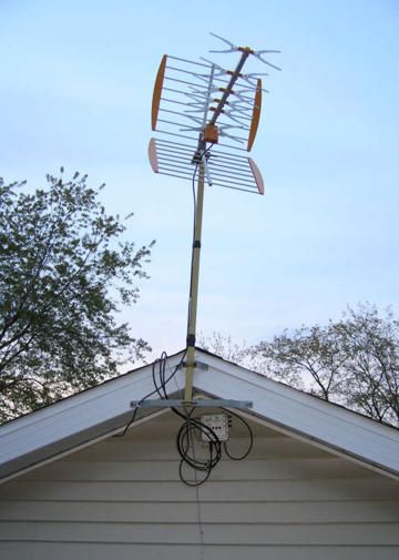

I saw that the other day and was sad to see I couldn't find a replacement for the unamplified Televes I installed ages ago. There is nothing wrong with the antenna except the roofers broke a couple of the cross-pieces off when they were climbing up to the second story roof.
We have UHF stations in our market so the model I got worked great, and I'm within five miles of all the transmitters so I don't want the amplifier on it.
I also bought the long-range model (since it was shipped from England the shipping was pretty much the same for one versus two antennas) but the pre-amp on the antenna needs a higher voltage than the power inserter I had and the preamp wouldn't kick in, staying in the passive mode. I see Solid Signal has the Televes PI so I'm going to have to check one out.
Edit: I am home and have access to my records. Looks like I bought and installed the Televés 1085 antenna in 2002. The long-range antenna I bought for up north is the DAT 75.
