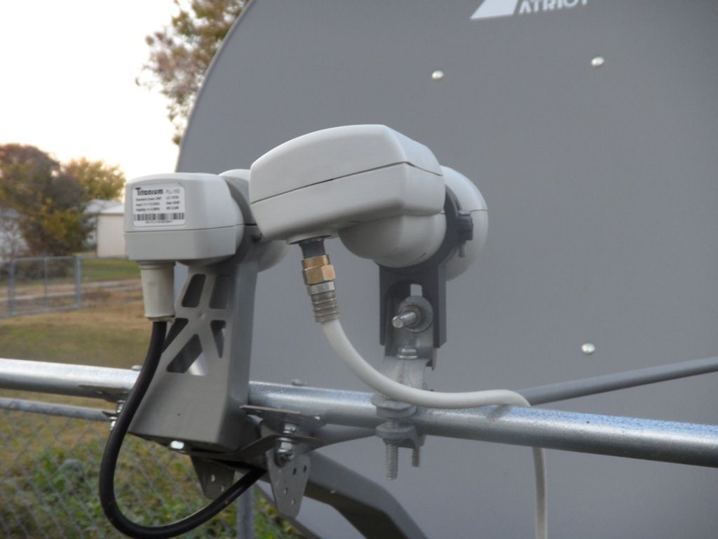

The hardware consists of a 1.2m dish, Invacom SNH-031 Universal LNBF, Ecoda 22khz switch and a Manhattan RS-1933 receiver.
Four tests were conducted. Three were with the same LNBF in the same offset position. The fourth as my 'control' with the center LNBF, a standard Titanium PLL-1KS.
The 1.2m dish used in this is motorized now, but still had the offset mount from earlier use as a fixed dish. The offset LNBF bracket was already set for 103W with the dish pointed at 97W.
The dish was motored to 97W and the Invacom Universal LNBF placed in the offset mount. Then the Invacom Universal LNBF was roughly peaked for 103W. Transponders were cleared from receiver menu before and between tests. Full scan (including scrambled) used, network scan off.
