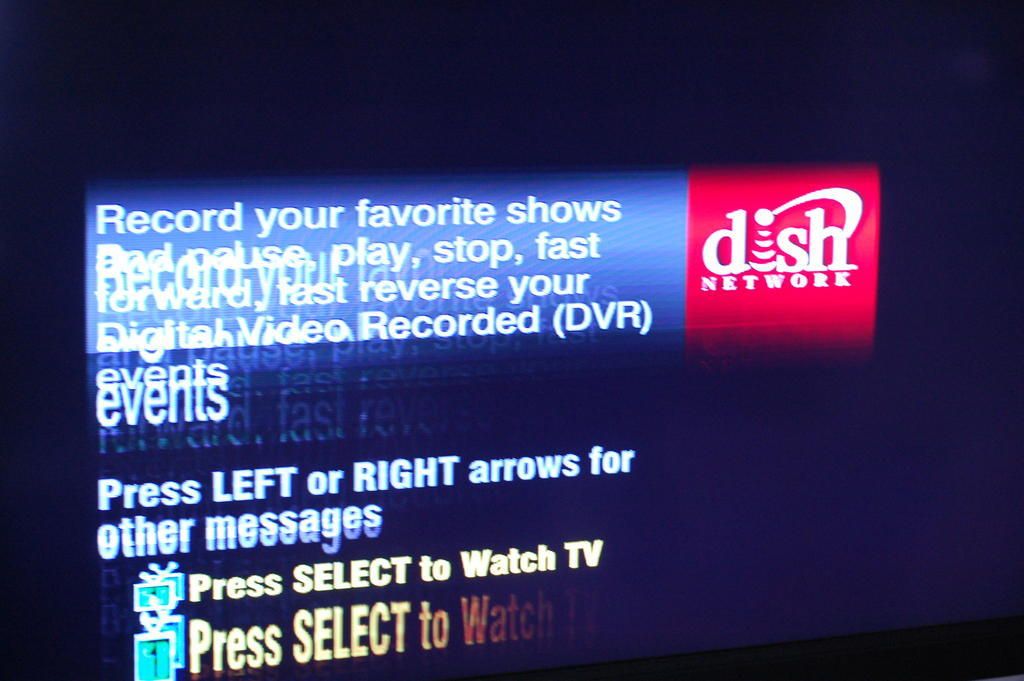

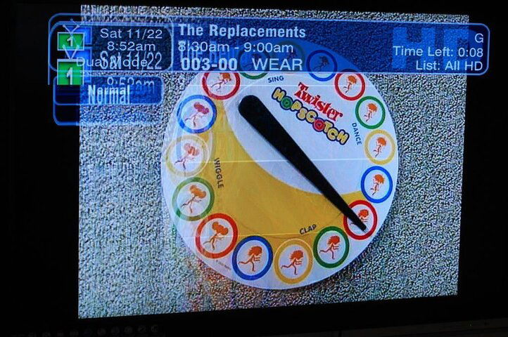

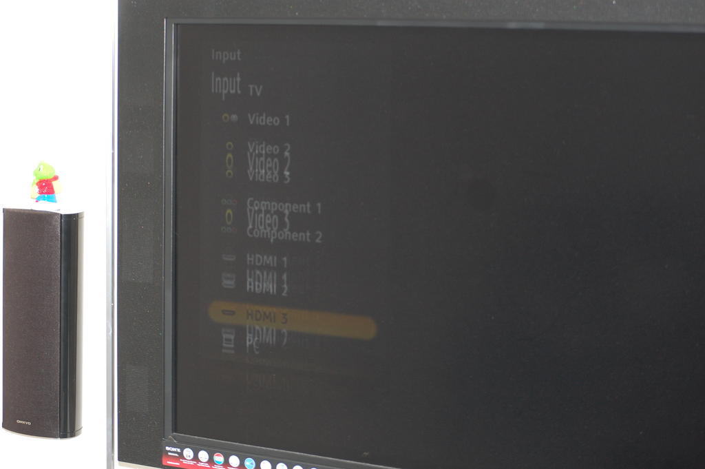

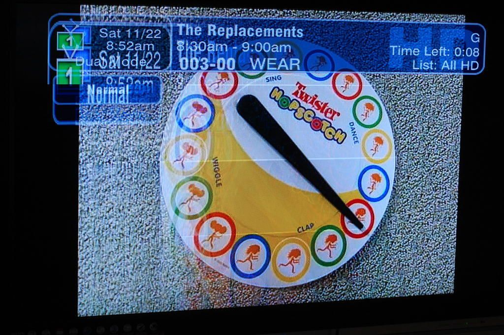

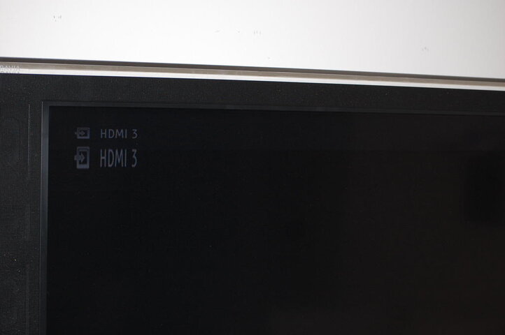

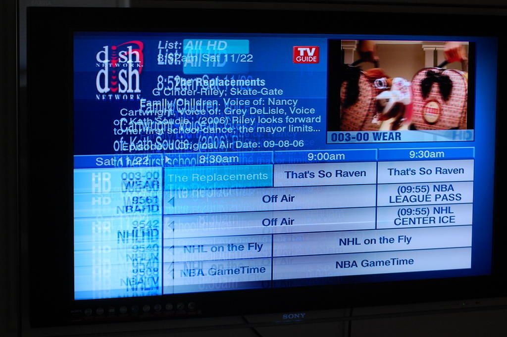

Hello,

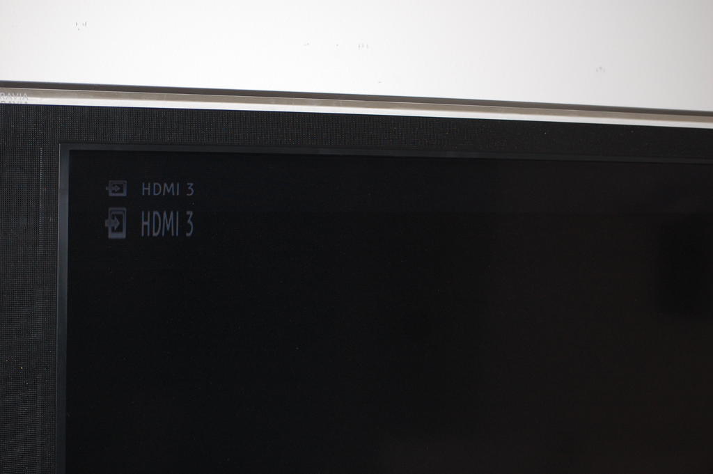

I am having a shadow problem on my 46XBR4 TV. I am attaching pictures of the problem and info on the problem.
Problem Details
- Shadow occurs when TV is switched on after atleast 1 or 2 hours of being switched off
- Shadow occurs for about 3 to 5 mins and corrects itself.
- Shadow is very prominent on the text.
- There are about three horizontal straight lines on the picture in the middle of the screen.
- Shadow occurs prominently on the left of the screen. The right side looks okay.
- I have removed all inputs to the TV and switched on and see the problem appearing as you can see in the first couple of pictures.
Any ideas on how to solve this problem? Any and all help is greatly appreciated.
Thanks and Regards.

Check your wiring. Thios sounds like a cable crosstalk issue. Not seeing it all the time doesn't mean it doen't exist. Make sure none of your input cables are in contact with the cable/antenna wire or power supply. Also, if you receive signal from cable, try disconnecting the cable wire to see if that doesn't clear up the problem.:D
No, because the pictures show the problem when nothing is hooked up. The problem is in the electronics, not mechanical. Sony used to be notorious for poor wave soldering causing components to lift off the board over time. Thought they had that fixed, but who knows. It might be as simple as hitting a few components with a soldering iron.
