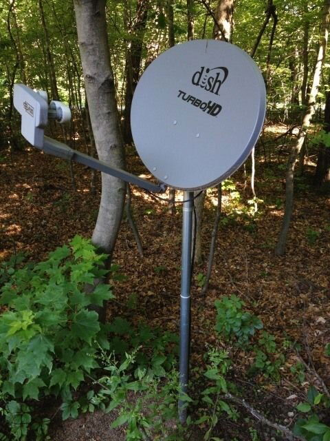

I currently have a dish 1000.4 set up for eastern arc. I live in Minneapolis, Minnesota.
The trees are leafing out and 77 is starting to become obstructed. 72 is a little better and 61.5 is clear line of site. There is one cable coming from the dish to the DVR. Here is the dish.

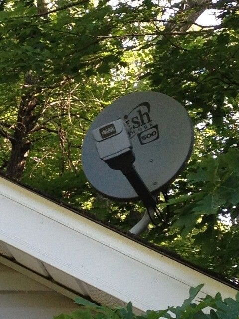

Before the install of the eastern arc, I had a dish 500 mounted on the roof of my garage. It is still there but abandoned. This dish has clear line of site to 72 and 77 but not 61.5 There is also cable available to the DVR as well as to the same point where the 1000.4 cable runs to the DVR. Here is that dish.
What I would like to do is swap the 2 dishes and use the 1000.4 for 72 and 77 on the garage roof and then mount the dish 500 on the pole and use that for 61.5.
Is this possible?
Could I run one cable from each dish and then combine them somehow (switch?) and run one cable to the DVR?
Will the dish 500 see 61.5 or do I need a different dish?

Whatever your decision on any of the above, the 1000.4 has an input connection that will accept a single orbital, so whatever you come up with you can combine one more with whatever you point the 1000.4 at. If the extra input is replacing one of the three the 1000.4 is looking at you might want to cover that particular LNBF with tinfoil to block any chance of it accidentally being included in the checkswitch results.
77 just has the locals for a few select cities. Most people don't need 77.
Swapping the 1000.4 and 500, then hooking the 500 to the LNB IN on the 1000.4 would work fine. Otherwise, leave the 1000.4 where it is if it can get 61.5/72.7. Don't worry about 77.

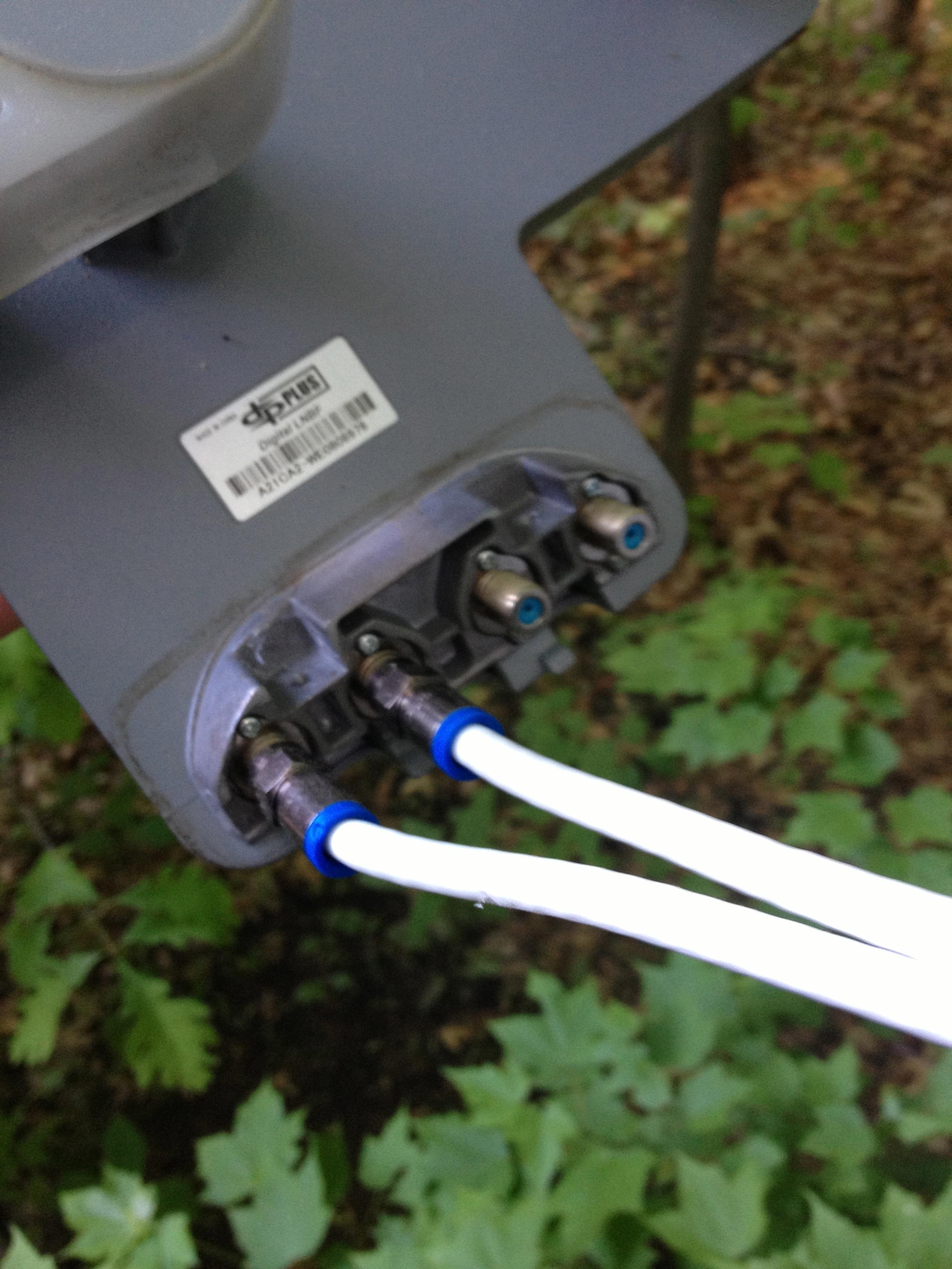

the odd thing is this is what my lnb looks like
this diagram says i should not get 61.5. the 2 cables go to the solo node.

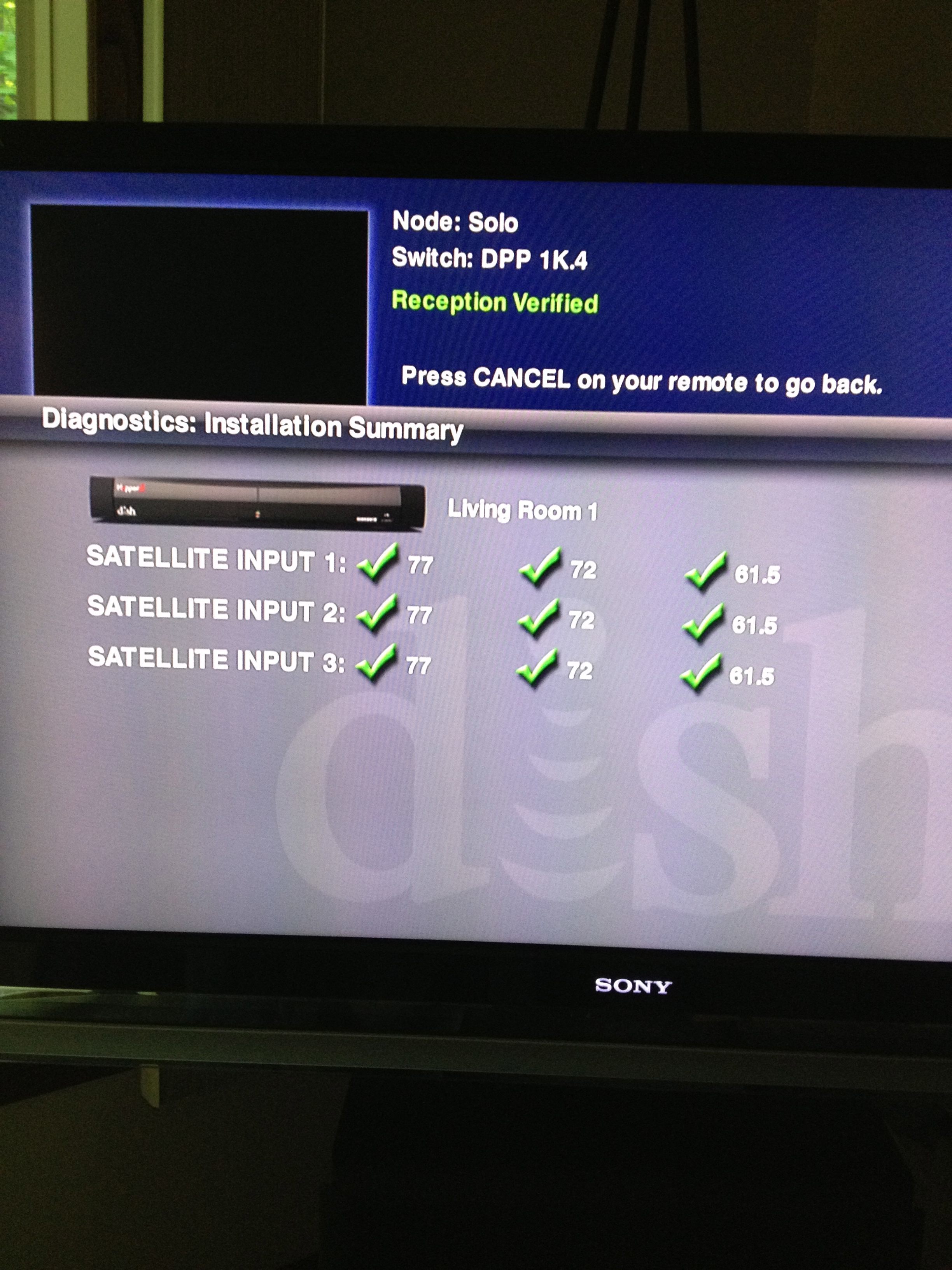

but hopper says i am good.
and i checked channel listing and i am getting channels on 61.5 and 72
i read 2 satellites can use a single cable, but it appears 61.5 is not connected to anything.
thank you for your help !
Sat markings only apply when connected to a DP or DPP switch. A receiver or node will select the correct LNB by sending DiSEqC commands to the LNB.
