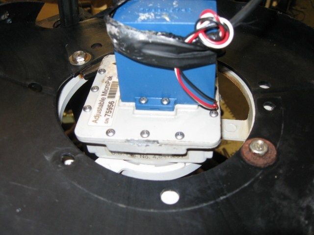

There is a channel master feedhorn cover on it, but she said the dish was hit by lightninig in the early 90s and the lnbf was replaced, so I dont know if it is a channel master dish.

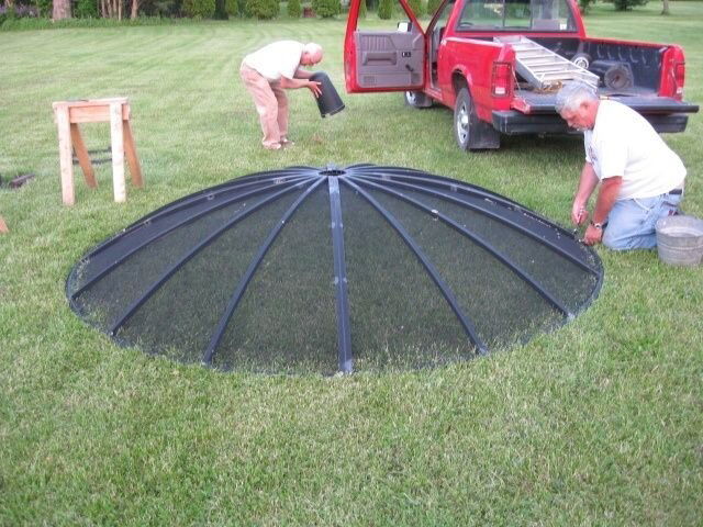

The dish is either 10 or 10.5 foot in diameter. :hungry:

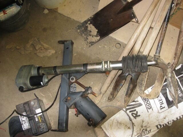

She said the motor was replaced, and what makes this a winner, is a Thomson Saginaw Performace Pak Acuator on it!!It looks brand new, I think it is 36" it measures 32" from end to end fully inserted, but i dont think they make a 32" acuator.
The dish came apart in 4 sections, the ring mount from my perfect 10 may fit on it, which may allow me to reuse it.

2. Would this pricy saginaw do better then an h-h?

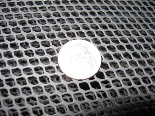

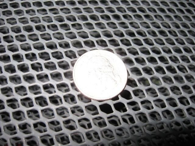

3.Is the holes small enough for KU? (see pics)
4. Is it possible the feedhorn has sagged? it is sturdy looking
5. The ring mount is bent slightly where it goes to the mount, will this hurt?
6. It has a chappral micropak any good?

2. The Arm will get you about 50 West to 139 West, it's not H to H.
3. Looks good.
4. When assembling, check that it's centered.
5. Post a Pic.
6. As long as it works.
