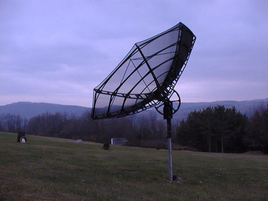

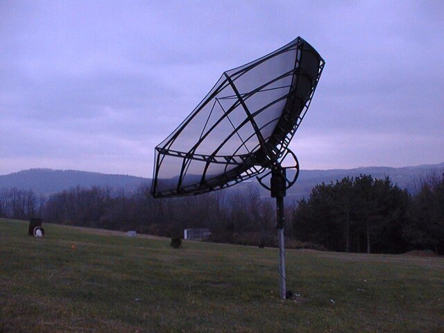

did some photo hunting and am sure its a paraclipse
how would one take it appart so its fits in the bed of a truck?
i went to look at it today the guy wasnt home, il come back later
im not so sure the dish is a paraclipse. i was wrong, the ribs are sqaure aluminum, painted black, it has a heavy sqaure mount on the back of it, but it has squared edges like a paraclipse
the dish has alot of hail dents
is it worth getting
i dont know if i want to mess with it, it has hail dents on every square inch of this ,dents, that looked like they were caused by golf ball sized hail my dad says that happpened back in '85, so this dish has been here since 85 or before, so its is a very old mesh dish, has a large square mount on the back with a thick acuator, with a weather boot, has a button hook feed with old looking lna's on it, the dish has squared edges like a paraclipse, but not thick ribs, just tubed aluminum, wonder what kind of dish is this?

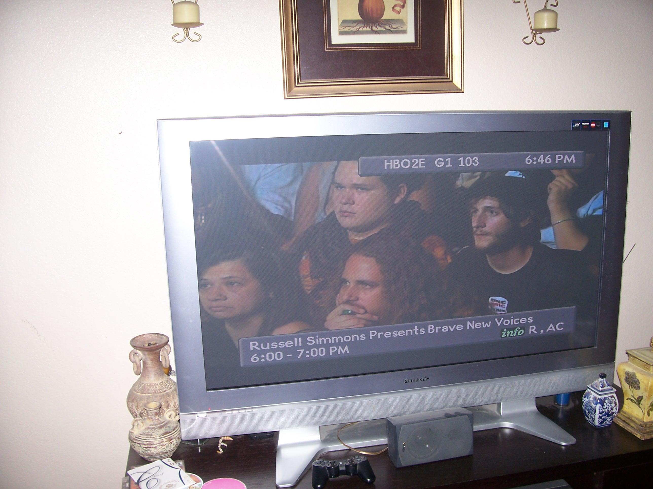

In my setup, a 6' dish works perfectly for AMC18-W5 for my 4DTV programming located there.
However, if your package includes programming from G15-G1 you may have problems. The HBOs there are 7/8 FEC and may pixelate with a 6' dish.

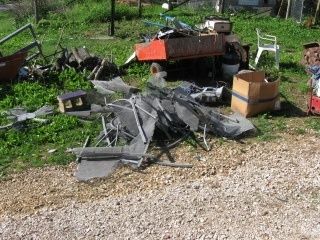

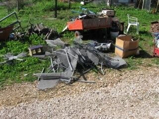

He had a 10 footer that seemed to be fine, but he took it down and destroyed it. :rolleyes:
Ya, he should have kept it.

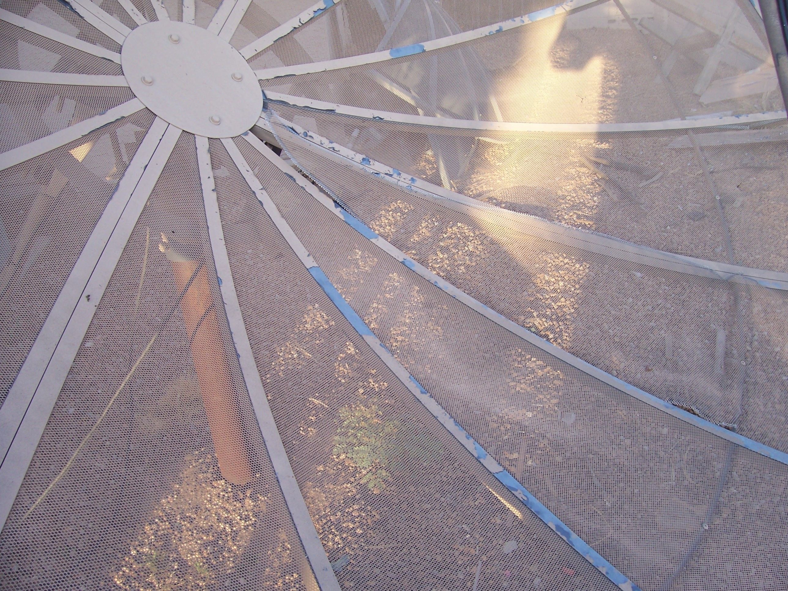

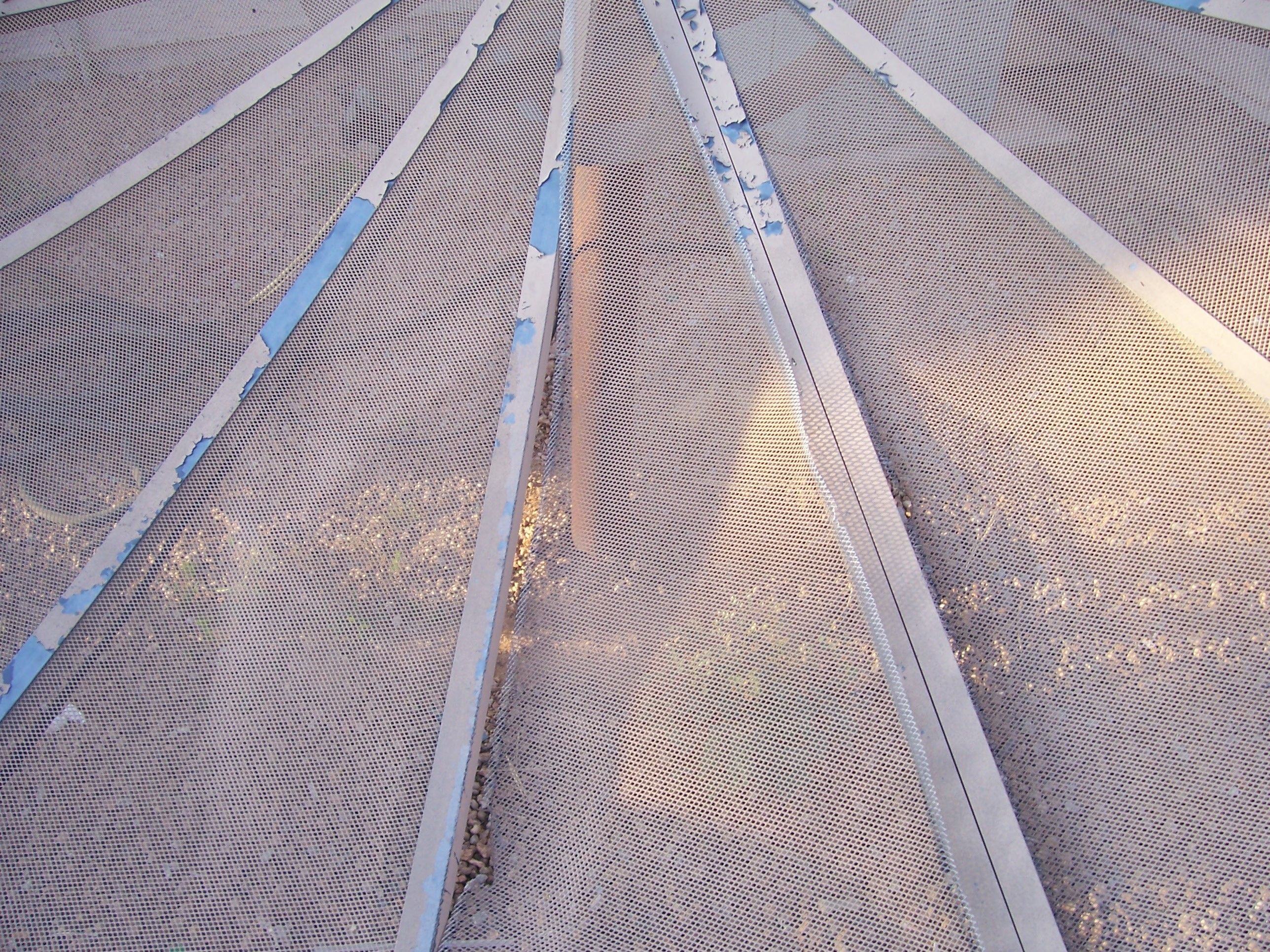

Mine seems to do just fine after the dog used it for a trampoline and fell through.:(:eek::D

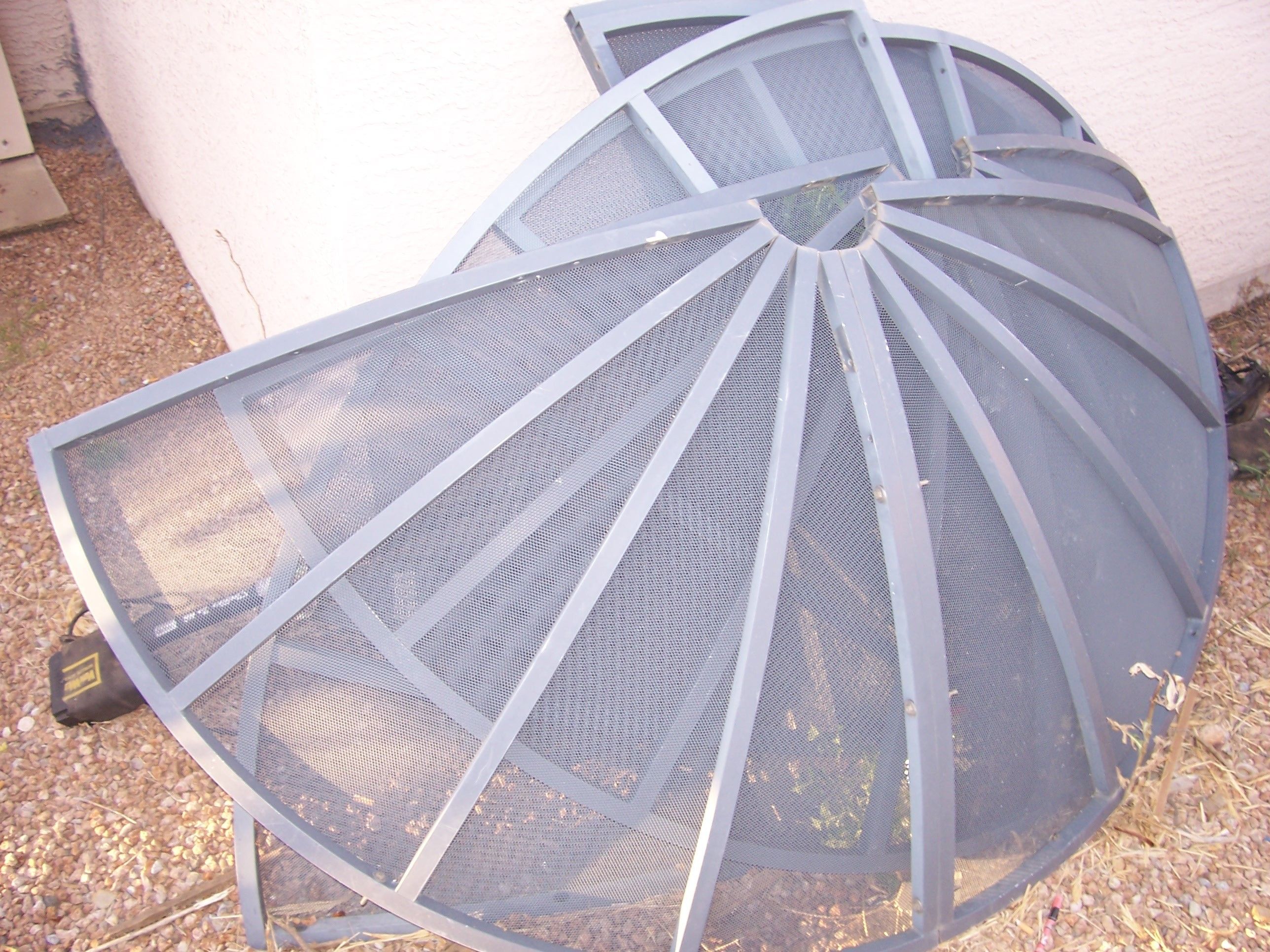

And he didn't seem too interested in paying for shipping on my 6 footer i have laying in front of my "mint" 8ft. winegard.:D

the 10 footer had something seriously wrong with it, it would not track the arc
