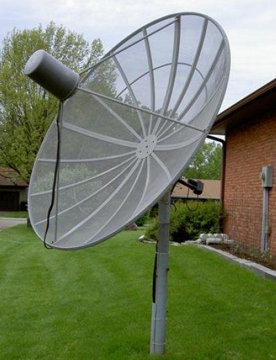

Yes, please post a Pic.
Measure the Panels too, length and both ends.
Maybe the mesh from a salvaged dish or 2 can repair yours.
Also, did you try posting on Craigslist asking for a dish?
The above pic is a good pic of the dents that are all over the dish, from hail, and the large gash in the dish.
also my scalar is not centered, one of the arms in bent in.

I would just straighten the lnb arm to center the lnb, realign it to the arc and call it good. Those dents and that gash won't hurt a thing. Looks to be in decent shape to me.
Agreed.
That dish is in as good or better shape than the 10' Perfect 10 that I have been using for 15 years. I have gotten just about everything I have attempted from 87-137W, including the DVB-S2 stuff.
Fizzly, you just need to put a little TLC into the dish you have, it should work fine for you. :)

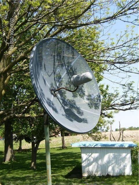

this guy has it to give me ( i think) it cant be a 10 footer, due to the ammount of ribs, IIRC this is a winegard Quadstar, which is a good dish, and from the pic, looks like its in good shape,
I have the mount from a 10 foot winegard pinacle, will it fit on this dish? It looks the same as in the picture. It would be less for the guy to lift into the truck.

The dish in the picture is a Winegard perf, not a Quadstar. The pinnacle perf mount would not work with a Quadstar without some custom fabrication - totally different styles of mounts.
