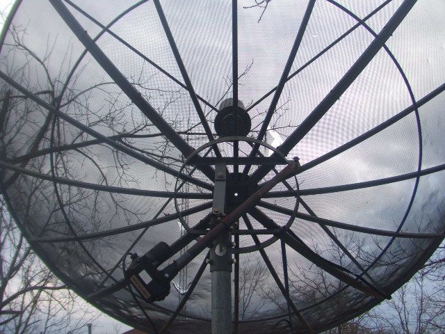

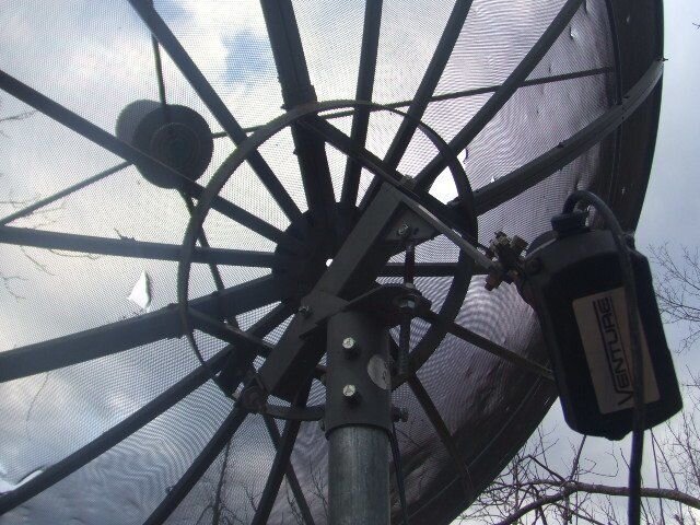

TechFizzle, your dish is in MUCH better shape than my 10' Perfect 10, you should just go with what you got.

i will have to do some thinking about it
all the dents will bounce signals into another part of the reflector, or away from it causing some major signal degreagration
You are correct, a dish with a lot of hail dents and holes (like mine) is not going to be as efficient as the same dish that is pristine....but that being said I get anything and everything I try for with that old beatup POS. :cool:
The keys to mine doing as well as it does are the size (10') and it is very well aligned, you could do the same (or better) with yours, I'm sure. :)
im thinking the reflector is warped.
I bought this dish at the auction it was in 4 peices with the h-h and mount SITTING on the dish, and I put it together
if i peak the dish one way, pbs x and the buena vista feed on g-16 come in loud and clear with to sparklies
if i peak it another hsn and other channels come in, put no pbs x or buena vista
and some channels dont come in any way i peak it
i cant get sheppards chappel at all, which was being picked up fine on the 6 foot unimesh ( i junked it because i was going to put it on the pole, then it slipped on the pole gorged the dish)
If i can get it for $150, isnt that a good price? brand new acuator, the dish is about 6 years old.
also will an acuator track better then a h-h
another reason i hate this dish is becuase i burnt up the reed swithches
not exactly what i meant
i had it peaked on my true south
also is an acuator better then h-h for acuracy
Have you tried doing a string test to see if your dish is warped?
And, generally speaking a good H-H is probably more accurate than a linear actuator...but for C-band only it doesn't really matter, you can get "close enough".

My bet is on the support arms. My father and I pulled the buttonhook arm out of ours 2 weeks ago and re-straightened it.
Poor thing had a limb hit the arm the first year and took another one last winter.
It had a wonderful dent/rib where the arm rested on the mount
The LNB holder was 3-4 inches SSW of bore-sight.
5 point gain on C-Band (meh, most stuff was above 70 anyway) but that's what it took to get my Ku-band back in alignment and nothing below 65 (up from 40 on the strong TP's)
Note: Geosatpro meter, not coolsat meter
At the same time it sounds like you just want another dish. $150 Delivered, take it!
Don't scrap your 10 footer if it's C-band only. A little TLC on the actuator and it'll run great.
when i bought the dish the support arms were bent straight up. it is very hard to restraighten bent aluminum bent near a 90 degree angle
