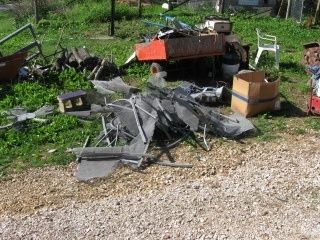

the dish is coming down in a half hour and is going to be tunred into pop cans, il redo the h-h
the dish is now dismantled.
after i cut it up and got to the support arms, i noticed the cband lnb was 1/2 from the feedhorn and only being held by one bolt, but i am sure this was done by all the hammering on the dish.

here is a picture, wich i made smaller to not anger iceberg

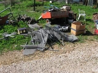

There's this new satellite company....Skyvu INC, I think they sell C-band dish kits. I sure hope this one comes with good assembly instructions!!! BWAHAHAAA!!:eek: :yikes :haha

That is some funny stuff right there. Made me forget all about my "problems". You sir are a stimlus package.
