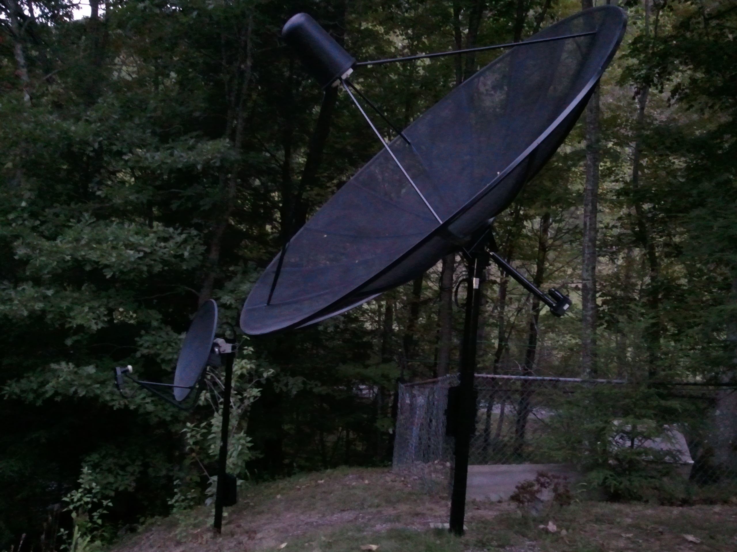

After google -ing for parts or a solution ran across a post at sadoun .net (Bubby-joe posted in feb.2009). I recently had moved my dish to a better location (Odd that it worked for a few days this way) and unknowingly tightened the upper motor mount bolt to tight.I loosened it up, the barely tightened it and now it works fine. I would have never thought. thanks to everyone who offered help. this is a good place to visit.
HH90 reinstalled and working fine.los amazonas 61w to 125w, 2011-09-15 19.27.48.jpg painted the 36" fortec star dish black to match the rest.
