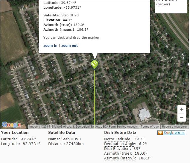

Thanks for the help so far, I really appreciate it! Okay, so I have everything hooked up now, but I wanted to make sure that the latitude on my motor and elevation on my dish were set correctly. I noticed on the dishpointer website that there are two different elevations listed. On the actual map it says 44.1 degrees and the other, under dish setup data, says 39 degrees. Why do they have two different elevations listed, and which one should I use?

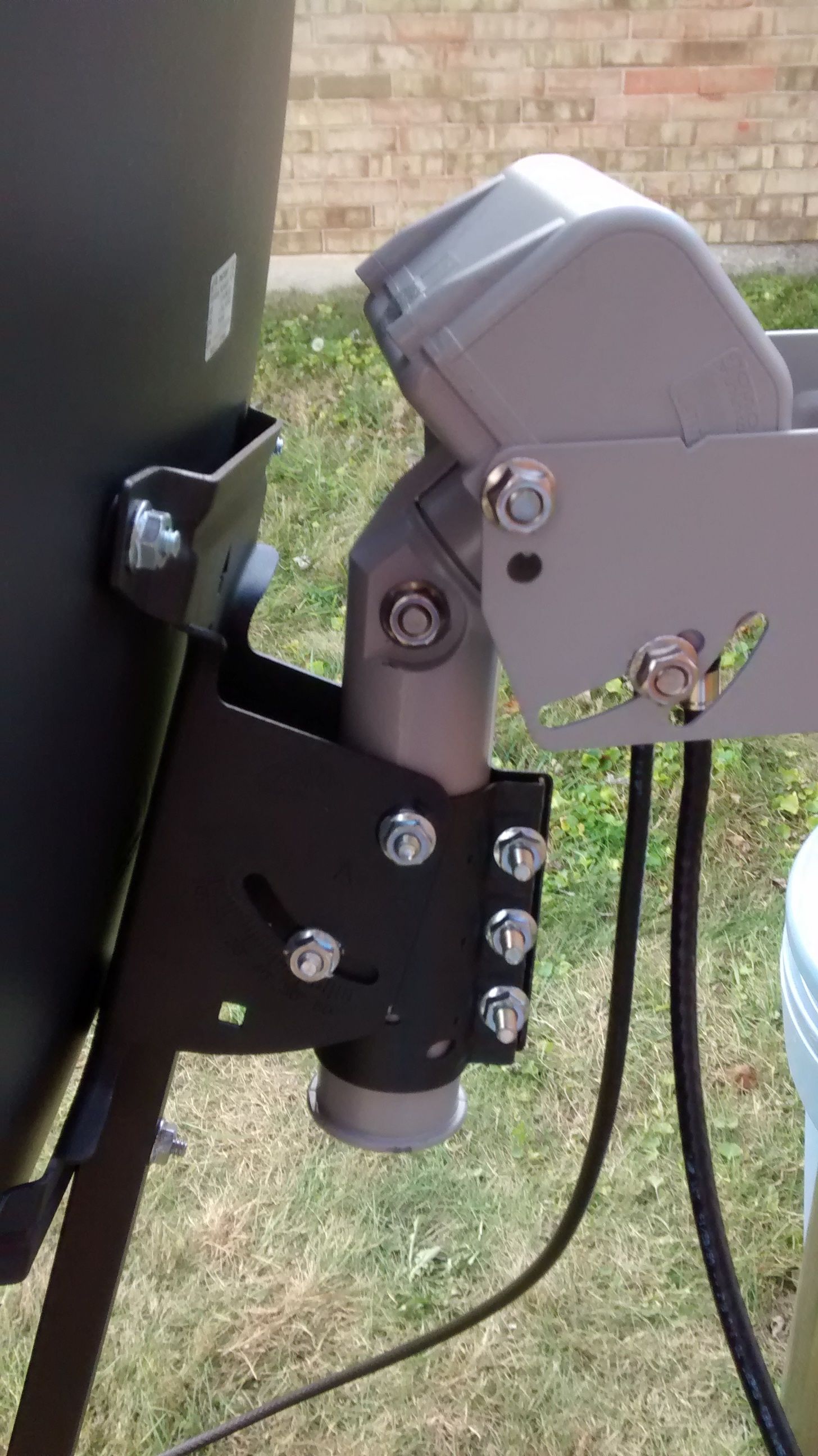

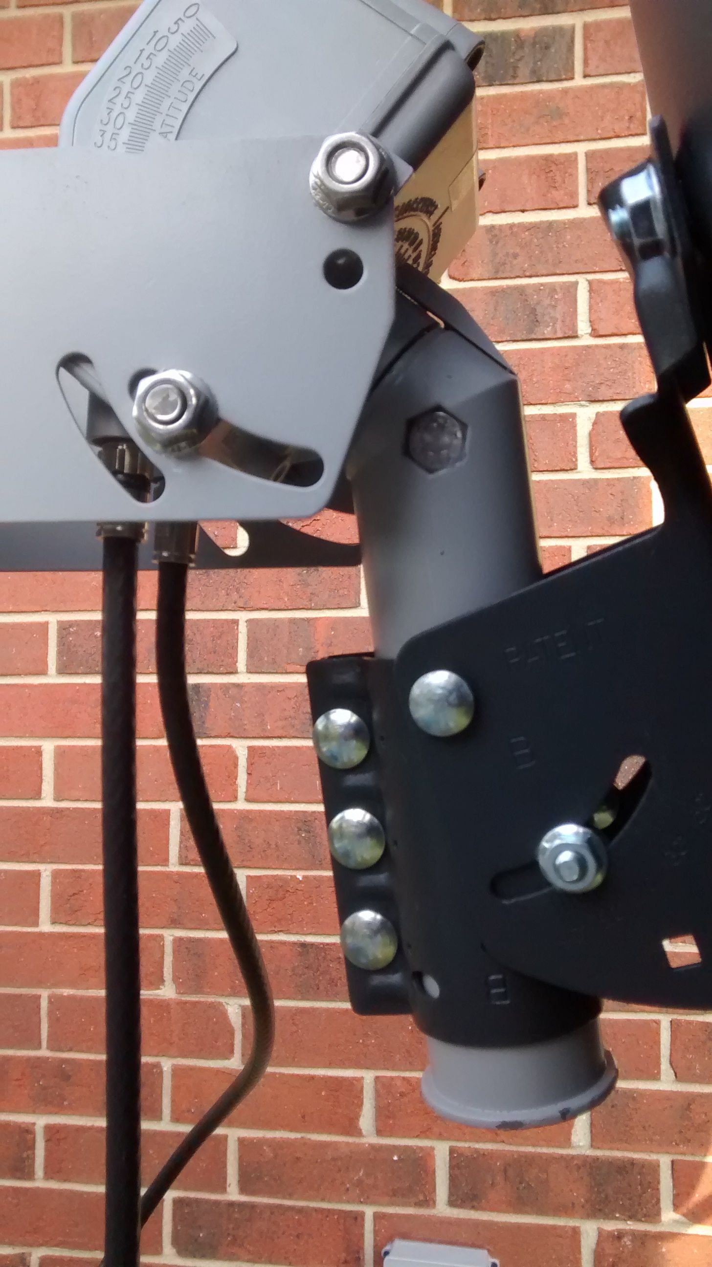

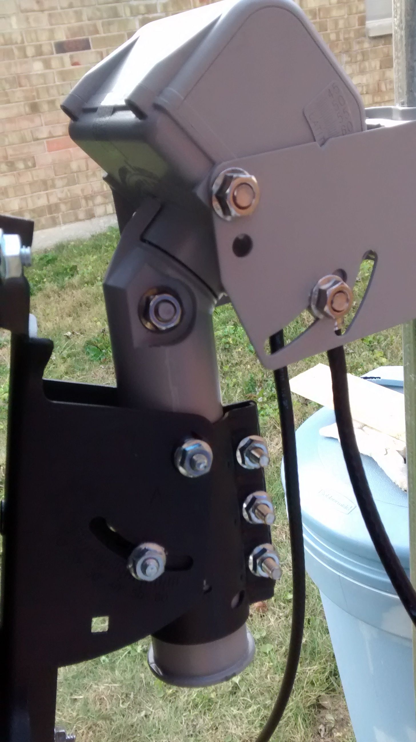

One other thing. I am unable to rotate the whole motor dish assembly on the pole manually. Does that mean I have something too tight? Here are a few pictures of the way the motor is mounted to the dish.

Disregard the "motor not moving". I guess I was confused on the instructions. I was able to get the motor to move via the receiver, so I guess the motor is not designed to move manually? :)
I think I understand now that the "whole dish assembly" means rotate it where the motor is mounted to the pole. Now I guess I need to buy a compass in order to determine true south since my smartphone is acting very wonky. Looks like my declination angle is 6.3 degrees so I guess my true south would be 186.3 degrees. So where the motor is mounted to the pole, is that what needs to be facing true south?
Set the motor Latitude or Elevation angle to the correct setting. If the motor doesn't have a Latitude scale, the motors elevation scale setting is calculated as 90 - 39.67 (your latitude) = 50.33 degrees Elevation Scale reading. The dish's elevation angle setting is calculated in the back section of the motor's installation manual. Remember that the pole must be plumb and level for the motor/dish to accurately track the arc of satellites.
When the motor rotation is set at zero, the dish face will be aimed at true south. As you are probably using USALS to install and aim the motorized dish, it isn't highly critical to know where true south is. If you are outside at about 12 noon, the sun will be approximately in the true south position. The dishpointer map that you posted above will accurately show landmarks to line up with true south of the drop pin is placed in the dish location.
Select a satellite near true south (83w), select USALS motor type and enter your install location longitude and Latitude. The dish will move about 1 degree to the East. This is the calculated position from true south for your location.
Now with the receiver and TV next to the dish, place the receiver on an active transponder for 83w. Slowly rotate the motor on the pole to about 15-20 degrees East and West of the true south landmark while watching the Signal Quality meter reading. If no Signal Quality Reading, increase or decrease the dish elevation setting in 1 degree increments and slowly sweep the sky East and West of the landmark. Repeat until the Signal Quality reading is found and optimized.
