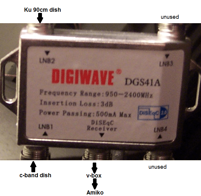

Currently, the Amiko connects directly to the v-box, the v-box to the receiver port on the 4-way diseqc switch.
Should the v-box be on port 1 of the diseqc 4-way instead of on the receiver port? This way the Amiko would be directly connected to the receiver port of the 4-way switch and diseqc commands will be routed to both port 1 and port 2?
Or setup USALS for the 90cm dish and diseqc 1.2 for the c-band dish?
(Thanks Fat Air for helping me visualize this last summer)
Mine goes from my receiver to an ASC-1 then to the HH90 then to the switch. Then of course all LNB's/LNBF's come off the switch. When adding anything to the ASC-1 I disconnect the coax going out to the dishes/HH90/switch.
This keeps the HH90 from storing the DiSEqC 1.2 commands.
I use DiSEqC 1.2 for the ASC-1 and USALS for the HH-90.
