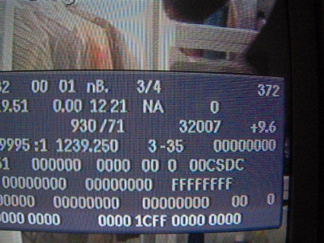

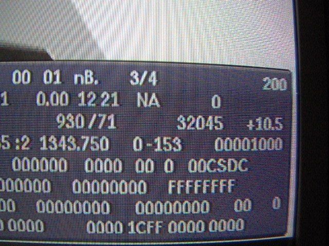

the signal I don't go by. The Ebno (options 6-0-5 right arrow to diagnostic c) works much better and is like the quality meter on a free to air dish :)
The signal will show between 20-60 if a LNB is hooked up regardless of where its aimed
The + number in the right corner is the EbNo # and will allow you to fine tune the signal
