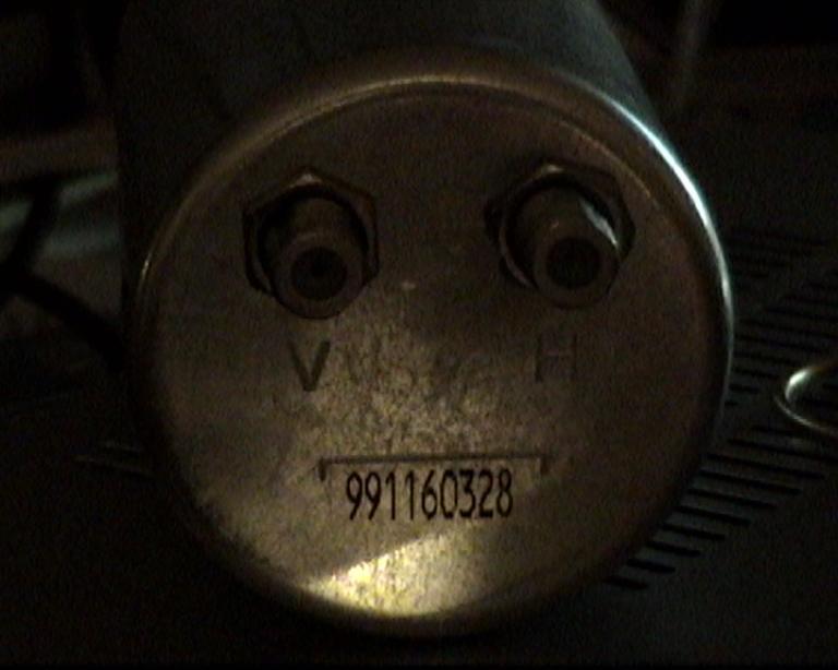

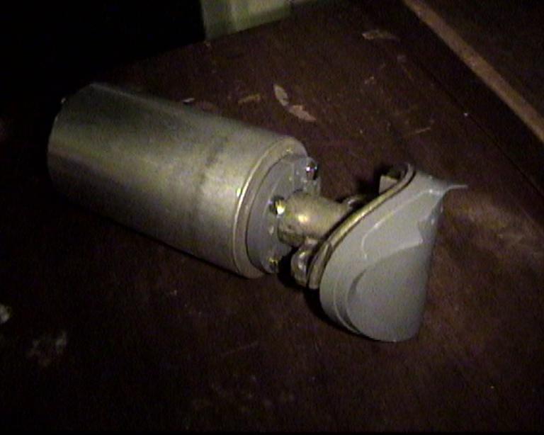

When I have no lnb plugged in the both meters are at 0% but right when I plug the lnb into it the signal jumps to 30% or 40% and quality stays at 0%. No matter what I do I can never get the quality to go up, I moved the dish around changed to different transponders and moved it around some more, but nothing helped. I've been trying all day! It's the same results I got with the Starbox.
Is it normal behavior for the signal meter to go up like that even when it's not pointed at anything? Is the something wrong with the lnb?
The signal meter on the Fortec acts just like the SATELLITE FINDER, if I point all the way west when it's about to point at the wall the signal goes down to about 36%, when it points at the wall it goes up to 44%, when it's pointed at the sky to it goes from 40% to 43%. I have the L.O. set to 10750.
Here's a couple pictures of the lnb:
Sorry about the bad quality, I don't have a digital camera so I had to use the camcorder.

What dish is this?
All AMERICAN made Winegard Antennas
