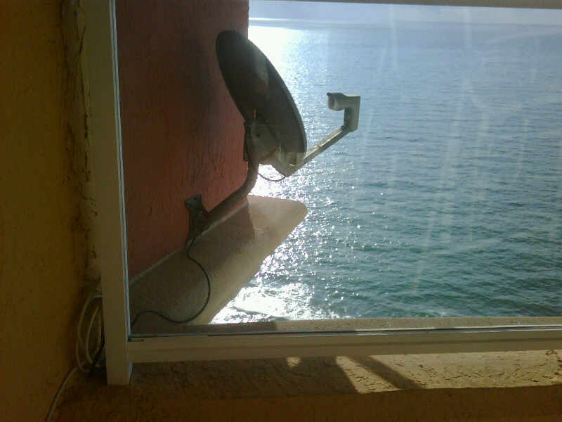

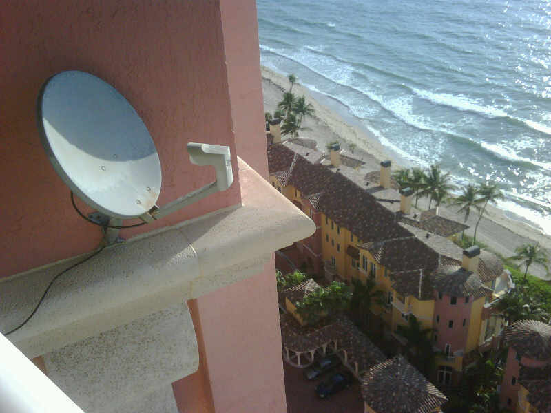

With regard to Saturday's mess, I strongly suspect that the tech was a Dish employee as he was in a DISH Network white van with official branding. On the phone making the order (thanks to this Forum) I asked for a 1000.2 and 1000.4 and spent forever describing my unfortunate situation. I thought that was what was coming. The 1000.2 on West arc could do two receivers by jumping the 44, and going direct from the 1000.2, and the final receiver would get the 1000.4 on the East arc, also jumping the 44. I believe this would have then provided all HD to all receivers, and the locals to two of the receivers (which was fine with me).
Frankly everyone that comes out takes a look at the location of the East facing dish, and gets queasy, it is three feet from my balcony on the 23rd floor. It was a bitch getting in, and I do not think anyone wants to fool with it, and it influences the story I get. They then suggest me ripping the place apart to get three lines in from the West facing Dish.
I just love the set-up I have now (six years with various receivers) and now that I know that the 61.5 slot may continue (thanks to Krell!) will await developments, the extra HD I am missing is not hurting me.
East facing dish photo
