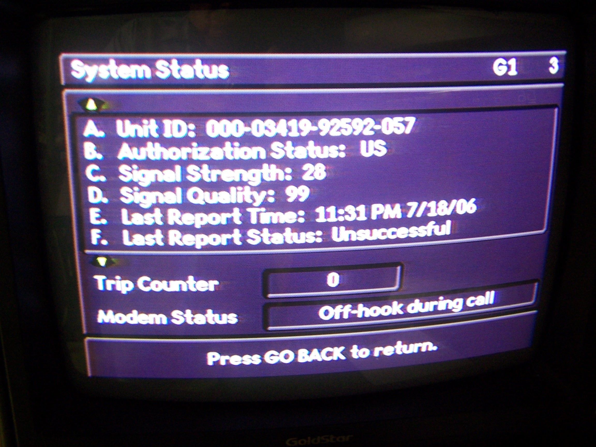

One of these pics is of the left or right polarization status that was different.

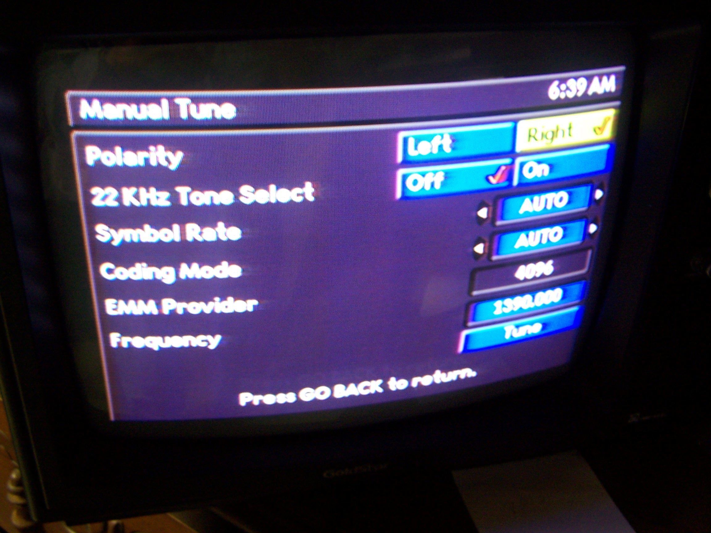

When I hit the tune button it was still tuning 3 hours later, so I assumed it wasn't going to do anything.
On that manual tune window the polarity was on the left when I first open this window, I changed it to the right to see if would help, but it didn't so I have now changed it back to the left.
Is there any reason you said NPS rather than skyvision? I seen on one of those windows there was a 800 # for somebody, don't know if it was the previous owners provider or not.

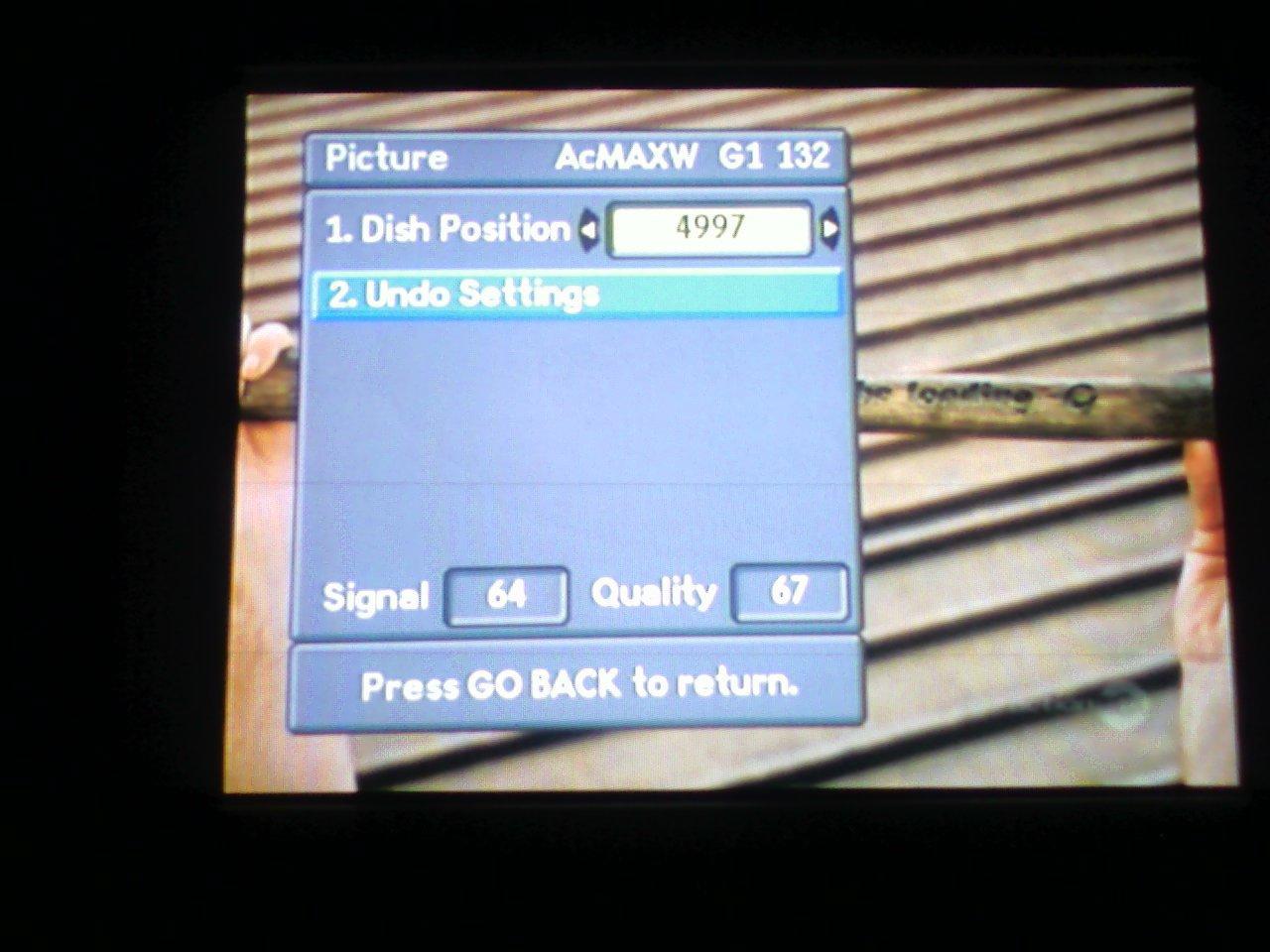

Do you have an "adjust picture screen"? Like this. And does it give you the same 20 signal, 99 quality?

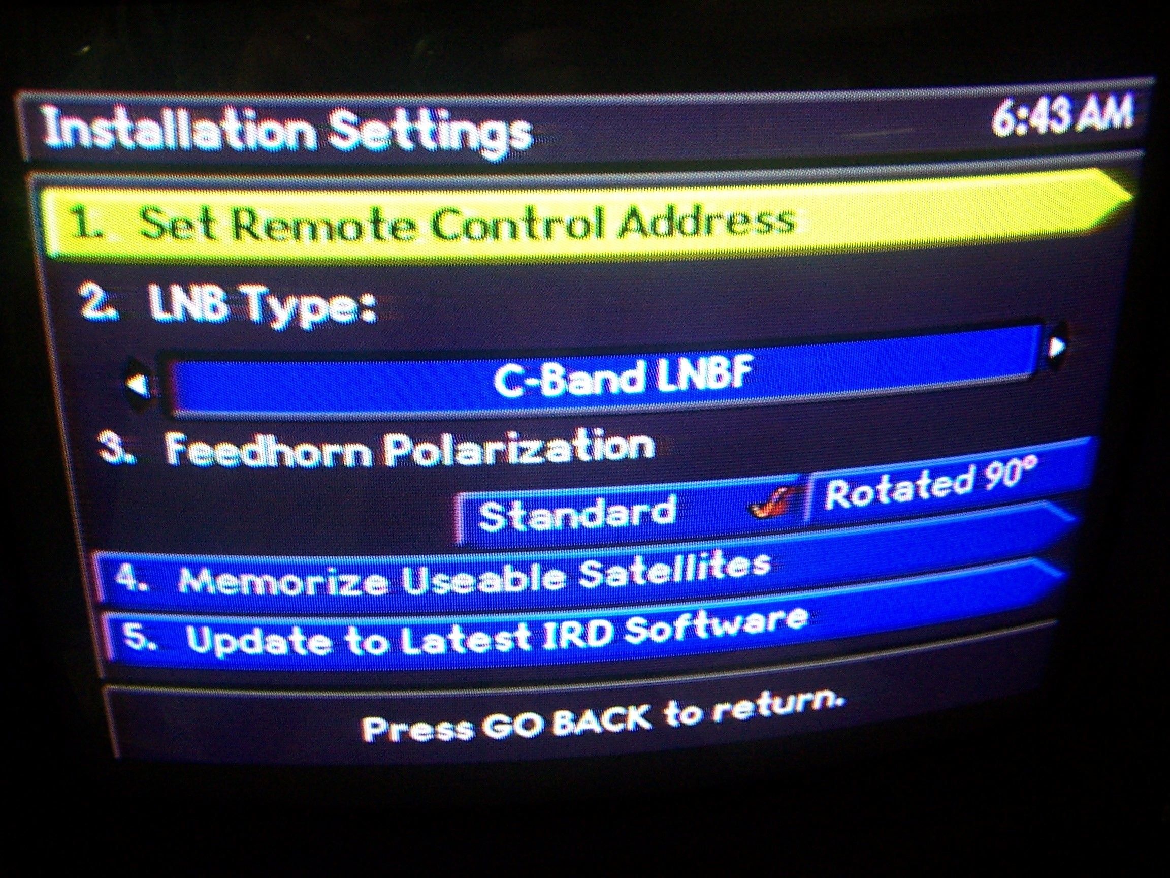

I brought up the diagnostic C window and it does not make a difference with anything I do. It still shows the -3.00
bob
