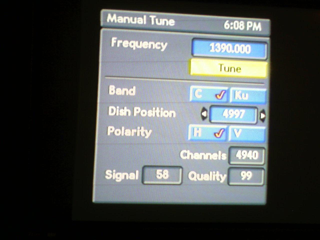

Does anyone know what the right or left polarity selection is on manual tune menu?
I have not tried disconnecting th e4600 but will try that and see what happens.
I am going to hold off on the password until I get this working or take a hammer to it.
I have G1 selected on the 905 and the 4600.
I don't have a right or left option. Only a H or V. The pic below is from G1 3 manual tune screen. I'm assuming the Data stream is at 3760 H. Which at 5150 Lo - 1390 frequency = 3760.:D
BTW, the tuning selection stayed tuning. I doubt if that would change unless you had a lnb and positioner and servo motor connected??
