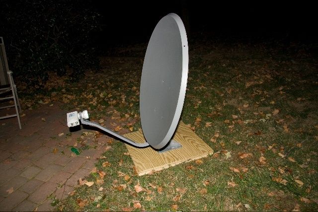

Using two elliptical 75cm wide dishes.

No they are not the starchoice antenna. Two separate dishes with each lnb having two outputs.

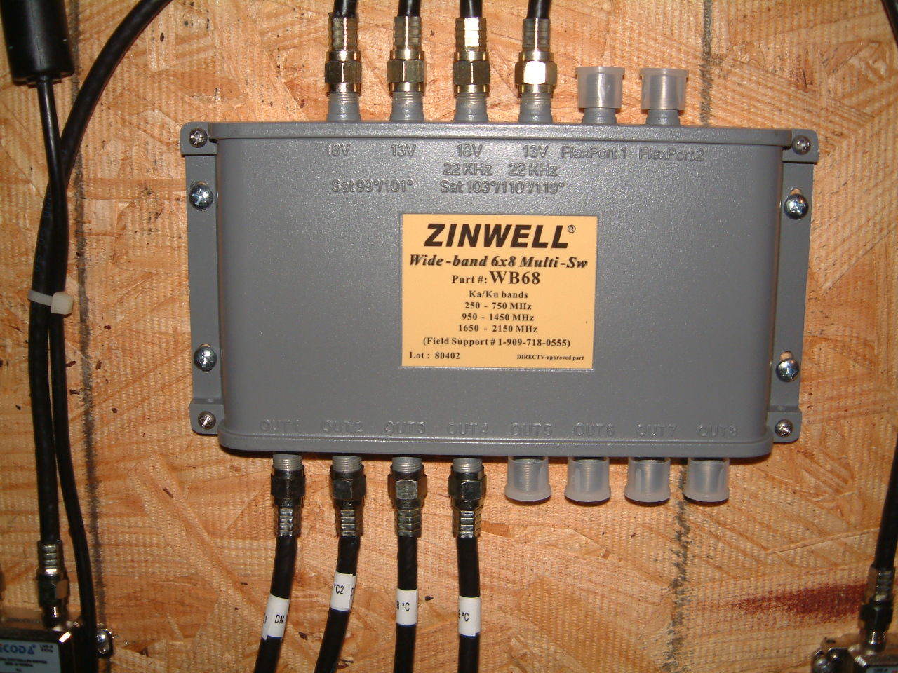

Wrong multiswitch - you need a 2X2, 2X4 or 2X8 etc 22kz multiswitch. You are using a 2X1 switch which combines signals from 2 satellites to 1 receiver.

The Starchoice 2x2 switch wont work as it is designed for a stacked system....LNB's you have are unstacked so as noted above a 4x4 switch is what you need
I bought the Zinwell WB68 switch and it works great for unstacked LNBs and it requires no power adapter. You can find them easy on ebay.
