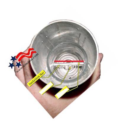

I just received my new DSM BSC621.
How do I set the skew on this LNBF?
It does not have the pointer like the pictures I have seen, it has degrees for the skew on the end by the ku connection. Is it still the same where 0 degrees should be at roughly 9:00 or should I open it and make sure the isolation bar is vertical at due south?
Of course there are no instructions with it.
On mine, the 1/4" metal rod is Horizontal, when at True South, and the "Connection Box" is on the Lower Left side when looking down at the Dish from behind the LNBF.
This page may help...
The DMS* BSC621
Thanks Lak, I am not getting vertical transponders so I know it is skew. I played with it a bit last night but couldn't get it. I will pull the cap and mark where the isolation bar sits.Thanks again for the advice!
