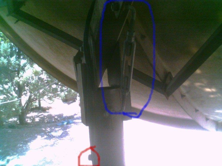

Check the mount (where the pole the dish is mounted on ) it should have at least four Bolts that clamp the dish to the pole and prevent it from swiviling. These may be loose enough that the wind swiveled the dish on the pole. mark the pole and the mount with a pencil or marker. Also check to see that the dish did not move up and down, there could be a turnbuckle or something like that allows for the azimuth adjustments see if it is loose.
I added two shots as examples... (hot out there) Red circles are the hold down bolts, blue are the azimuth adjustments
