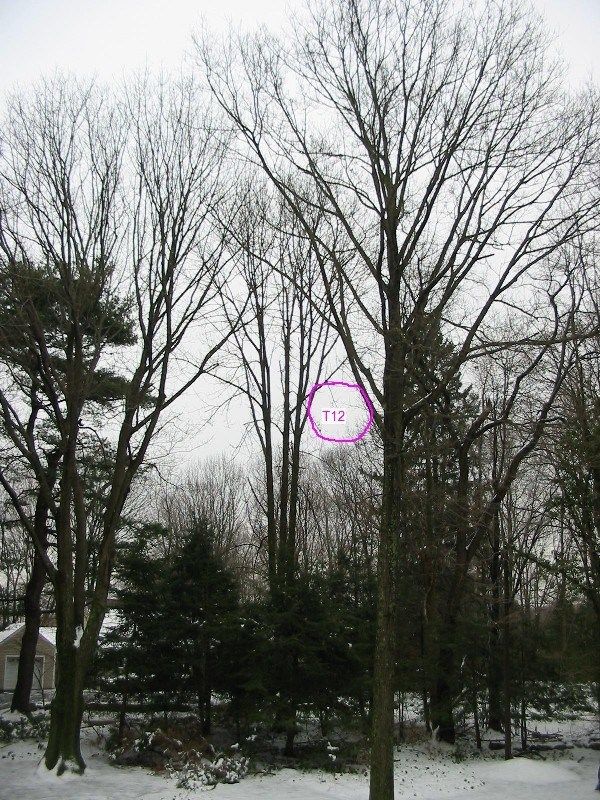

thanks - it works now
Thanks everyone for replying. It ended up beeing a tree problem.
I moved the dish around to an opening between the trees. The signal now
comes over the treeline in the distance and under some tall trees in my
property (elevation is just 14.5 degrees).
I was walking around for more than 30 min with a clinometer
to find a good spot. But it works and I get 80% quality with a 95cm dish,
which is amazing given the "tiny hole in the sky" that I was able to find.
Of course we'll see what happens when the leaves grow back in the spring,
but so far I am very very happy.
To close this thread, I took a picture of the results of my targeting exercise. It took quite a while with a compass and clinometer to find a spot where an antenna can be mounted. The elevation is only 14.5 degrees, however, the fairly clean signal path gives over 80% quality.
Image is attached.
