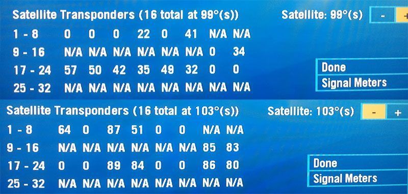

Last night I was looking at signal meters when telling you what I was getting on the 99 and 103. Since obviously that is an average, I figured it may be helpful to post screen shots of what the strength is for the individual transponders. Look at my attachment to see what you think and if this is why I am getting searching for satellite.

What's your signal on 99s and 103s?
See the attachment in my last post that shows the strength for all transponders.
Well crap, that means I was tweaking for the wrong 99 then I gues. Does the S stand for South I take it?

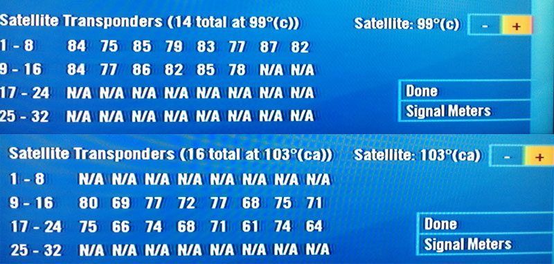

OK, new screen shot attached.
Take your dish completely off the mast and make sure the mast is completely level and plumb then peak in the 101 then slowly dither in on it. From there your 99's and 103's will come in. You're not picking up your spot beams my man. Hope that helps. I'll check back and see if you had any luck and give some help if you didn't

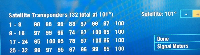

The bubble level in the top showed it dead on the money when I mounted it and this is what I have for the 101. Do you think I still need to pull it off the mast to check it or just tweak what I have. See below:
