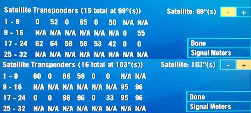

I just looked at the bubble level on top of the mast without pulling the dish off and it is dead on the money. So, the question is, how do I begin to tweak what I have?
So even though the 99 and 103 sats are getting a LITTLE strength, that doesn't mean there is hope to dial them in.
Your beat bet if you don't have a signal meter is to take a tv and receiver outside with you where you can see them. However, where they stand now they're not horrible but they won't pass any signal quality test. With it being a vacation home I'd leave it as is unless you just want to be dead on with your signals.

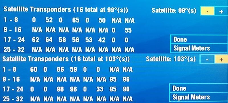

After working on it some more using the adjusters, this is what I have. Keep in mind I have no meter but I am wondering if this shows hope if I did have one.
I am still getting searching for satellite however on locals.
It's not that I necessarily want to be dead on, I just want the blasted locals to come on.
I couldn't find a spot beam map for Macon, but looking at the one for Atlanta, it seems you should be able to get your locals in Chatsworth. Jimbo was right on the transponder you need, 99s t6. You also have at least one channel on 99s t4. To backtrack a bit, I wouldn't trust the bubble in the mast. Can you get a post level from Home Depot or Lowes? They are more accurate. Then keep playing with the fine adjustments, or dithering. I think you can get the locals if you are persistent and patient! Good luck and don't give up!

Chip,
If his local are on 99s t4, like we've mentioned, I thought he said he had about mid 70's on that before ... Mid 70's should give him his locals ... however, it looks like it's only about 50 now, so, maybe tweaking will help, I was thinking he was higher before.

Chip,
Fwiw, I usually use a torpedo level.
The 70s was the numbers from the CONUS satellite. I like the post level because it doesn't move.
