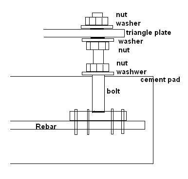

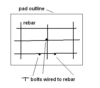

For that matter, pour a circular cement base 4 to 6 inches thick with studs protruding*see attached* to level the pole. To move it, just remove the dish, tip it up, and roll it away. 4 ft diameter should suffice.

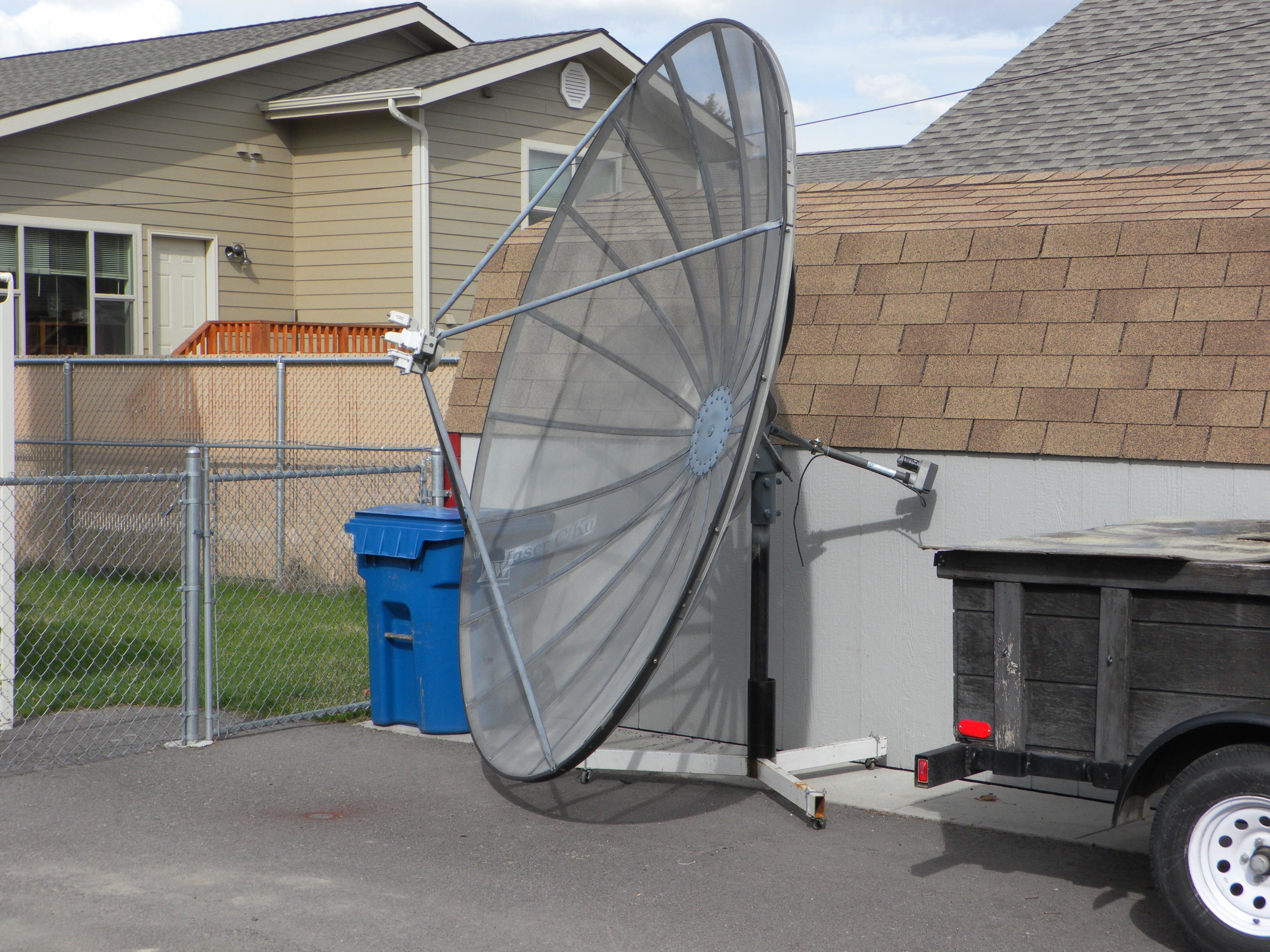

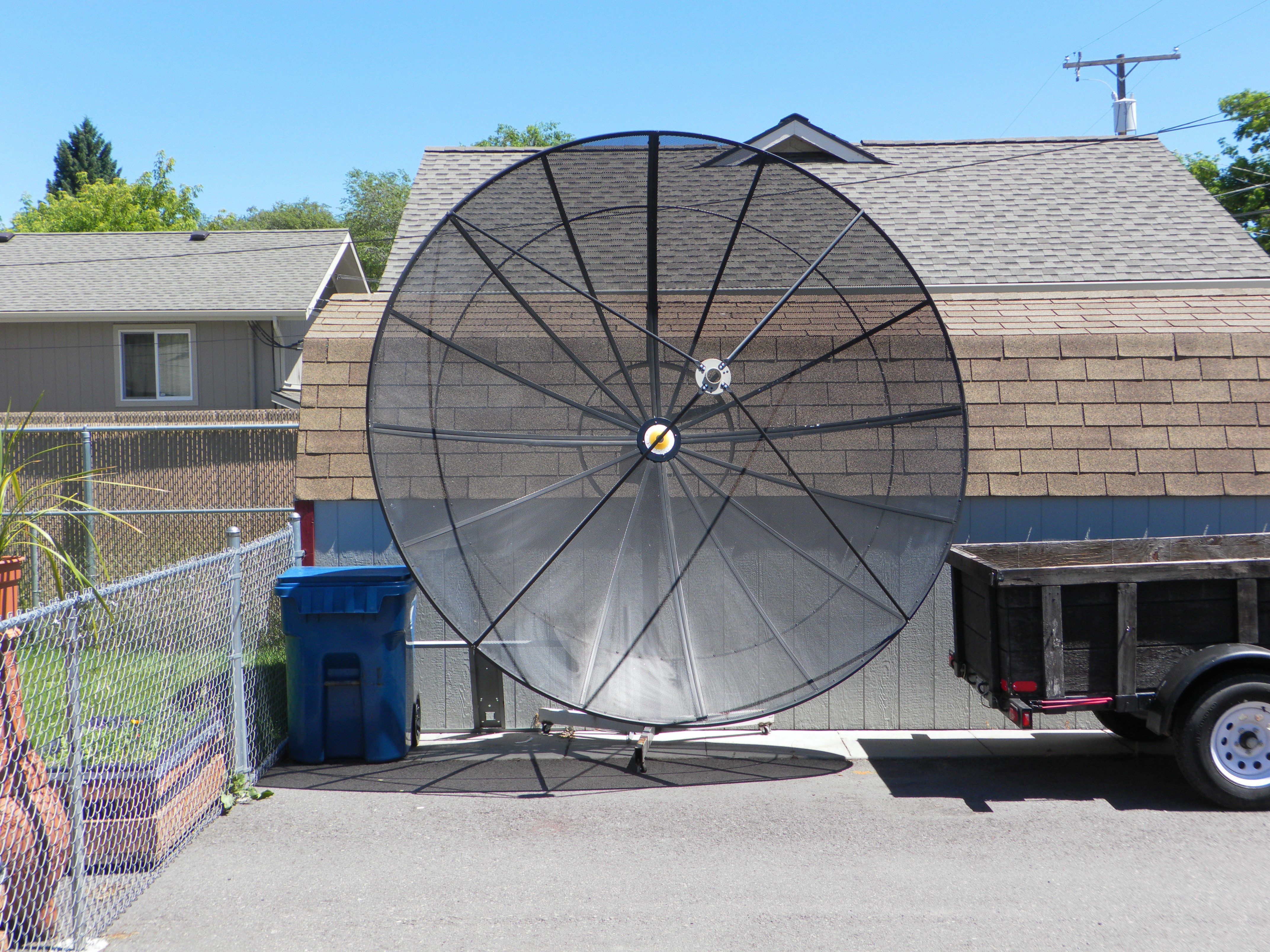

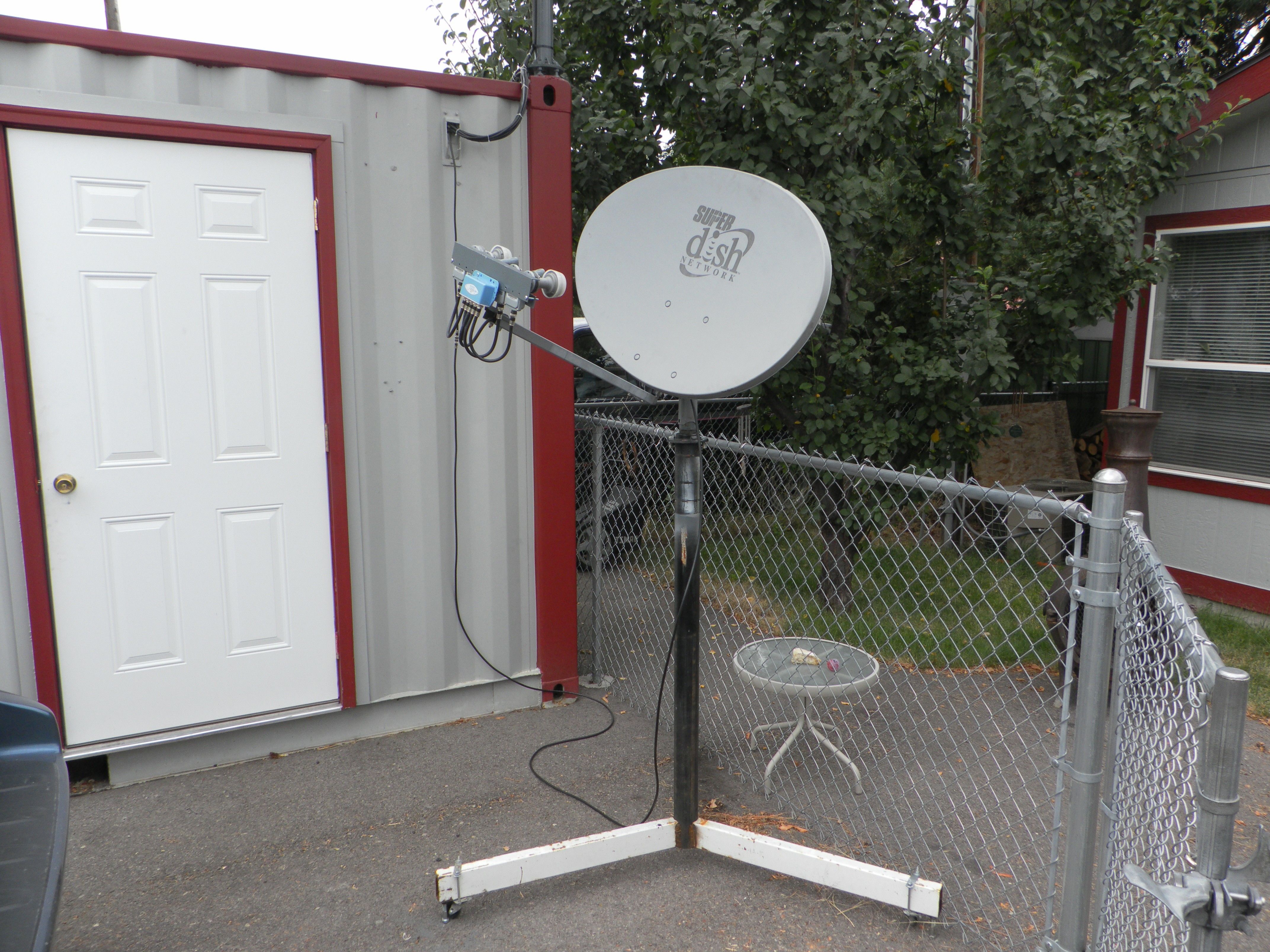

Attached is details of my 'floating slab' mounted BUD

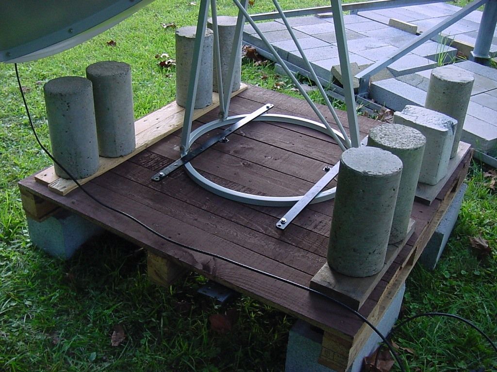

What's been successful for some, is a regular wooden pallet.
Mount the (short) pole to one corner, with bracing to the two nearby corners.
Then you hang the dish so the corner furthest from the pole points to your TS.
Look at pictures of non penetrating roof mounts (NPRM) for inspiration.
I have recently seen very strong molded plastic pallets.
Whatever you use, you'll want some cement blocks on top for stability.
I hope you don't have any wind, because anything over 10 mph is going to take that dish down and make you wish you never bothered.
I used a heavy wood pallet reinforced with steel for a 6' Fortec dish with a ring mount. Compare to the NPRM on the ground pictured next to it at the time.
