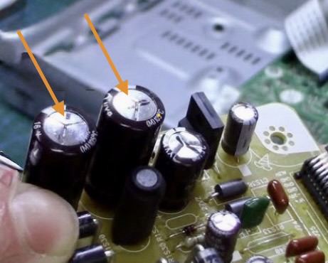

I feel that they have a service dept. that can replace bad caps. I used to do it myself on the Toshiba 80 & 100.
But these aren't going down from caps, but rather hard-drive fails?
If it's crashing and rebooting, it's usually the caps. Pull the cover and see if any are bulging.
I forget if I posted a picture of the failed capacitor from my ViP 211 that went 8-bit on us ten years ago. It's documented in this thread. Since the ViP 722 dates to the same time period, I would not be surprised if it had a bad electrolytic capacitor.
Oh, I guess I didn't take a picture of the 211's insides. But I see I did document the procedure to migrate the 211's EHD to a different EHD. As far as what you're looking for, it would be something like this:
The electrolytic capacitors should have a flat surface with no leakage or bulging evident. These are used to smooth out the electrical power going into the receiver's electronic circuits. If too much noise is present, it can cause the receiver to fail, or it could interfere with some parts of the receiver from operating properly. In my case on the 211, it caused the Encryption decoding to not be processed properly, causing video stuttering, followed by a spontaneous Reset.
