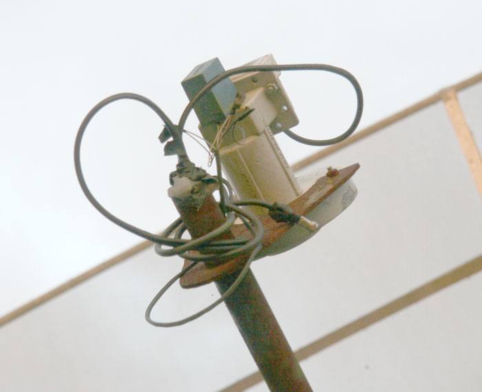

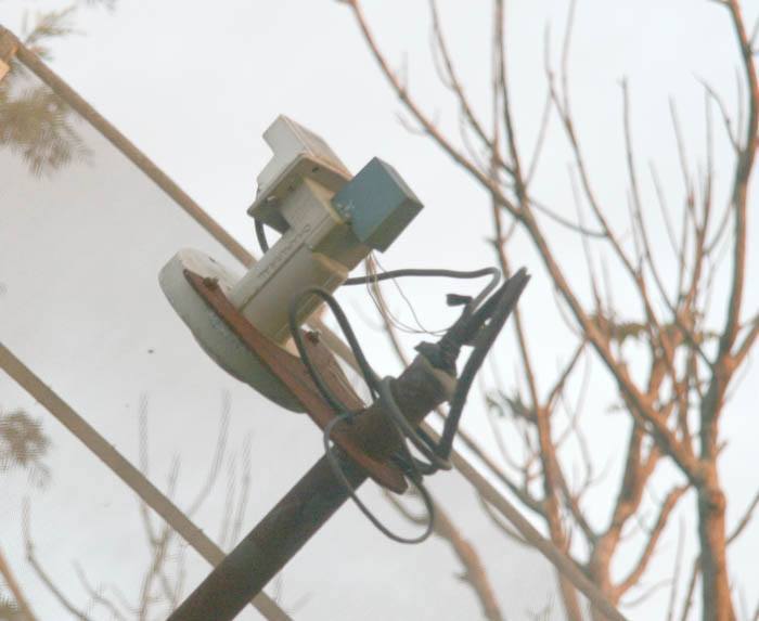

I checked the photo and indeed it does look an identical construction. Mine has a Precision PMJ-LNB C installed do you know what was on his ?
Thanks
Tony
I found them
Here's what his dish had on it
and
What next ?

I believe you have a servo-controlled polarity switching on your feed?
You can use your analog receiver to move the dish and switch polarity, and hook your Coolsat to the LNB output to do your tuning.
I wouldn't worry about the satellite lists yet, just use the east/west controls on the analog to point the dish, and have your CS set for a hot tp on whatever sat you are trying to hit.

If you combine a motor controller with the Coolsat 6000, it can move the dish to the desired bird, when you select it with the receiver.
But, since you have a servo on the feedhorn to select between H and V polarity, you'd want one of the two following solutions:
- voltage controlled LNBF like the C1 or C2 (C-band only)
- a Pansat 3500 or maybe 2700(?) FTA receiver, which has servo control
