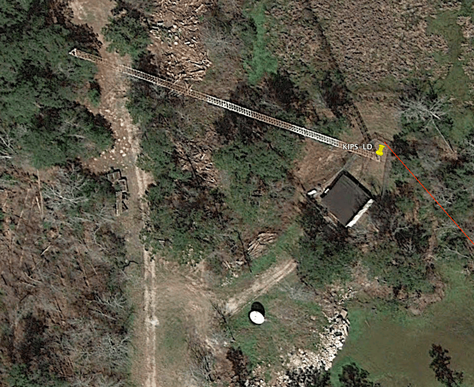

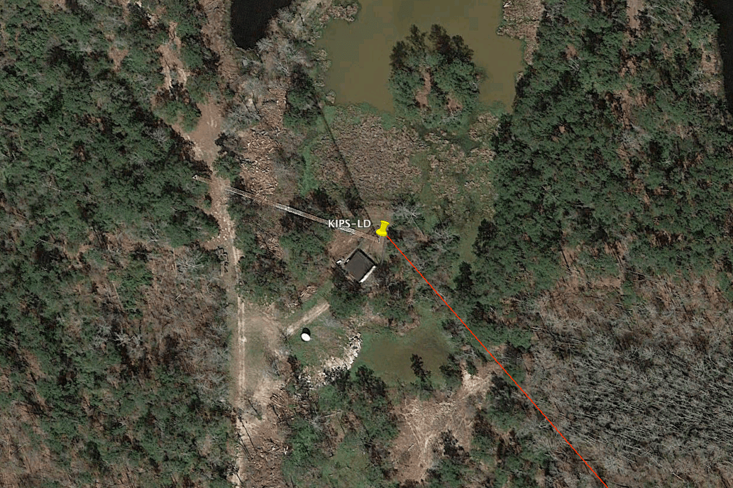

I also got all technical with google earth and I have visual verification of all the local TV towers and distant ones too. Lucky for me google earth photos in this area are very detailed and zoomed in.
I can see the LNB's on my dishes, I can count the smallest flower pots on my patio now. No more sun bathing on the patio! Google is watching !! :eek:
h--p://i.minus.com/ibrabUhpyNKQ27.png
If the tower is 120 meters up then there is no concern with things in the way, that's MUCH taller than any potential tree or building in this area and it's a straight shot from here, 15 miles. Just marsh land between the tower and my antenna, no hills, buildings or trees tall enough to obstruct THAT. My antenna is 21' up btw..
Oh and here's a screenshot of the tower locations from where I am and the heat map (is that the right term?) for KIPS. I'm in the blue which should be OK considering I can point directly at them and have a pre-amp.
h--p://i.minus.com/iZx8S72E5TN37.png

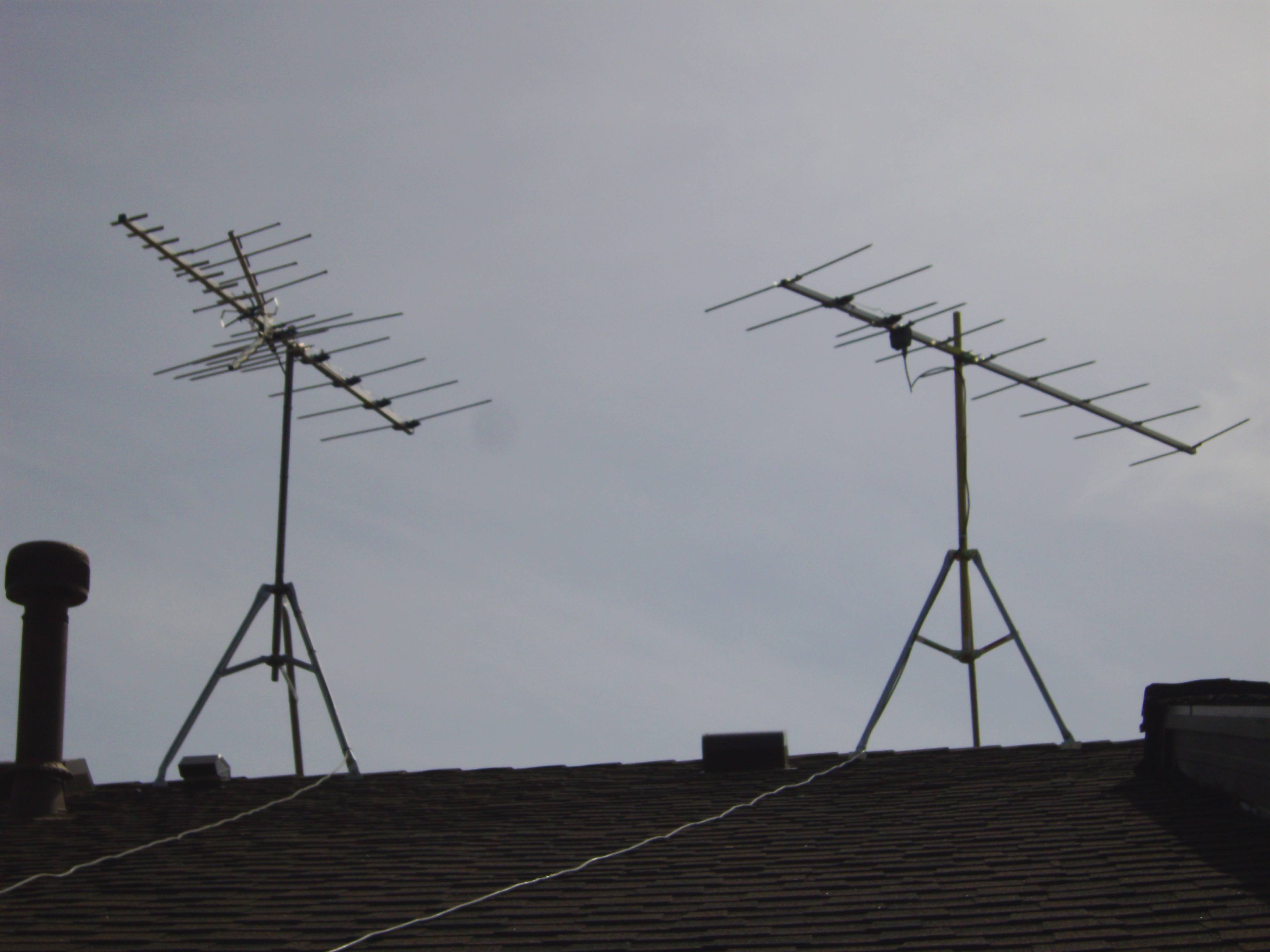

The antenna you have for VHF is a VHF Hi only (7-13) and wont work worth a crap (see you can type crap without the * here) on 2-6
Another option although further out is Houston has it on the NBC (RF channel 35 maps to 2-2) and looking at tvfool maps its kinda 6 or half dozen depending on which one you try and get (Lake Charles or Houston) although Lake Charles would be easier (IMO) as its on VHF (VHF transmits further)
Honestly you could upgrade your VHF antenna and have a better chance of getting Lake Charles. This is the one I use to have to get a VHF station 72 miles away (the one on the right)...under $40 at solidsignal.com
