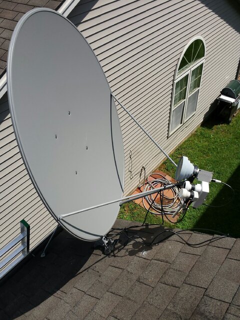

20140905_133309_resized.jpg As you can see in this latest pic of my C-Band dish, the good news is, I have a backup Invacom Ku LNB pointed at the 99.2W satellite on the 1.2M C-Band dish. The other backup Ku LNB to the left is for the 87W satellite. This was my latest experiments I was working on for the past month. I was trying to get a second C-Band satellite on the same dish, and while I got an excellent Ku signal on the 91W satellite as well as a few other ones, I couldn't get any signal from the C-Band LNB; no matter what transponder I tried. I messed with it in the hot humid heat for a good half day each weekend that was half decent out. The plastic C-Band bracket ended up breaking in half the other day, pretty much ending my experiments for 2 C-Band LNB's on one 1.2M dish. Depending where you live, you might be able to make it work for you however. Im not exactly sure why it didn't work for me on the 3-4 satellites I tried, unless the sun outage had something to do with it? Anyway, I gave up on the experiments, and just installed the two extra Ku LNB's at both satellites as back up's, in cases like the one I am having now with the motorized dish. :) The first half of my experiments worked, but the other half didnt work out. I don't think I could have picked up a defective C-Band LNB, but I still have it as a back up in case I need one later on.

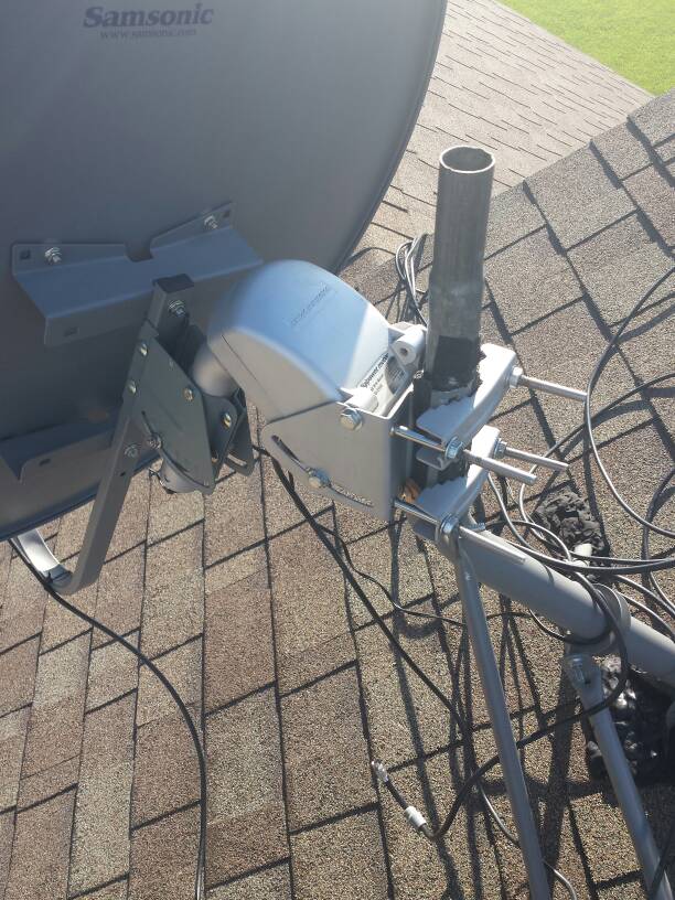

I crushed in the pole mount on my motorized dish when I first put it together. I wrenched everything down tight, but just recently the wind or something must have moved the whole dish assembly a few degrees around the oval shaped part of the pole mount. I will have to take the whole dish assembly off, reshape the pole mount correctly, bolt on a galvanized piece of pipe over the original pole mount, and realign the dish assembly on the stronger pole. That way I can line it up, bolt it down good on the galvanized pipe, and not have to worry about it turning itself around a few degrees later.
Yup I crushed a pole once ever so slightly. That was enough so that I was way off at both extremes of east and west travel. Took me a while to figure it out. I replaced the pole with a thicker walled pole and cured the problem.

A 1.2m dish would probably not provide enough gain to support an offset C-band LNBF unless the signal is a total scorcher.
Remember that the reflected satellite signal is mirror opposite. If the desired satellite is to the East, the LNBF is mounted on the West side. If the elevation is higher, the LNBF is mounted lower.

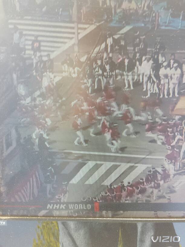

Finally have NHK World and RT tuned back in. I fixed the slightly crushed pole by squeezing it back into a round shape, and inserting a steel pipe into the pole mount for added strength. Everything still checked out perfect level, I put the dish back on and realigned it to Ku 85W. I spent the good part of the day to finally realize the 4 port switch went bad, which was the root of all my problems to begin with a few weeks ago. The switch would work for awhile, then go back out for awhile. When the dish tries to look at a new satellite when the switch goes out, everything got thrown out of whack and nothing matched up correctly. So it never was an alignment problem to begin with. At least a new 4 port Diseqc won't cost much. :-) Just have to reload all the channels from the right satellite.
