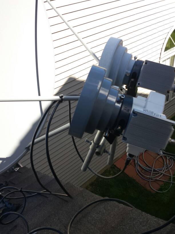

Update: My HEAVY DUTY WSD-2041 CHIETA DISEqC MULTI-SWITCH 4X1 arrived on September 20th or 21st, early enough for me to install it on my satellite farm along with some new cable. This switch has the lowest loss I have seen so far 1.5db, which makes a big difference between getting more channels or not in a blind scan or other search. I applied dielectric compound around all the connections and connectors where water could enter. The switch is working very well to this day and it automatically tells the receiver as to which satellite dish goes to a particular port. I noticed that it does this better than the cheaper switch did before. After I got the new switch installed and secured on my motorized dish, I considered experimenting again with my large 1.2M C-Band dish, but I didn't feel motivated enough with everything else I had to do around the house. I felt motivated enough for experimenting this past Friday, but I didn't get home until pretty late and the clouds moved in by that time; so maybe later on. Anyway, I am enjoying NHK World once again and continuing on with my secret crush with Catherine with NHK World News. :-) ?
Me too! :-) I'm currently working working on my C-Band experiment today as I have mostly clear skies. It's not going well unfortunately. I had the 87W Ku signal locked in so I knew where that signal is. I swapped out the Ku LNB for the Titanium LNB and entered in every TP I could find off the net. The best I can do on one TP is 10% Signal Quality no matter what I try to tweak it. I think the dish support bar is blocking the signal as it runs almost in front of the LNB, and there may not be quite enough dish left to bring in the signal all too well. I was trying to get 87W C-Band because that's the next satellite I could locate while having enough space for 2 C-Band LNB'S on one dish. It's not looking like it's going to work for me, as I'm not going to move the whole dish for that. Looks like I will go back to putting back on the 87W Ku LNB and using it as a backup, in case something happens to the motorized dish this winter. You don't know if something will work until you try it out. My wife will be very happy once I stop tweaking with stuff up on the roof. :-)
