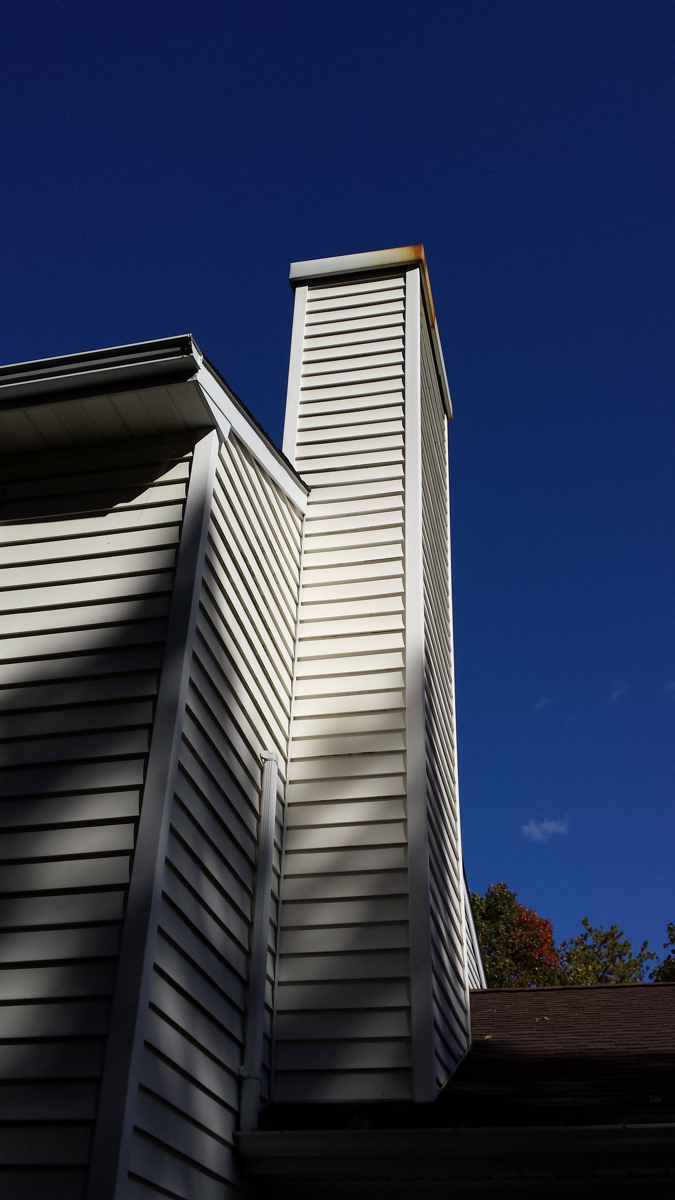

I am thinking of switching to Directv from Cablevision (better price, channels, etc. etc.). I live in a community with a HOA that has specific rules on mounting a dish. I'm being told that the dish must be mounted on the chimney and not on the roof and must be on the back of the house.
I'm fine with that, but the chimney is surrounded by vinyl siding and I don't want anyone to be drilling into the chimney. Also, a pole mount is not an option per the HOA.
Are there alternatives that don't involve drilling into the roof (which I'm being told will void the warranty for the roof). Also, what is considered a "standard installation" by Directv? Do they even perform any other types of installations?
I took a photo of the back of the house so you can see the chimney. Any advice anyone could give would be much appreciated!

If it is a single family home that you own then in general the HOA can't stop you putting a dish wherever you want to, on the roof, on a pole mount (if it is your yard and not common area), it's an FCC regulation. Google "OTARD" if you want the details.. And usually DireCTv won't mount the dish to the chimney
That chimney box would be made out of 2x4 framing, so if they did mount the dish to it, it would be lagged into the wood framing. The question is, can they get good line of sight at that location.

You aren't going to find anyone that will mount the dish to vinyl. You would have to have some vinyl removed and a block installed to mount the dish to. That's not a standard installation obviously.

The vinyl is only a covering attached to either OSB or Plywood. Usually it will be OSB attached to the 2x4 framing. It is fine to attach to the Chimney with straps, but better to attach with lags to the 2x4 framing. It is better then placing the dish on the roof, with the mount just having a couple of lags screwed through plywood, with nothing below that plywood holding those lags.

Even if there is plywood behind the vinyl, it will have to be removed. No installer will attach a dish to vinyl.
Here in Texas they do not install on chimneys. The wind load from the slimline dish is too high. And roof mounts are fine, you must NOT just screw through the plywood. The lag bolts must go through the roof rafters.

Bingo! The sheeting isn't enough for anything let alone a slimline dish. It's one of the largest dishes you can have on a home. Chimney mounts are a no go coast to coast now with Directv. You can possibly get a tech to do one but don't expect it. I finally ran out of the anchors and won't buy more. They're solid but won't pass a QC so there's no longer a reason to install it

What? That's the number 1 no no in the book! In no way is a dish to be mounted to vinyl siding. That is a huge damage to the siding. The amount of pressure the lag bolts have when they grab into a stud snaps vinyl like a rag doll

The only way it's getting mounted to the chimney is by an installer that is a fly by night contractor that don't care. Directv rolls out on a service call, it's getting removed and if you don't have another location it can be installed its sad but you'd be stuck in your contract.

If an approved DirecTv installer comes to do this, the dish will go either on the roof or on a pole mount. Period. No vinyl, no chimney.
If the owner (landlord) owns the yard, then he can use a pole mount and the HOA can't object. If the owner owns the roof, he can use a roof mount.
