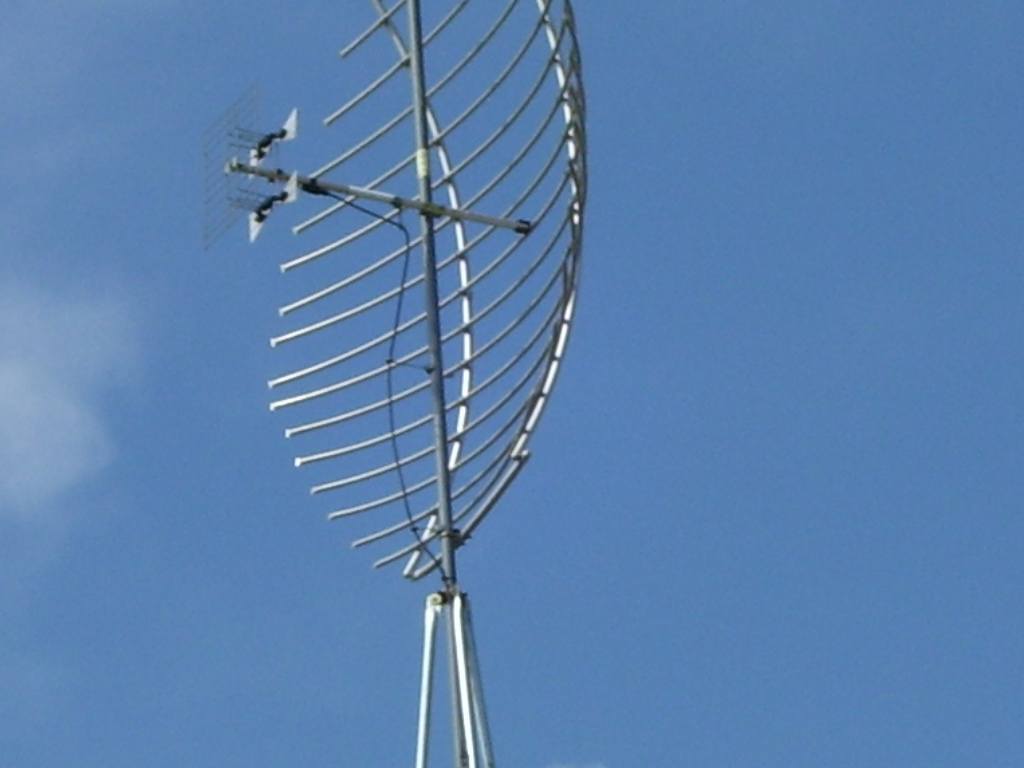

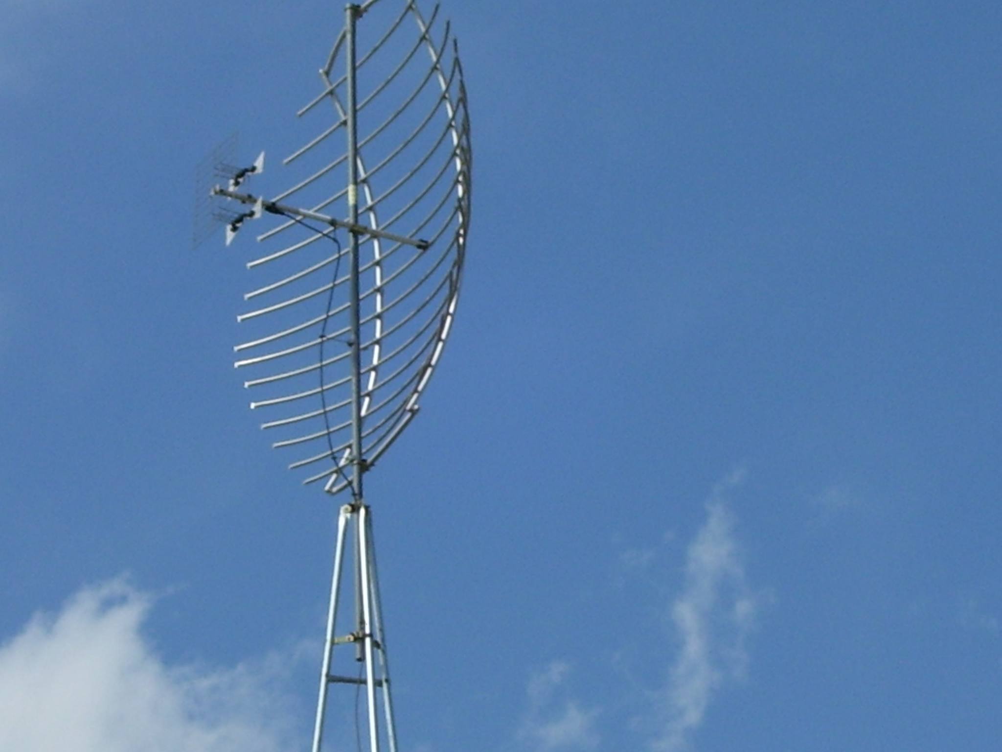

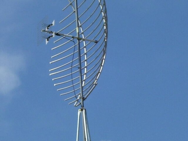

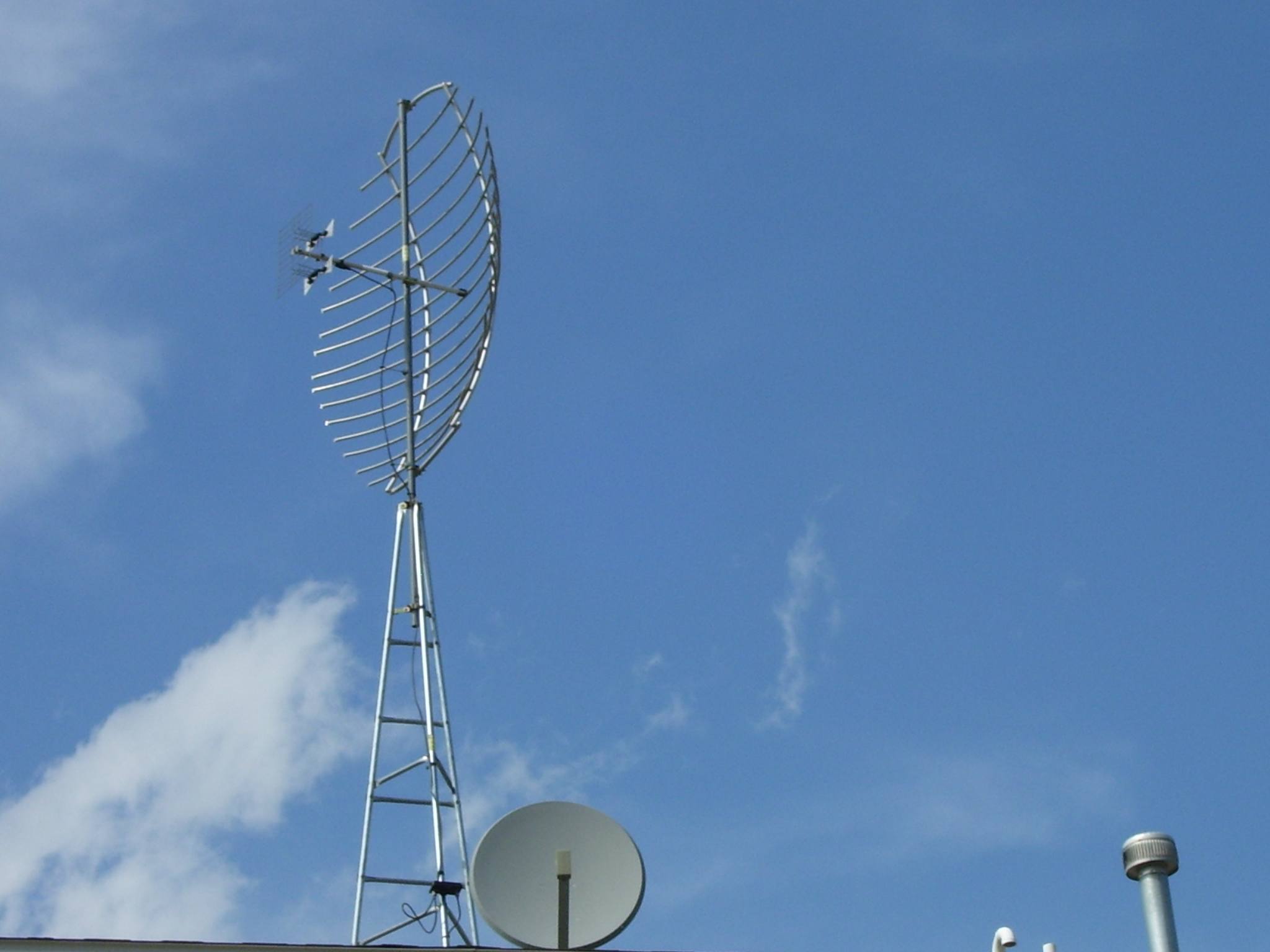

Hey Ice !
How are ya??
Nice pics. I see it has twin "bow ties"
I am picking the 7 footer tomorrow, so i have to re-think the 91 xg.
Later....
thanks. Basically I pulled into the parking lot, leaned out the window of the truck and took the pics :)
in and out in 30 seconds :D
There was another building that had one on it too. What was interesting is that other complex has only been up for a year or so....so they somehow were able to get one of those antennas.
By the way...the Mankato market only has one TV station, KEYC 12 CBS, so that is why they have to resort to using these antennas to aim at a translator cluster about 30 miles away. The translator cluster is owned by a electrical co-op and they pipe in all the Minneapolis stations. KEYC added Fox to a subchannel a couple years ago so now non-cable/satellite folks have 2 networks now :)
