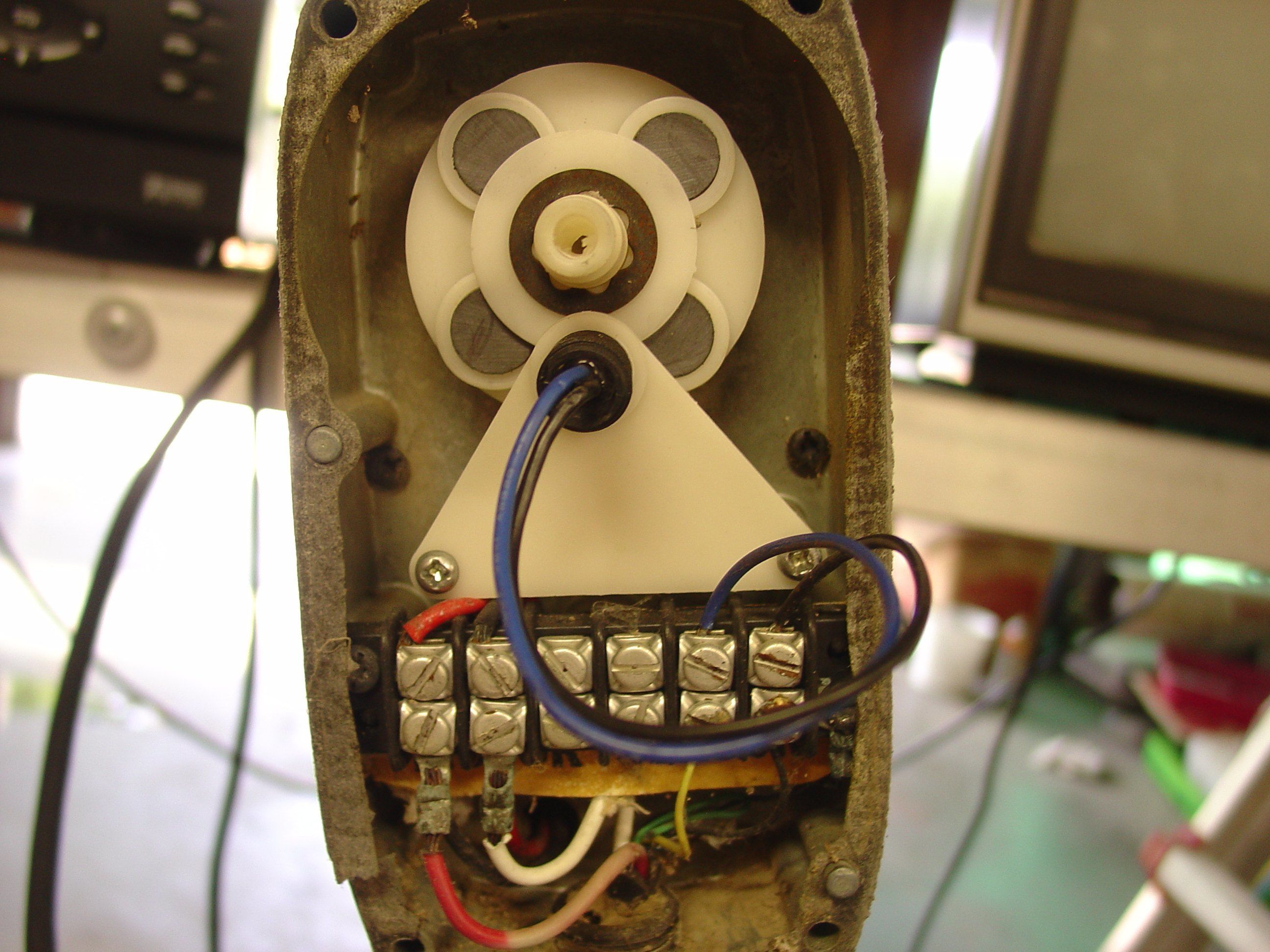

The actuator from the dish I just picked up on Friday works to an extent. I hooked it up for testing to my old DSR920 that I no longer use. I can extend or retrack the actuator but only short bursts at a time. It sounds OK when running. I can't get any numbers to change in the 920 when I try to move it. Makes me think there is a problem with the counting device. It will move a short distance and stop with the message I hit a limit. Press "Go Back" and I can move it again a short distance. Have moved it almost all the way "out" but still can not get any count to change.
So what is bad with this unit?

Looks like there are magnets in there so the reed switch would be the prime suspect. Of course there is the usual re-check the pulse wiring, and that there is approx 5v. from the receiver on that circuit.
Bad sensor or wiring to sensor is the problem. Can you check it with an ohm meter?
Checked. It is "on the bench" so the wire is about three feet long. Both wires and ground check out.

First make a drawing of the current wiring for it can be put back after you test the sensor. If you disconnect the blue and black wires from the sensor (the black tube above the magnet wheel) that go to the terminal block for there are no connections to the sensor, then hook an ohm meter to these two wires going to the sensor, when the motor turns and the magnet passes below the sensor, you should see the meter (if analog meter) needle briefly jump. If a digital meter, should read infinity or open, then a brief flash of a reading as the magnet moves by. Also, if you remove the sensor and move a magnet around it, you should get the meter to go from open to short. That is the reed sensor is open then the magnet is pullling the reeds inside the sensor together for the two wires are shorted together. (zero ohms)
The sensor needs to be close enough to the magnets for the reed switch closes as the magnets pass by, buy far enough away for it does not scrape as the wheel turns.
Tried that with an analog meter. Instead of a jump of the meter, I received various ohm readings. Never really got an "on/off" reading. Looks like reed is not working correctly.

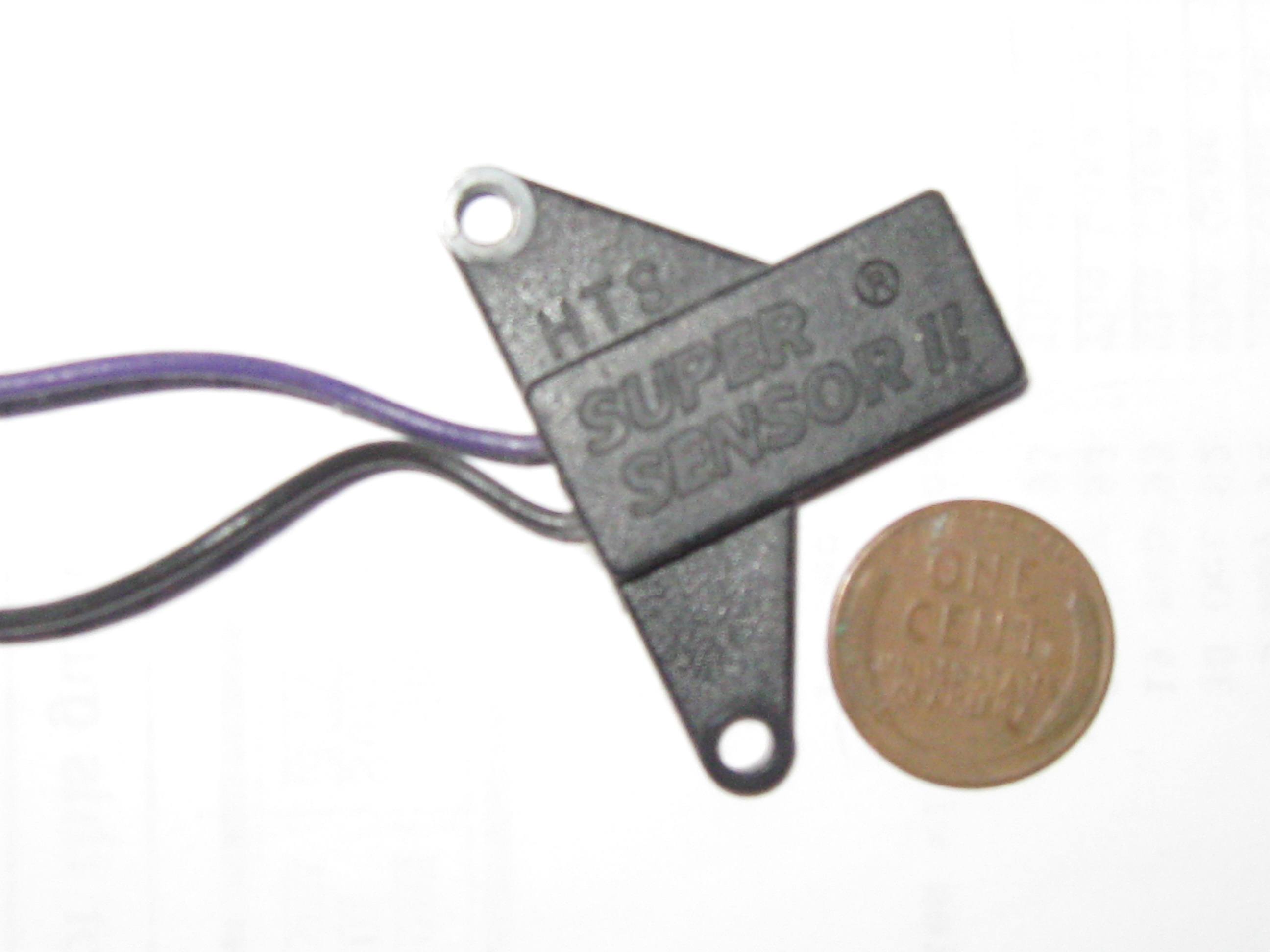

Still looking for the thing, RT, if I didn't want it now, it'd be in the floor under my feet lol. At least it is a brand new one, when I discover it again.
I don't have it after all!
After much searching, I finally found this thing, but it isn't even close to what I thought I had. Here's the picture, its an "HTS Supersensor" but don't see a way it'd work for you. Sorry, I was full of @#! this time.
No problem. Thanks for looking.
