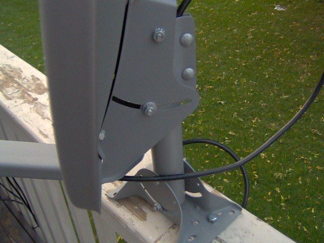

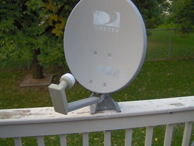

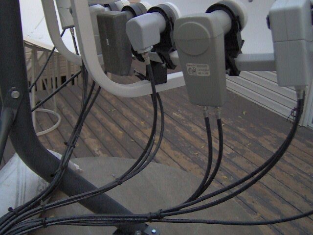

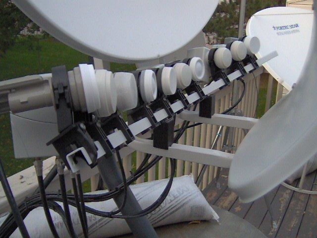

INstalled a dish for 119. Since the T90 gave me blech results being almost 30 degrees off centre, I put up a small 18" dish for 119. I thought I could put it in front of the T90 on the table, but that didn't work.
I made a stubby mast by sawing right below the elbow on the mast. Put it at 90 degrees and slapped the dish on...boom 100+ on all TP's :)

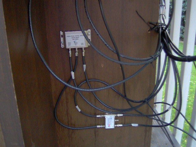

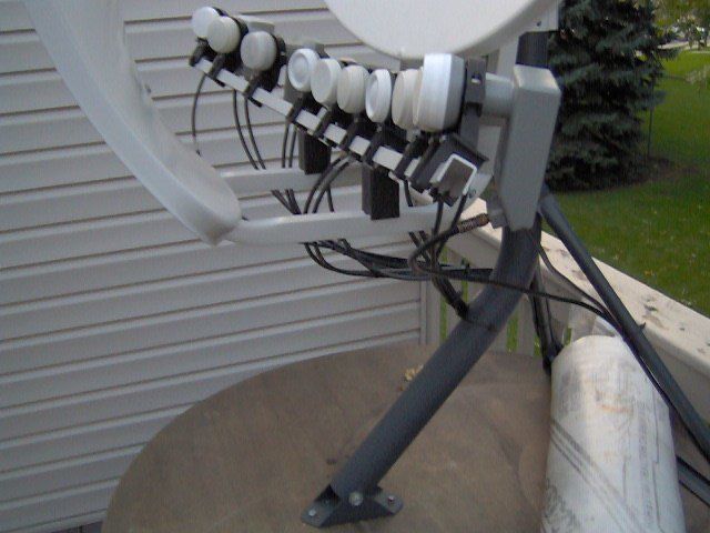

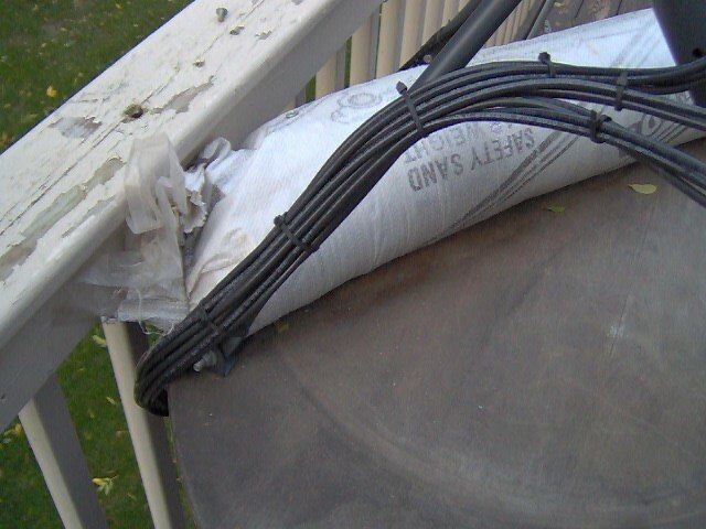

Aso ran 13 :eek: cables from LNB's to 2 different setups

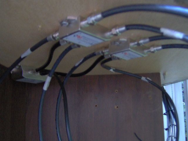

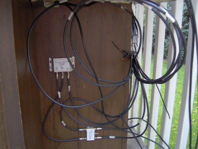

-2 4x1 diseqc switches for 72, 74, 79, 85, 89, 93, 97, 103. Those 2 outputs into a 22k switch
-second setup has LNB's from 74, 79, 89, 93, 103 into a 4x1 diseqc (2 lines go to a 22k switch then to the switch)
Also cleaned up the cabling and mounted the switches underneath the table (for rain protection).
Once I get my Diseqc switches from PSB (the ones that have all connections on same side, that will make it MUCH easier :)
