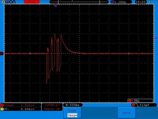

You don't need any special adapters to connect the scope to the coax. Turn on the PCI Card's 22KHz tone and DiSEqC 1.0 - A. Set the scope to 200mV div /500ms and you should see something like this from a unit with a low 22KHz amplitude:

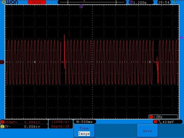

Here is a capture with the same scope setting but from a STB with higher 22KHz levels:
We have succeeded in improving the DiSEqC signals, but the issue of the ASC1 becoming unresponsive to movement commands after awhile is a stopper. When this happens the East and West buttons stop functioning also. It is like something gets hot and quits. After a cool down it functions for awhile again.
