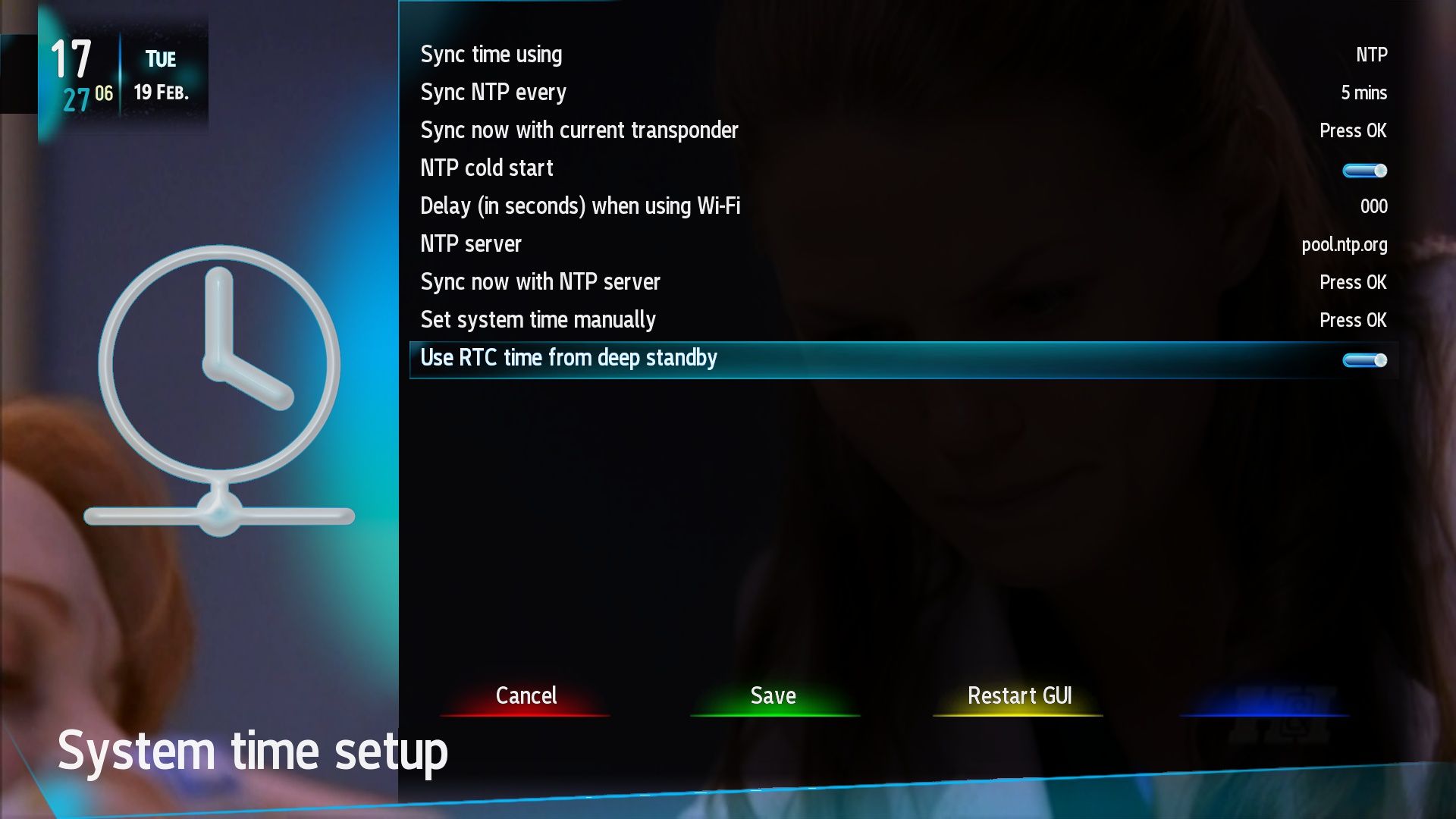

Is your Mio wired, or wireless, I can't remember? The only time mine goes way off, is IF I switch back and forth between slots, then it still occasionally jumps to like the year 2069. Mine is wired, BTW, and I'm still running the original TNAP. Settings like this: MIO_SystemTime_Settings_20190219172706.jpg
Wired. My time settings are the same as yours except I changed my NTP server to us.pool.ntp.org
I've seen my front screen clock sometimes drift off by a minute or two, not sure why, but it corrects itself. It hasn't done that for some time now, so not sure what was going on there. Maybe something with my Spectrum internet? Who knows.
As long as it doesn't do that year 2069 crap anymore, I don't think about it too hard, lol.
I was having a two minute clock error at times. I changed my internet time to: time.windows.com and haven't had any more problems.
