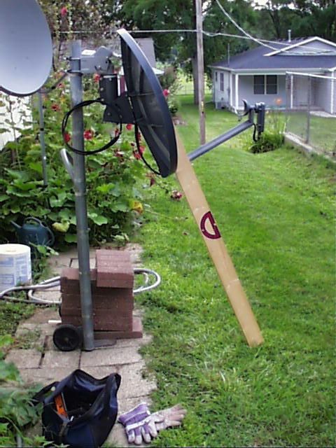

You can make a dish protractor to place across the face of the dish with a little plumb bob. It takes into account for mast motor dish variations. Set your dish face to your calculated dish elevation from www.sigsat.com and take your dish offset into account maybe 24 degrees offset like my winegard 76 cm.
Check your plumb and level five times it's that important.
