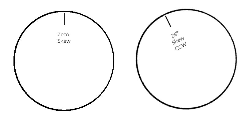

Well,I got the dish stationary and Iam on 87w again,and cant beam in on another satellite.I am back where I was no where.Also the skew is supposed to be 26occ.How many marks on LNB do I move it to attain 26occ.Thanks
That is really dependent on the manufacture of the LNBF. The ones I am familiar with are about 3 marks for every 15°.
So I would say four or five.
If in front of the dish yes go about 25deg CCW from 0. Drop dish elevation about 3.5° and come over to the west.
Here is an example of what 0° and 26° CCW skew look like. As Brian said, this is when you are in front of the dish.
LNB Skew 26CCW.jpg Click on the image to make it full size. :)
