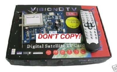

I found that thread, but the pic you posted of Twinhan VisionPlus 1020a is different from the above card pic, sold currently at Amazon, or formely sold at Sadoun. Can someone post an official Spec for it? Anyone knows the difference btw Red and Green PCB versions of this card? Which company made each of these versions, and which one has clear DSS support activated in its driver (I assume, both support it in hardware)? It looks like the green PCB card was designed and produced for Twinhan or another CN customer by Telstar TW as an OEM product.
